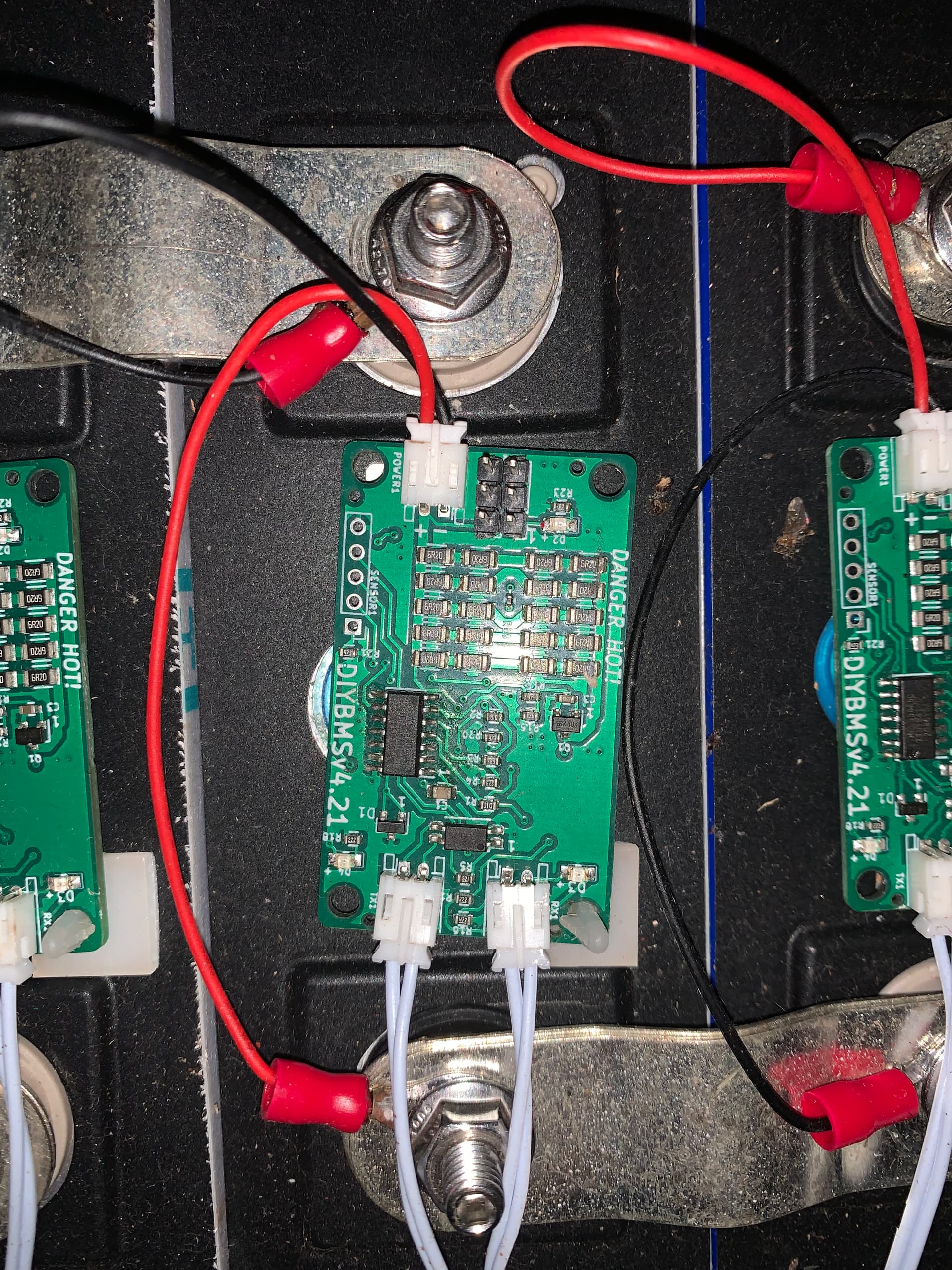

My battery pack is a 8s2p (Lishen LiFePO4 202Ah). Cell voltages change rapidly when drawing high amounts of currents.
But after switching off the load, voltages get back to normal.
I have 4.21 cell modules (16 pcs) and esp32 controller board (early version with two sets of TX RX).
Any Idea how to fix this?
How are the modules connected to the cells?
Do you have a multimeter? What does that report when discharging?
Are you powering an inverter from this? What brand/model?
Hi Stuart,
Thank you for the reply,
Modules connected to cells with copper lugs. Wires are soldered to the lugs. Other ends of the wires connected to JST connector.
Tested with multimeter and on a load nearly 75A, voltages of all the cells drop to a certain level but stay stable at that level.
And yes I have a EASun iSolar SMV III 3KW model hybrid inverter on this battery pack.
Controller board is powered by the battery pack through a DC step down power supply.
How long are the cables between the cells and the modules.
Do any modules “share” a cable ?
Cables are nearly 12cm long and no, none of the cables are shared between modules.
Each module got a pair of wires soldered to separate lugs and lugs are connected to each cell with studs.
That sounds great.
Do you have a close up photo of one of the modules please?

Hi, sorry for the delay!
Thanks for the photos - I ask because I’ve seen boards with a missing “D1” component - the board works fine, but the voltage readings are all over the place.
I think as @Albert mentions a sampling average of the voltage would smooth the bumps and lumps of the voltage - this is bouncing around when the inverter is pulling energy from the cells.
The downside of this, is the increased duration of voltage readings would make the data transfer through the modules slower - not ideal.

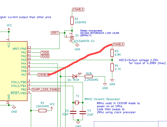

Over the last few weeks I’ve been looking at the module circuits and the code - but for now lets focus on 4.4 as that is what i have.
I’m on the road without tools and my notes so sorry this will be terse - sorry and without testing which is what i wanted to do first - but with this topic hot i thought it was best to ask if i have the bull by the horns…
But to me (with my very little experience) I find it surprising that you can get an accurate cell voltage reading when the voltage you are reading is not from the cell rather it is the output of a pin of at the attiny841.
While the pin will reflect the raw voltage it is much more likely to be affected by incoming serial data and other electrical noise.
That is the voltage that you are reading as the cell voltage is what comes out of the PA7 pin, then voltage divided by R3/R4 then read on PA3.
And reviewing the code confirms you are using the PA3 pin as your raw voltage reading.
Looking at the purpose of PA7 (enable) it appears you are trying to reduce the standby current of the modules by turning on and off the reference voltage D1 but you are also turning on and off the quasi raw Vcc cell voltage.
Could it be you meant the top of R3 to actually be connected to Vcc where it gets a real raw reading and not switched by PA7 (enable) ?
If this is the case then it is a simple mod on existing bard to cut the trace and bridge R3 to Vcc.
Furthermore if we look at the atmel datasheet the output of pin isn’t true Vcc but typically slightly under.
thoughts ?
Mick
Another possibility - is (part of) the problem noise on Aref by virtue of the un-bypassed zener diode D1? I appreciate that bypassing it will necessitate a delay in reading the voltage while it stabilises, and it will cost a little in energy as the charge on the capacitor is largely wasted.

The output of the pin is actually quite stable, there isn’t any serial data comms going on when we take voltage readings (given the way the packets of data flow between modules) and the ATTINY is put into deep sleep to reduce noise when the sampling occurs.
If you connect the R3 to the VCC rail, it will be always “on” and using a small amount of current through the voltage divider resistors - obviously these modules need to be as frugal with energy as possible, hence the switching of the input voltage.
From what I see, the voltage is stable on the scope, and the different between true voltage and the pin output is calibrated for in software (to also cater for the voltage divider resistor tolerance)
