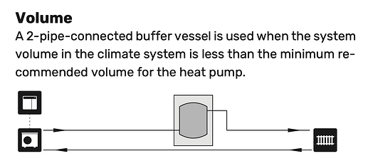

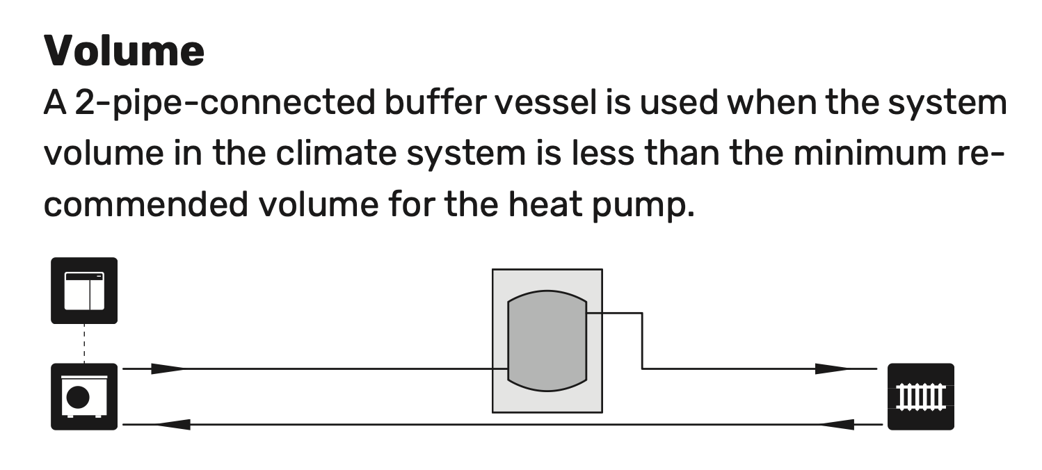

In terms of the optimal placement of a Volumiser, this article makes a compelling case for putting it on the Flow side instead of the Return:
While it’s natural to think of a Volumiser as providing a source of warm water for use during defrost cycles, it’s better to treat it as a sink for cold water coming from the heat pump during a defrost cycle - helping to stop the emitters from cooling down so much.
This approach is supported by guidance from trustworthy manufacturers - for example this is an extract from a NIBE installation manual, with the Volumiser clearly on the Flow side:

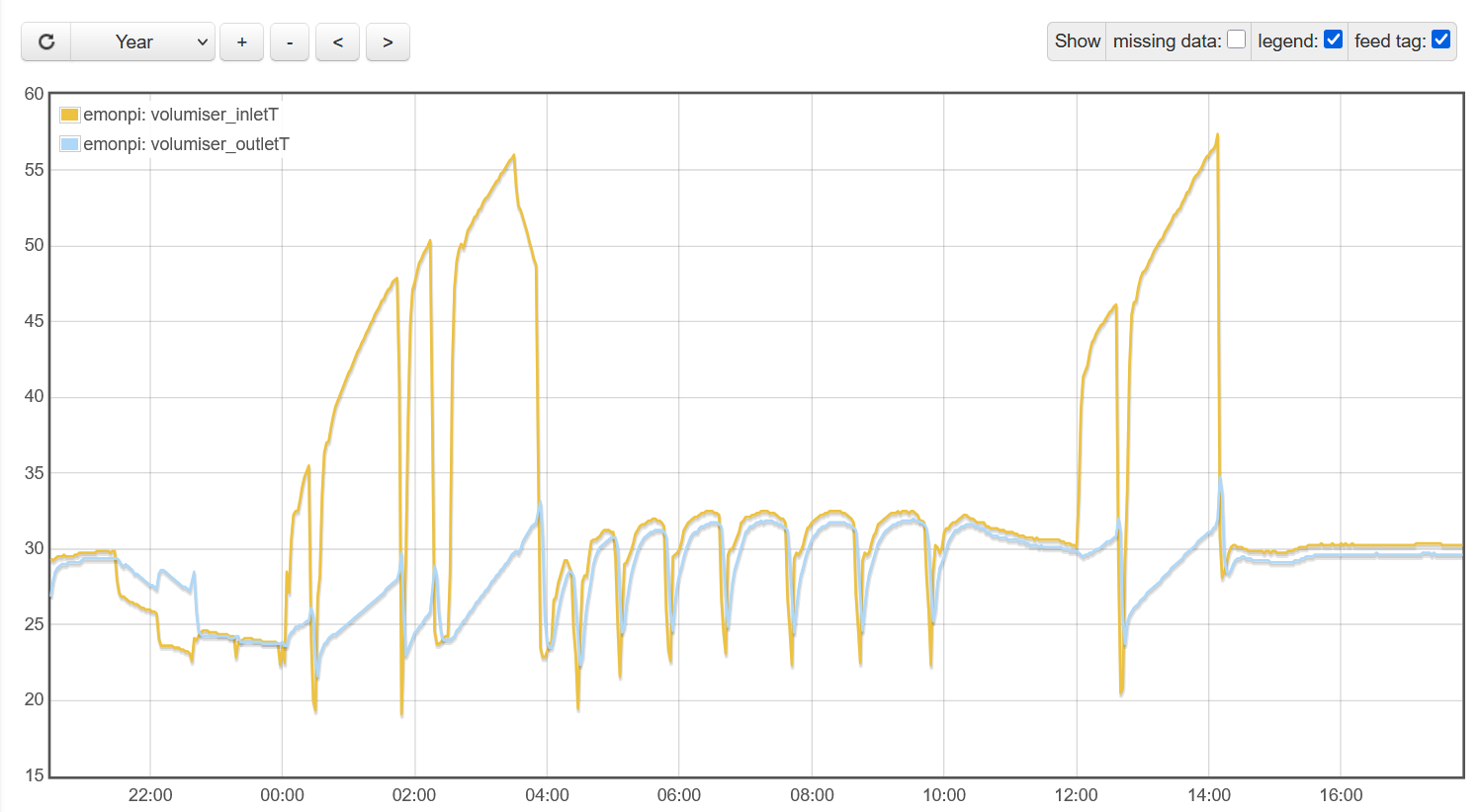

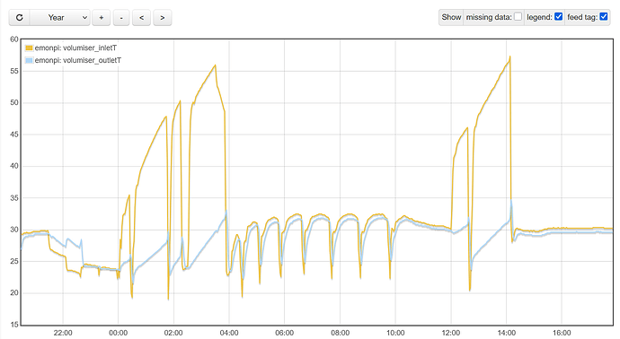

below is a screenshot from earlier in the year showing the volumiser inlet and outlet temps when the external temperature was below freezing. the high inlet temps are during hot water runs between 00:00 and 04:00 and 12:00 and 14:00. the remainder of the time the system was running on heating. i suspect the flow temperatures are high during the hot water periods because the 3-port valve heating outlet is within 450mm of the volumiser inlet so this is likely temperature creep along the pipework which is picked up by the sensor close to the valve outlet but there could also have been a little leakage through the valve. we had an issue with this when the 3-port valve was on heating with low temp heating water being forced through the hot water coil cooling down the cylinder. this has now been fixed by replacing the 3-port valve.
the screenshot also shows some defrost cycles. there is a small difference in reading between flow and return sensors when nothing is running and there are also losses across the volumiser which account for less than 1 degC however the trough temperature at the outlet is higher than the inlet by more than 1 degC. my inference is that the volumiser appears to take out some of the defrost drop. also evident is the flow to heating straight after a hot water run. there is a slight increase in outlet temp however no where near what it would have been if there werent a volumiser in the way.
this will be dependent on your system, number and frequency of defrost cycles etc but it seems to work fe me.
