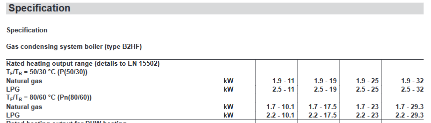

With a gas boiler a modulation range of 10:1 is common and best boilers giving nearly 30:1 modulation. Some of the Daikin heatpump seem to be little better the 2:1 modulation, that leaves practically nothing to cover errors in estimating heatlose or requirements of different occupiers.

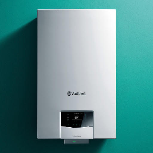

Something like this?
ā€œ * Output Central Heating: Nominal heat output range at 50/30˚C (Condensing mode)- 2.8-10.6kWā€
That’s not all that much different from my 8kW Daikin which I have recorded at mean outputs of 8.7kW over 30 mins (15C ambient) and 2.7kW over 2hrs (7C ambient).
Which boilers with comparable nominal outputs to heat pumps have modulation ranges as large as you suggest?
The issue is the smaller Diakin have the same minimal outout, likewise the 9kw have the same minimal output then 16kw. The 8kw likely have the largest modulation range.
The Vitodens 200-W have 1:17 modulation, to get above that there are high water content boilers that are uncommon in UK. The output of boiler are also mostly independent of outside temperature, so they don’t have higher minimum outout at times you want less heat.
For some reason most heatpumps seem to start a cycle at maximum outout, rather then minimal outout.
I’m really not trying to be argumentative here, but I’m not seeing the practical advantage in modulation you are suggesting.
To get a 1:17 ratio on that boiler you need to buy the 35kW model. This spec sheet shows all models in the range have the same minimum output which isn’t an order of magnitude lower than the Daikins.
Agreed, the modulation is a bit bigger on these boilers, but nothing like the difference you mention (1:17 vs 1:2)
