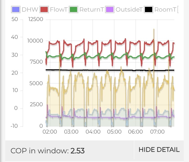

I’m counting 9 defrosts in 6 hours, and performance in line with Carnot heat formula. This seems perfectly normal for an adequately sized heatpump in a damp climate.
Oversized heatpumps benefit from larger heat exchanges and aren’t running at full capacity, so don’t need to defrost as often. On the other hand they can’t modulate down in mild weather, so it’s swings and roundabouts.
Yes, I count 34 defrosts in 21 hours, quite a lot.

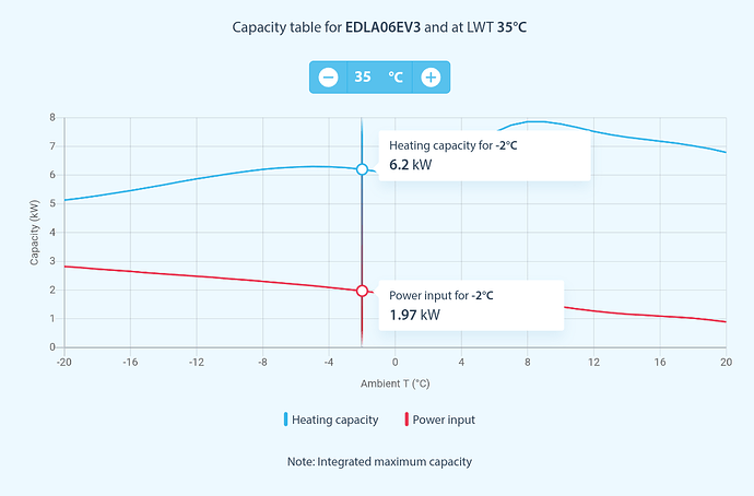

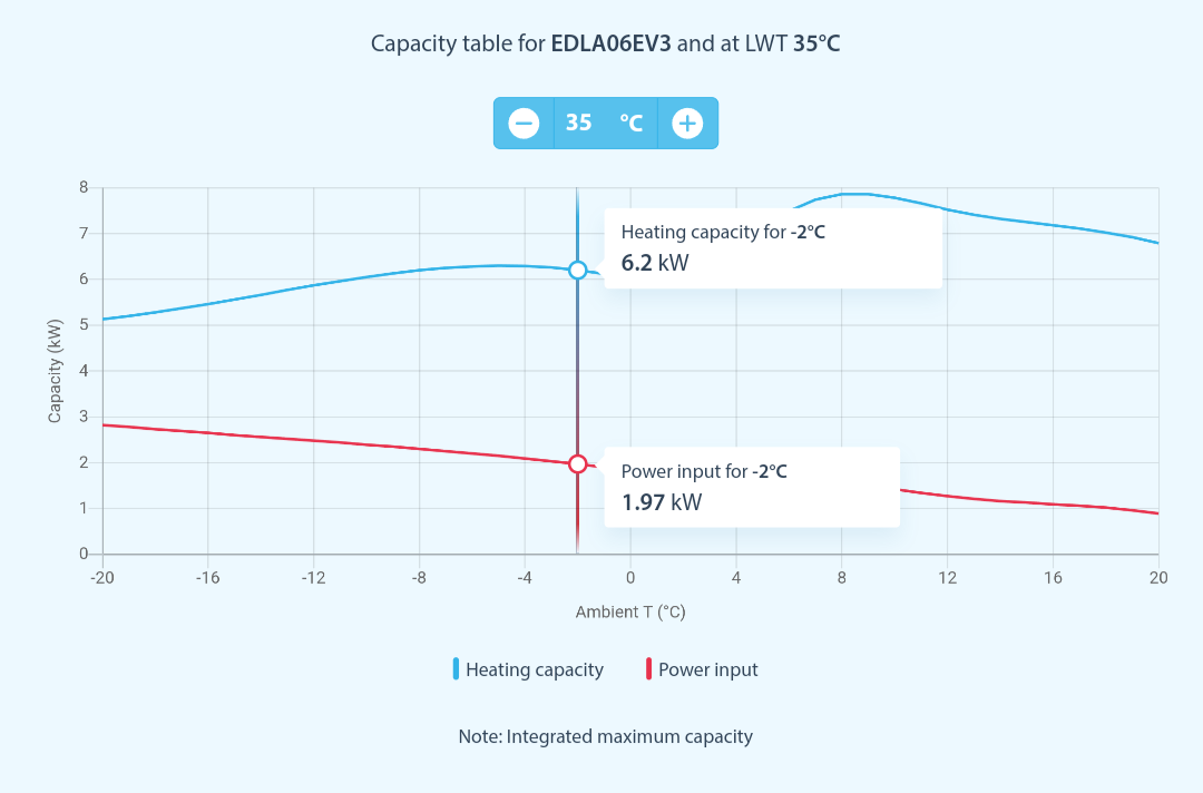

However, would you agree that the heat pump is on the limit of the amount of heat it can produce?
Can it get anywhere near its claimed 6kW output?
It’s doing just over 3.5kW
Important for people considering swapping out 9kW and 11kW units for one of these.
It s producing 6 kw of heat at times , even a little more on occasion
I know Chris, that’s the problem.
If you had a 5kW heat loss could it satisfy it?

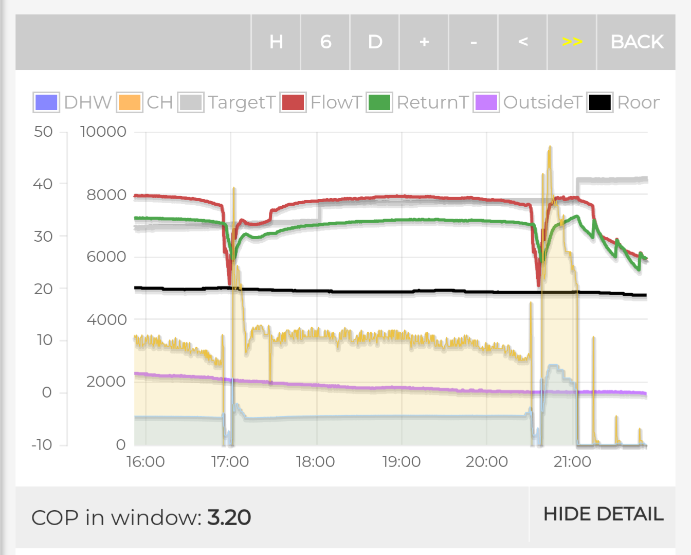

Your heat loss appears to be only 3.5kW at -2.5c
Your room temperature is steady.
But it is struggling, do you think you could get another 2kW of heat out of it?
If the heat exchanger was the same size and the instantaneous heat out put was lower probably

I think that instantaneous power is actually more than the heat loss to bring the room target temp up as quickly as possible. After the defrost cycle because it’s robbed some heat from house

For you, try limiting pump speed, that is what is giving you all that heat, it’s at 15lpm.
Mine starts at 10lpm restricted to 60%, as low as it will go.
Then you’ll get less heat at the beginning and you won’t be pushing it so hard, should cut down the defrosts.
Daikin’s expectations are obviously optimistic but I don’t think that there is a standard for manufacturers to model defrost cycles and it’s all climate dependent.
@TrystanLea on his heatpump oversizing thread suggested that the daikins should maybe look to be 1.5x actual heat loss. However, at some point you may be better both from a mild weather running modulation costs and from install costs to just have backup resistive heating for extreme weather conditions, especially around the changeover between model sizes.

It was a concern I had, my 9kW was only good for about 6.2kW in these conditions, maybe a bit less.
We are all running at quite low flow temperatures, me particularly. I know if I increased it much the defrosting would increase.
It’s difficult to know for sure, but something to consider.
You don’t seem to need a lot of heat, you’re probably Ok but I would insist on the 8kW if I were you.
