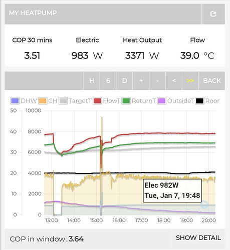

Pretty decent run as the temp dropped from 6 towards freezing today with just a single defrost.
Would I be right in thinking without overshoot (4) it would have cycled?
It doesn’t look like it, flow temperature was steady and didn’t increase.
Nice and smooth, unlike the smaller units.

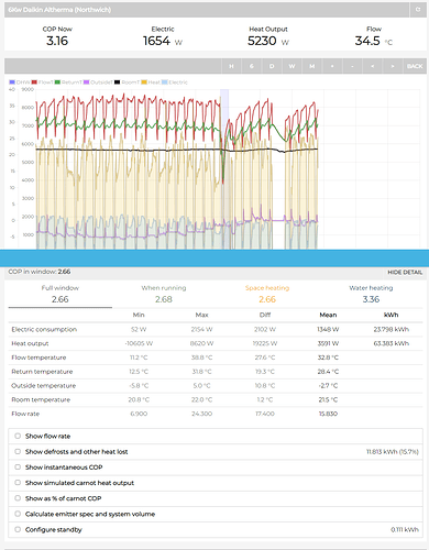

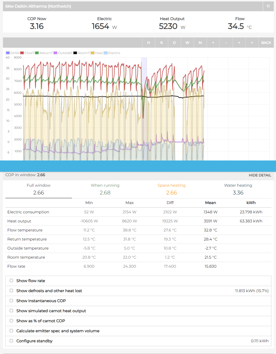

This is what a heat pump that’s too small looks like, on it’s limit at the conditions of the last few days. And why the 4kW and 6kW don’t make sense. I am sure the 8kW would have performed better and be no worse when warmer.
Not helped by not having a BUH?
Despite being a 6kW heat pump and putting out over 6kW at times, it can barely manage an average of 4kW because of defrosting.
And Octopus designed it to run at 50c flow in these conditions! I don’t think it can?

I think Chris has a heat loss of less than 6kW, imagine if you actually needed 5kW of heat.
Would the 6kW Daikin be capable of doing it?

i am at a loss it is what it is the house is warm but the efficiency has taken a noise dive because of the defrost cycles , my actual heat loss is around 4.8kw @-2 , i have been looking closely and cant help thinking that idf the heat pump started its cycle more gently it would have a better chance of not starting a other defrost cycle or even pulling less air through the coil
ive also been racking my brain why hp manufacturers dont use the return water to stop the frosting on the coils with a bypass rather than putting the heat pump in reverse maybe someone with more knowledge on heat pump design can tell me why
yes this means the heat pump works a little harder but a bypass to the coil before a defrost cycle with warm water should do the job
not sure if we have a over average humidity which will not be helping but we live in a local valley
my design temp is 50 degrees at -2.7 but i am only needing to run at around 35 degrees C
if anyone has any ideas to try to reduce these defrost cycles i am all ears
is there a way to reduce the initial start up power ??
i have recently increase the dt to 8 from 5 should i try going back down on this ?

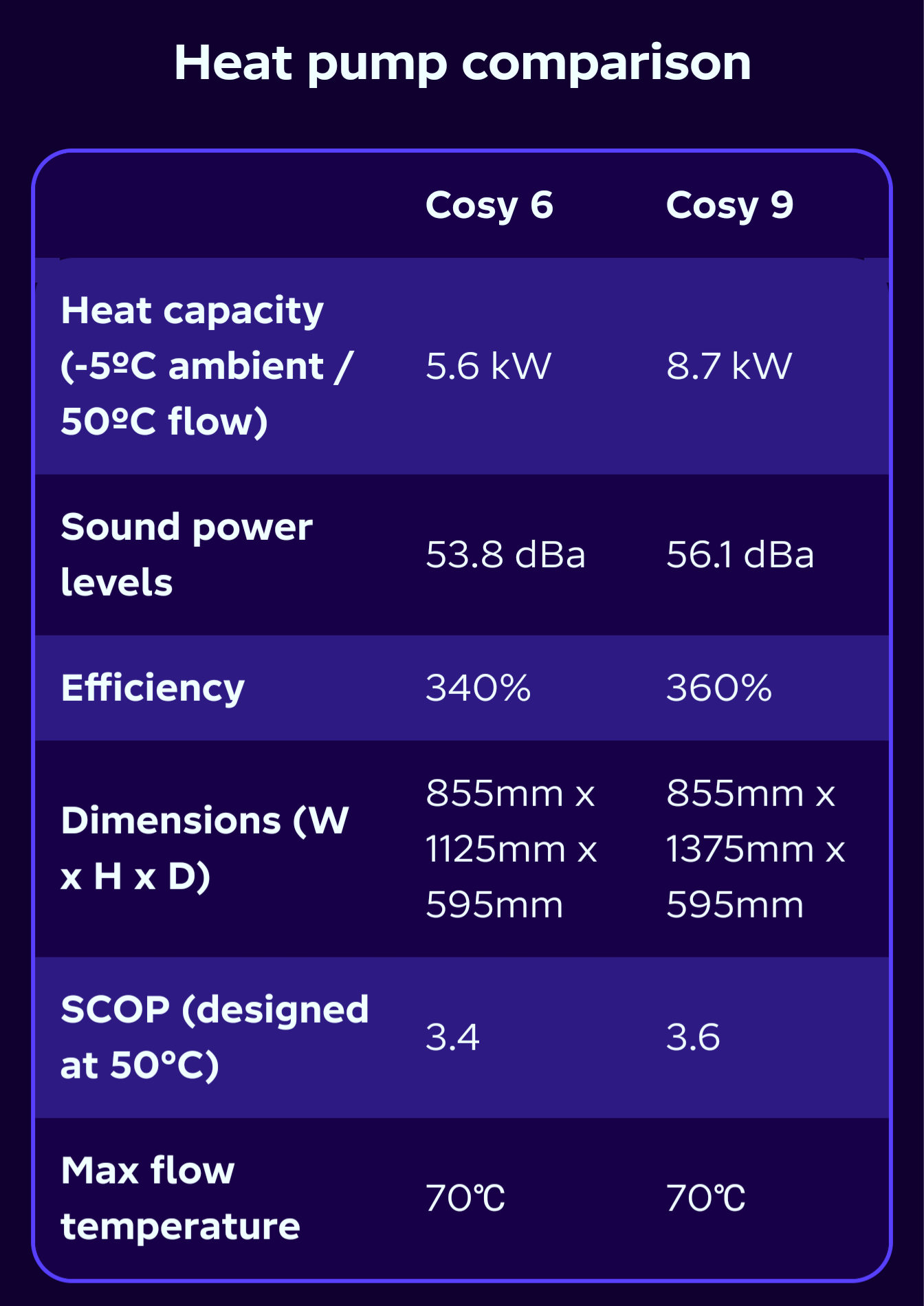

The Cosy 10 will now be known as the Cosy 9. Seems 10 was a bridge too far.

The heat pump is at 6kW+ and then loses some due to defrosting.
It can’t produce 6kW of heat at the design temperature.

A drop in efficiency is expected for any heatpump, especially in our climate. What change in COP are you seeing, and how often are the defrosts?
Cop is dropping by around half and only producing heat for around 1/2 hour before a other defrost
What I have just done is reduce my target in door temp to 1/2 degree below the actual temp and the heat pump didn’t work as hard despite the colder temps the heating period increased before next defrost

If anyone is interested it’s the heat cycle after 19:13
See post 88 Tim
Or look here
Emoncms - app view
