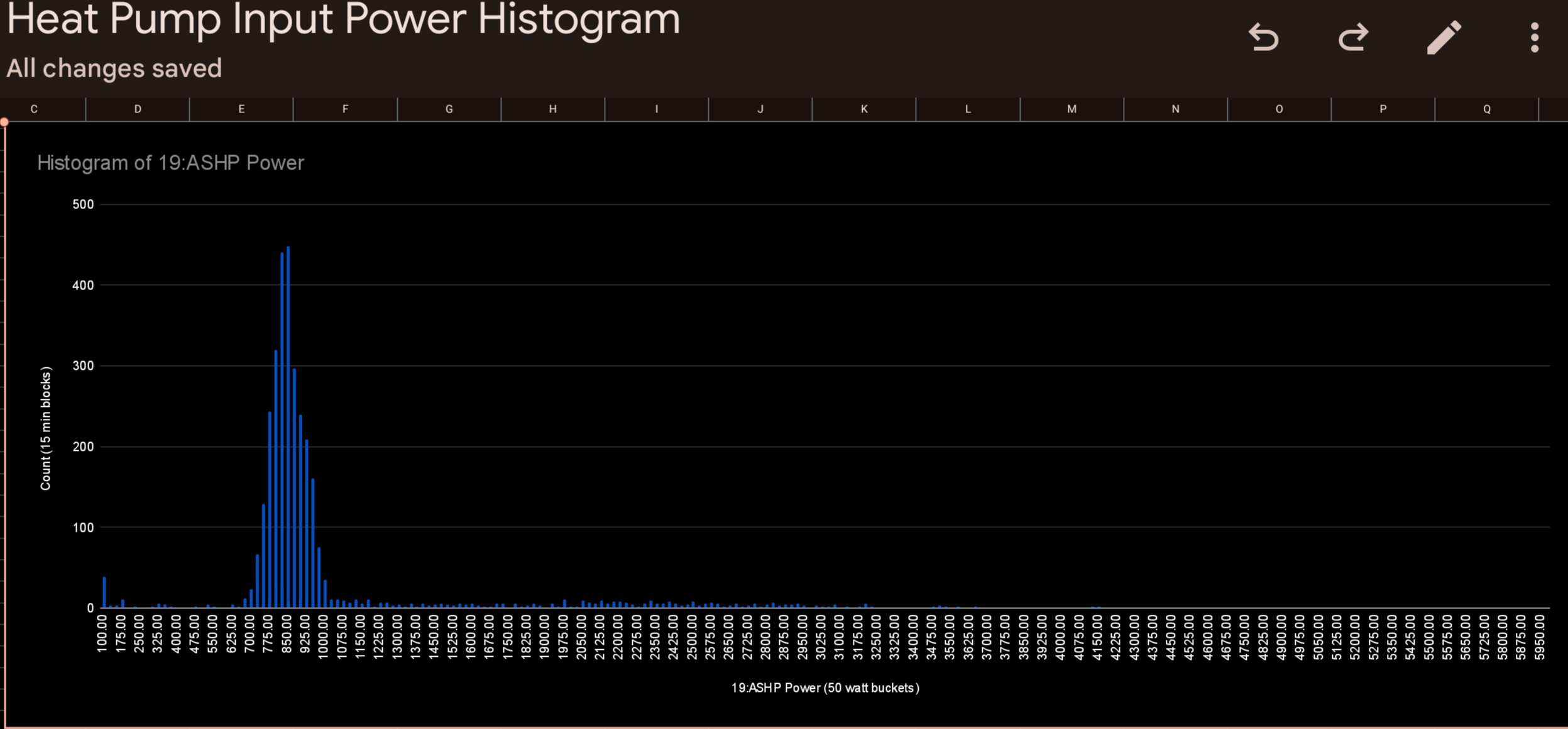

Here’s my electrical input every 15 mins since beginning of November (x axis) histogram. Below 100W filtered out.
The 11kW isn’t breaking a sweat.
