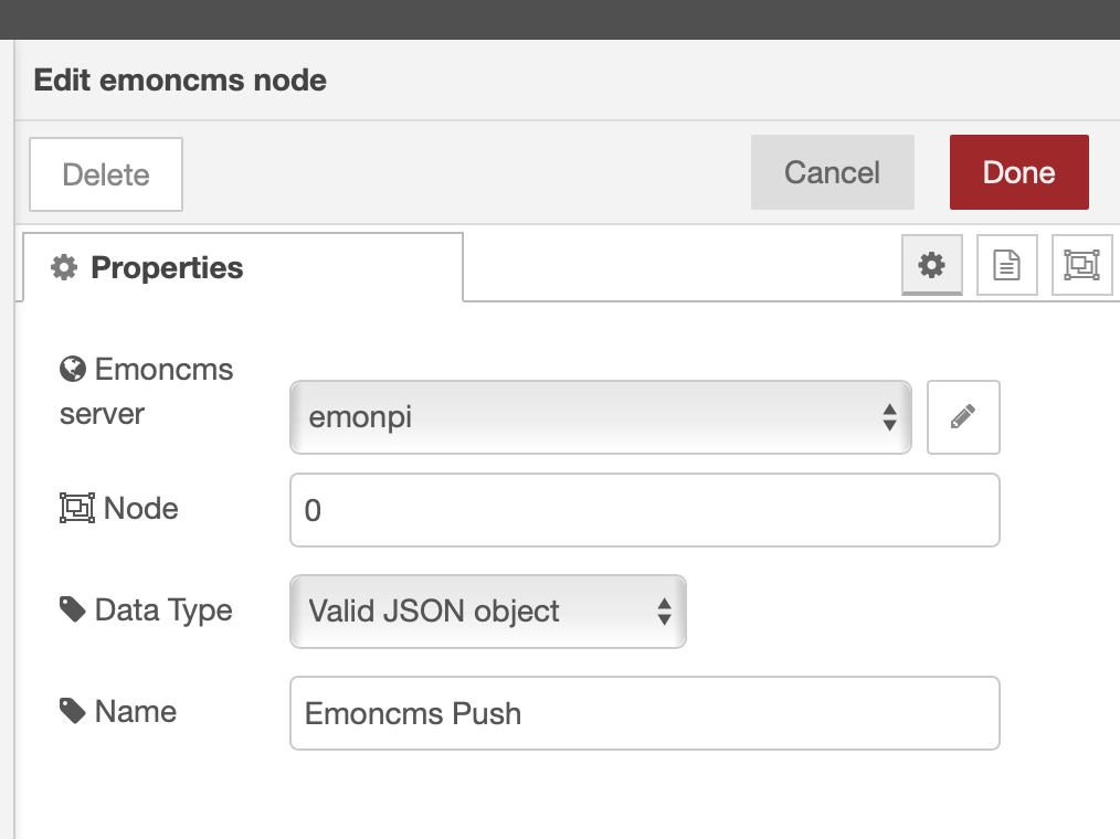

@borpin; herewith some screenshots. The Octopus node does collect “sensible” data, the Function node strips out all but the most recent consumption data (c/w times), the Delete Interval_start mode strips out one of the two time stamps (I thought this worthwhile but could be superfluous), but then there is an error with the emonCMS node.
emonCMS Node 0 is the one I use for the Powerwall, but I am aware that I have not configured this properly…

I needed to tweak a setting within the emonCMS node (to accept “simple” JSON), but then it worked; the Octopus consumption figures are only every 30 minutes, and delayed by 18 hours, so it’ll be a slow process to get the graph to show much - all the more so as I hope to only import anything between 00:30 - 04:30 anyway. But I’ll monitor it over the next 24 hours.

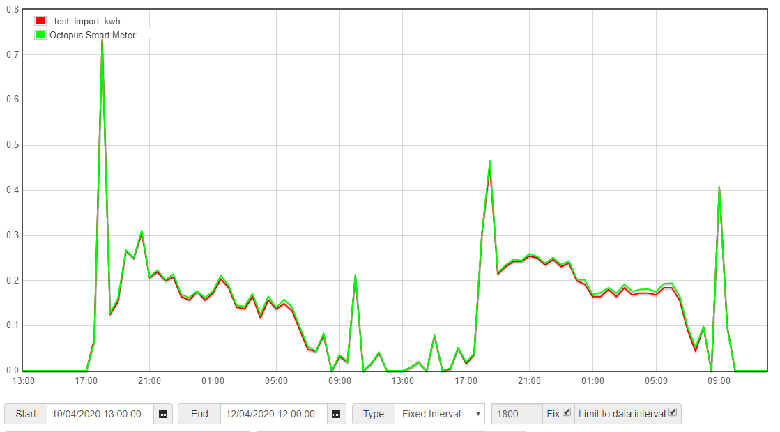

Its nice to see how accurate the emonpi is…
Red line is the import recorded by emoncms and the green actual from smart meter
