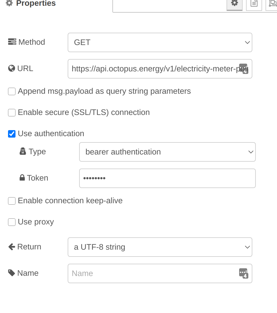

I’ve just tried to give this a go, however I can’t see anywhere to put the Octopus API key in the Octopus function, am I missing something?

Thanks, I’ve put the API key in the HTTP request bearer authentication Token field, however I’m getting error response: {"detail":"Authentication credentials were not provided."}
To test I’ve put the URL is directly into the HTTP request node, can you see what I’m missing?

The first node builds the whole URL so no need to put it in the HTTP Request node (leave it blank).
Again according to the docs, the bearer request should work. It does say add a : though.

In the Node-Red http_rquest node, add this;
Yes! I think that works. Do you just leave the password blank?
Although the consumption seems to return as 0?
That is what the API docs say to do.

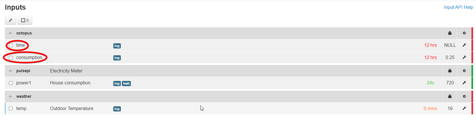

Hi guys. Thanks @borpin for getting me started with this. I finally got connected to my Agile as of Friday night/Saturday morning, so I’m keen to get a logged version of what my meter has been telling Octopus. I’m already monitoring meter pulses (and have been for a year or so, off and on) so I have pretty good ‘by-the-minute’ realtime watt data which works well with the Agile App, but having the Octopus API data I reckon would let me confirm everything is all square.
I’ve managed to get your node-red flow working - to a degree - but I’m struggling with the concept of how it’s meant to be displayed and interrogated later.
I’m getting data back from the Octopus API all fine (btw - you don’t need that colon symbol on the Octopus API key), and that’s going out to emoncms (I’m running mine on a standalone Pi) and seems ok.
In emoncms, the arrival of that data has created two inputs: octopus:time and octopus:consumption. I’ve tried to follow your instructions and set up two feeds, but although I was able to set the consumption feed to have a feed unit of kWh, I couldn’t find anything logical to set the time feed unit to. As a result, when I look at the time feed in the CSV view on a Graph, I just see ‘2020’ for all the time values. Any ideas?
Moreover, I’m struggling to understand how having two separate feeds - one of times and one of power-consumption spot figures, logged in two separate PHPFina feeds each with its own data-posting timestamps, actually enables me to see that on a graph with the Octopus time on one axis and the consumption on the other. I seem to end up with time and consumption on two y-axes, and the data-posting timestamp on the x-axis, which isn’t a lot of use. How do I get the Octopus time on the horizontal axis? Is there supposed to be ONE input, not two - with the consumption as the payload, and a timestamp derived from the Octopus data? Or are the two inputs meant to be somehow integrated into a single feed, with the time component replacing the timestamp of the data-posting (i.e. the point where it was fetched).
I’m sure I’m doing something wrong, or I’ve failed to grasp some key concept here. Any help gratefully received. I feel I’m so close, but so far, and no cigar! LOL Thanks.

The payload/data part of the ‘octopus:time’ feed that’s coming in from Node-RED is surely the interval_end timestamp that signals the end of the half-hour period for which the other input feed data (consumption in kWh) tallies. Looking at a debug msg.payload on the json node, I’m seeing ‘time’ data like: interval_end: “2020-09-13T00:30:00+01:00” which all seems sensible and relevant, and these appear to being passed correctly into EmonCMS.
Of course, because they are passed in when I do the grand fetch, they also possess a PHPFina automatically-added UNIX timestamp component, presumably, and this is the time of the grand fetch and means nothing to us in terms of useful calculation.
To be clear, it’s not the UNIX timestamp I’m having trouble with - it’s the Octopus ‘interval_end’ time - i.e. the actual data received, denoting the half-hour of interest. How is that supposed to be marked, in the ‘Feed Unit’ box? (see pic)
In case it’s helpful, I’m seeing the two INPUTS circled in red on the next pic:
Is this correct?
And in terms of feeds, I’ve done as you indicated and told both those inputs to Log to Feed with a 30min data interval (pic 3)
Is that correct too?

Is the misunderstanding that you want to be sending the data into emonCMS with the time attached to the value, as per the JSON format option as specified in the Input API:
{“power1”:100,“power2”:200,“power3”:300,“time”:“2020-09-14T11:54:35+01:00”}
which (as I understand it) inhibits emonCMS from attaching its own time stamp. Therefore you need to combine the two “Feeds” before they become Feeds? I know nothing about the process you’re using to transfer the data, so I can’t help any further.
