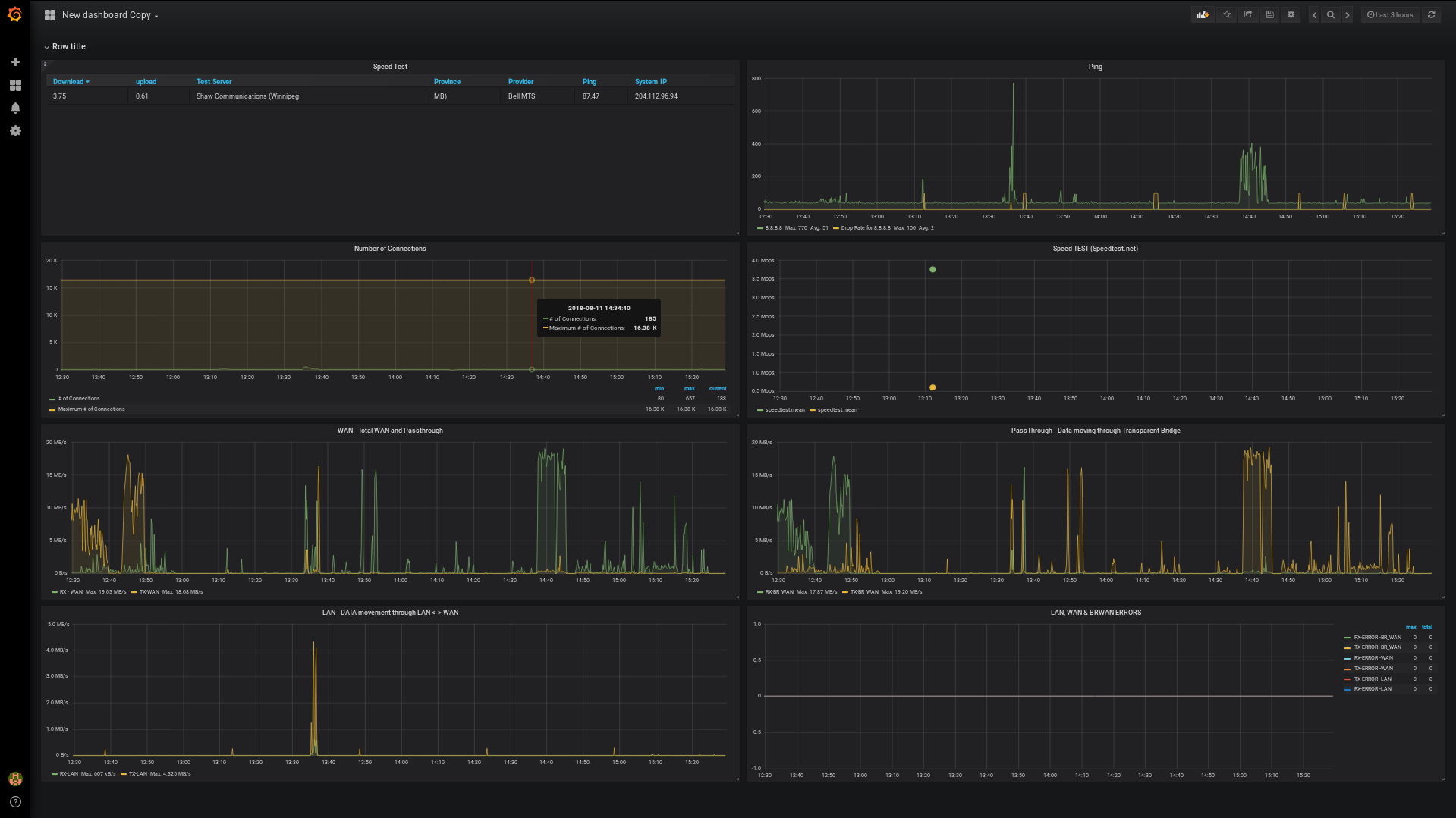

for those who might be interested here is a small flash of my openwrt Network monitor ( <30meg) for the BPI-R1 it will communicate with influxdb and send any data stored by CollectD .
to configure just follow the Manual Networkinfo Manual.pdf (129.8 KB)
if you wish to use it as IOT device monitor just follow the howto HowTo.doc (1.0 KB)
example data output
it is very resilient current frequency is averaged of 2 seconds but that can be reduced or increased. , all data is store in the volatile memory of the router making the the life span of the SD very very long. but you can store data in non volatile if you wish for permanent data collection on the openwrt, then basically you could shut down your influxdb and start it up a year later and the router will slowly up load all your data to the influxdb with out issue . as it is now it will only upload the data that was stored from the last restart of the router and the data is sent every 30 seconds if influxdb is online
can be found at :slight_smile:
Notice openwrt had a new firmware for BPI-R1 so I made an updated version now using a custom collectd-mod-interface I wrote that only compatible 18.06.0 or higher
works wells and uploads easily to any influx server
has 4 categories for MQTT they are Energy, Temp, Humidity, Flow and Pressure ( more can be added)
