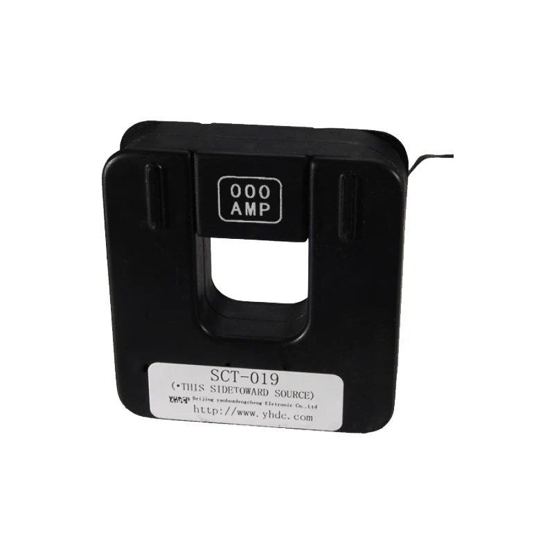

I have two of the below CTs and got them wired up to the emom-pi. I am getting reading but they are way off. I am getting -168 on one leg and 462 on the other. It is not possible for me to get more than 200amp per leg. Is there some config that I am missing?
That is not one of our “preferred” c.t’s; however you can use it.
Our standard current input, for all the Emon devices, is 50 mA. The calibration is set to show 100 A per 50 mA input current. Therefore, there is one of two things you need to do.
  1. If you feel confident, you can remove the SMT burden resistors inside the emonPi and substitute wire-ended resistors that will give the same voltage but with only 33 mA flowing. The value you need is 33 Ω. Then you change the scale factor to give the correct current reading. In emonhub.conf (accessible via your browser), for Node 5 change the ``scales = …` values for your 3 powers (Power1, Power2 & Power1plusPower2) to 2.0 ( = 200 [your current] ÷ 100 [our current] ).
    This will give you the best input sensitivity.
  2. If you don’t feel confident to do the hardware change, then just change the scale factors. In this case, the number you need is 3.03 ( = 50 [the original c.t. secondary current for 100 A] ÷ 33 [your c.t. secondary current for 200 A] × 200 [your current] ÷ 100 [the original current] ). If you don’t change the resistors, then at low currents, you will lose some sensitivity and hit inaccuracies sooner, but unless you are really going to be concerned with currents below about ½ A, it’s not likely to be significant.

Ok so I change the scaling and I am now getting close to what I get with a clamp on amp meter. I also swapped the cables for one of the CTs and no longer getting a neg number. I also did not notice at first that the input from the CT is in Watts when show in the interface. Well this is a problem, That means you are taking the volts x amps which is fine but the interface is showing the wrong volts. I have the calibration = 110V and the interface shows 110 but the voltage is really 116-117 meaning the watts number is wrong.
What is the fix to get the real watts usage?
Bill to your point I am the sole home on a 25kva transformer so I cant use 200 Amps available continuously but where I have to place the CTs the wire awg is 4/0 AL. Between wire and insulation it just under 3/4 in so the only CTs that I could find that would fit was the 200amp.

I’m in the US too, so have the same issue. i.e the AWG 4/0 Aluminum.
To get around that, I use Wattcore WC-1 and Magnelab SCT-0750-000 CTs.
Like yours, mine is the sole house on a 25kVA pot.
