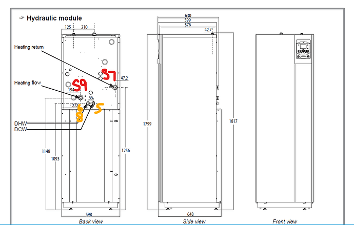

  • the return temperature from the Rads (s7) isn’t moving at all, which is odd
    would be worth checking the sensor is properly secured to the pipework
  • the DHW Flow (s6) doesn’t quite line up with DHW actual temp - is it measuring the water coming out of the tank?

This is great to have this type of info, thank you both. I’m really trying to wrap my head around this. It is possible that i have made an error with which pipe is the return. The system is squished into a box, and it’s hard to guess which pipe is destined for what. I will look at my other sensors. guessing from your response about s7 that something more dramatic should be happening more or less in sync with the flow.

I don’t see one. I’d expect a pair like UFH has, with a dT around 4 or 5.
HeatP 4 looks to be going into DHW?
I’m just confirming 1 by 1 and trying to be sure that my labels are also correct with a mug of hot water. These i can be quite sure are what they say they are. I have added extra insulation to s7 for going forward.
