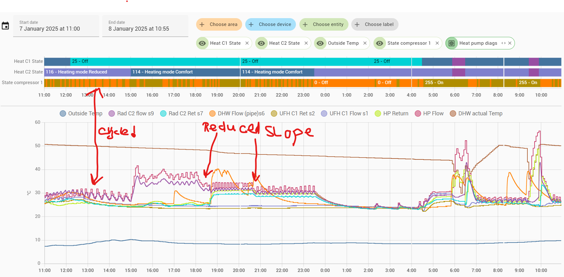

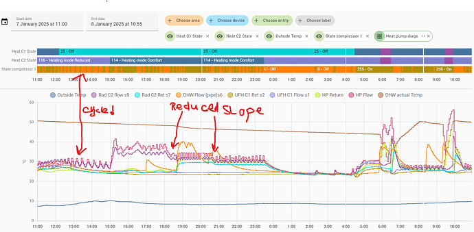

Looking at your charts have I read it right in that the flow to the radiators is cooler than the UFH?
Describing the UFH as the mixed circuit is normal, as normally the flow from the HP would go straight to the rads (hotter), then be blended down to the UFH. The flow is quite low temperature already, where are you in France?
It’s hard to say specifically how to optimise your system without knowing the hydraulic layout.
Where is the blending happening for example?
If you can trace the plant area pipe work layout then we can see what the 2 circuits are made of that would help.

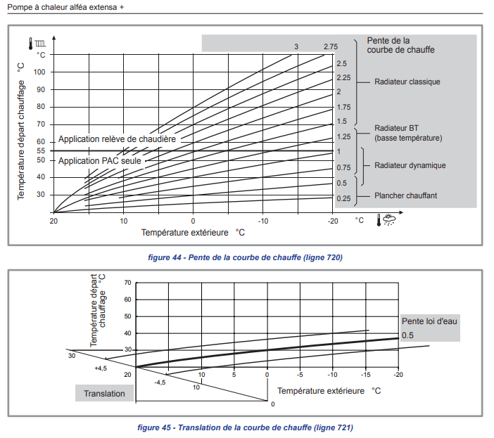

Some good views above, agree! Particularly about getting the curve/slope right so you can have all the TRVs open most of the time. 1.3 sounds very high, if that’s what that table shows.

For your first question, i think it might depend the operating mode for each circuit. In this snapshot from yesterday, it looks like the temps for rad ā€œreduced modeā€ (low) is similar to ufh ā€œcomfortā€ mode- (high) -Am i right that this seems to be a french way of controlling heating that’s different from UK?

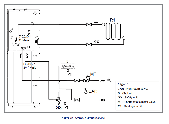

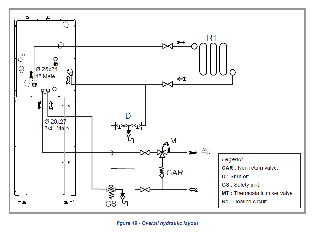

This is the circuit for the basic configuration with 1 circuit, i am trying to find the same for the dual circuit. But this should be more or less correct for the UFH part.
I believe that i do! a small red vessel a bit bigger than a football.

looking to your graph, indeed, your flow temp to rad is too high.
Also I guess it’s in variable mode for this Rad loop ?
Comparing to my setup, I’m on lower curve, same for UFH and Rad, but we don’t know how insulated is your house, you should lower the curve from 1.3 to … (I guess 0.5) untill the desired required temp is reach but is no longer above WITH TRVs full open, and lower the speed to an inaudible state, I would try that first.
I see it’s scheduled ā€œdayā€ between 4:00 to 10:00 and 16:00 to 0:00.
I’m to keep the same temp demand 24/7,It’s high power demands during restarts, it kills the COP, and this will help to lower the heat curves
Is this not the expansion vessel that maintains pressure in the system? It will be connected via a single pipe.
A buffer would be a little larger, with 4 pipes connected to it plus an second pump. This isn’t shown on the schematic, but could be integrated inside the hydraulic unit.

I will try to lower the curve and see what temperatures i will get. Then i can reduce the flow to see how that affects it. ( hopefully make it a lot more quiet!

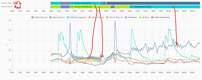

Hello again. Here is some graphs from the last 24 hours, i have reduced the variable pump speed, and also the slope several times, currently down to 0.7, and much less noise with the TRV’s open.
Should i be concerned about this cycling? or is it not too excessive?

More than 3 cycles per hours is cause for concern, and will shorten the life of the compressor.
Between 13:00 and 15:00 is okay,
but 19:00 to 23:30 is way too often.
UFH has been off for most of the day, so only the rads are able to ā€œcoolā€ the heat pump. 30° is way too low for these radiators.
What’s the rated output of this heatpump? How many radiators do you have?
4:30 to 5:00 has both UFH and Rads on at the same time, and flow temp runs nice and stable at 30° until DHW reheat.
7:00 - 9:00 is trying to run UFH and Rads at 27°, and failing.
Thanks for the analysis. I believe it’s 6KW, and i have 4 radiators, i had been running with 1 of them closed off in a spare room, so i have opened that up full for tonight to see if that helps.
What are you thinking? oversized like almost everyone else that has a heatpump from what i’m reading?!
When both UFH and radiators are open at the same time, then the heatpump seems to be sized correctly for 10°C ambient (hard to be sure without seeing power data). When only one circuit is open, specifically the radiator circuit, then it seems there’s not enough surface area to shed the heat coming from the heatpump, hence the cycling.
Making sure all 4 radiators are open will help. You may need to run them hotter, and then have the room thermostat stop calling for heat when the rooms are warm enough (not TRVs!)
