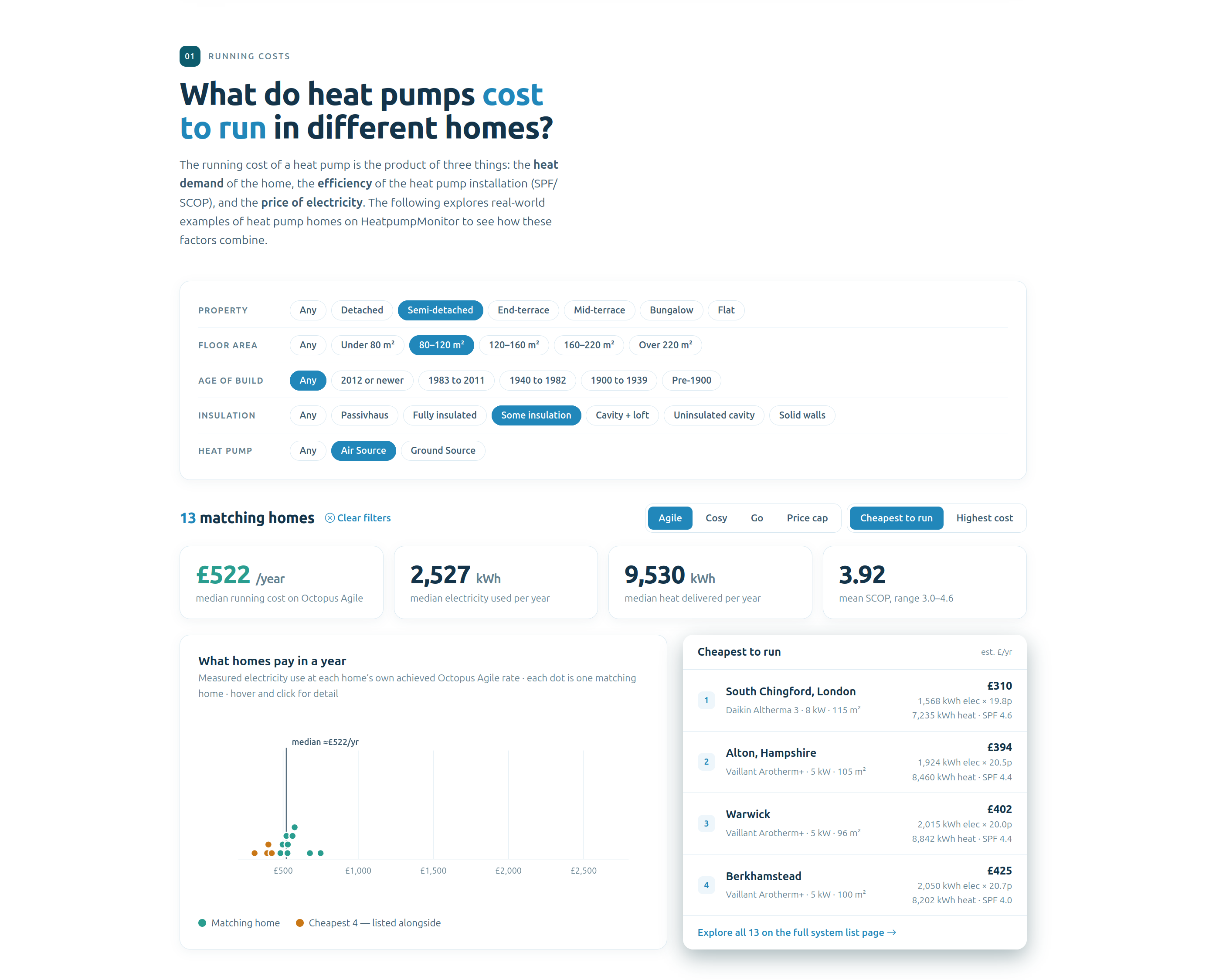

First there is a tool to find examples of running costs for different types of homes:

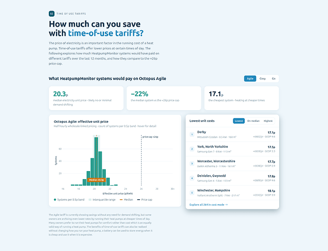

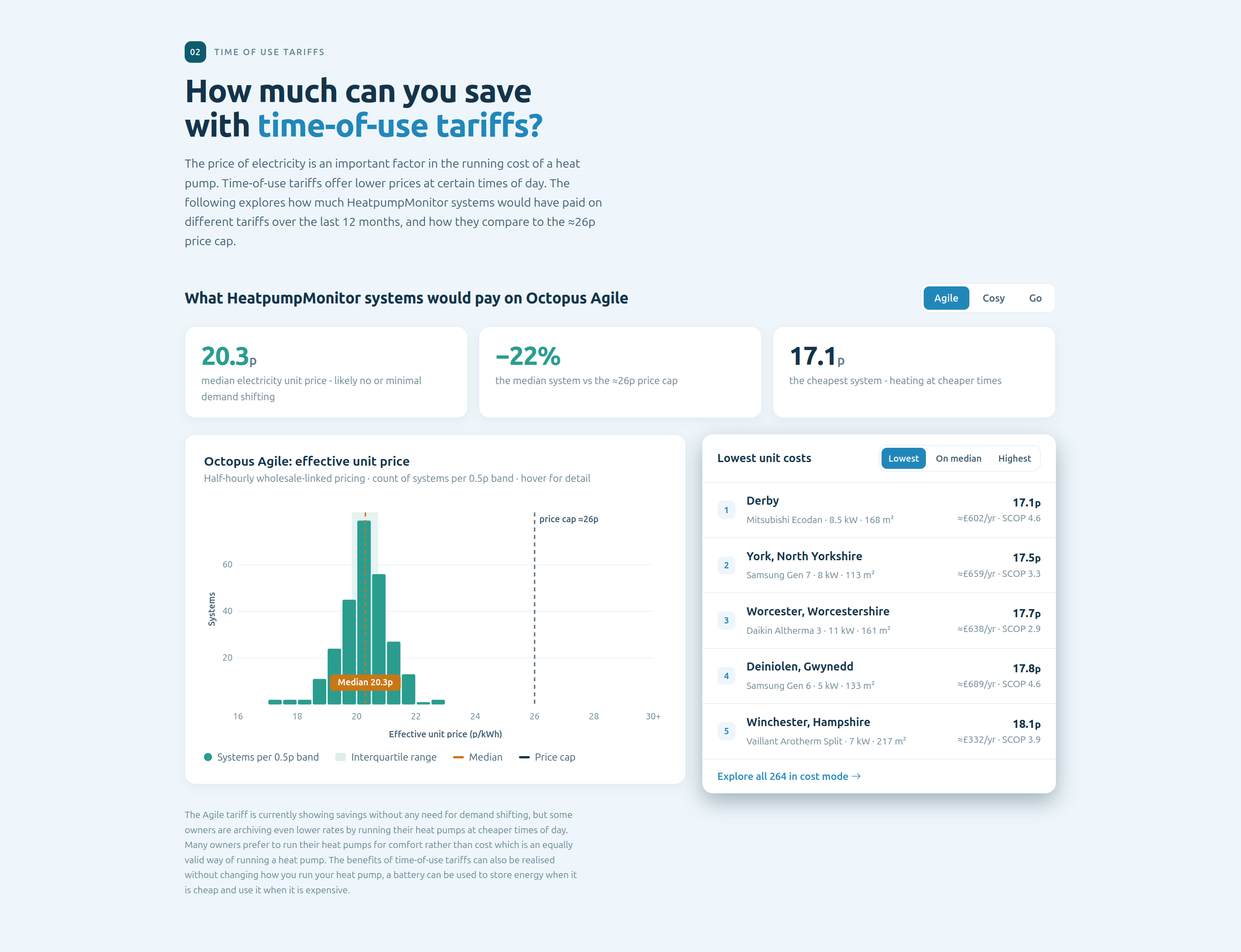

Second there is a live version of the tariff distribution analysis discussed in this thread: HeatpumpMonitor.org time of use tariff unit rate distributions

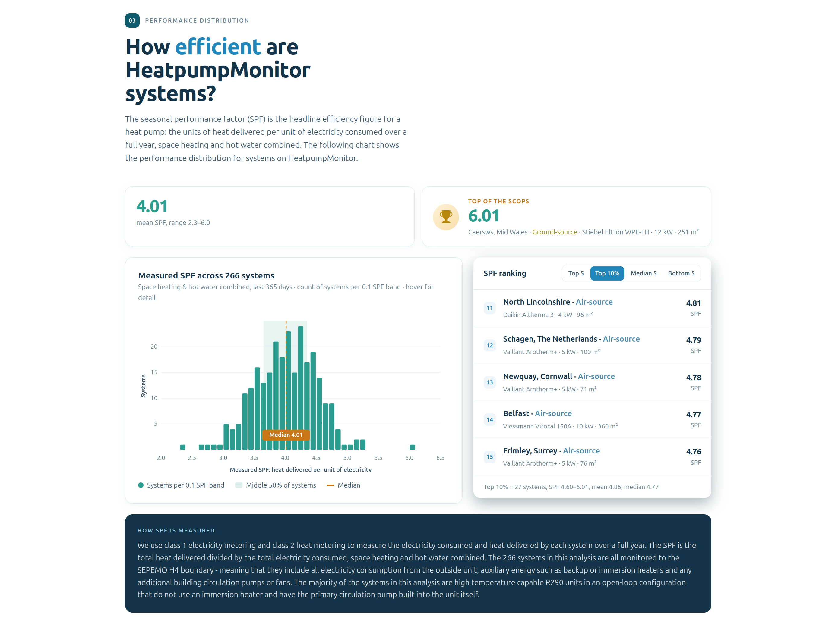

Third is the SPF performance distribution section, with option to explore, top 5, top 10%, median 5, bottom 5 etc.

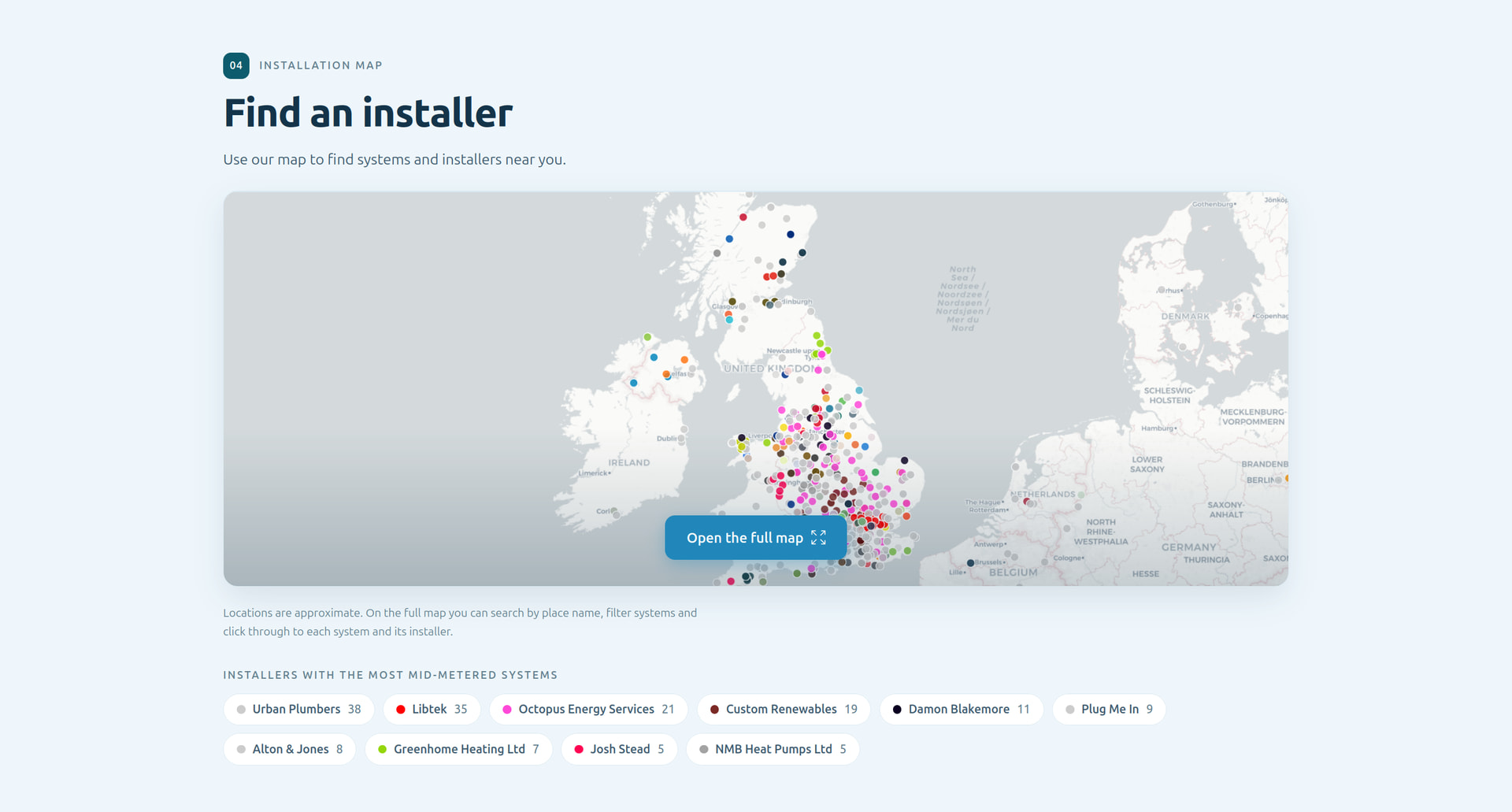

Fourth: Find an installer, a link to the map.

One suggestion would be to add a region filter to the “What do heat pumps cost to run in different homes”.

Agile Tariff, it’s even a complex tariff to a lot that do understand it - would a new person to smart tariff draw a blank and really understand it or be drawn to savings they may not be able to realise, could using a standard tariff may be more meaningful to more people? Or include both for comparison.

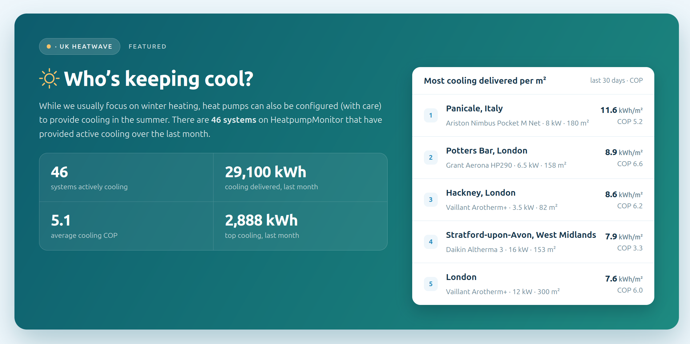

Your cooling page will always feature big heat pumps. But may not feature cost effective ones.

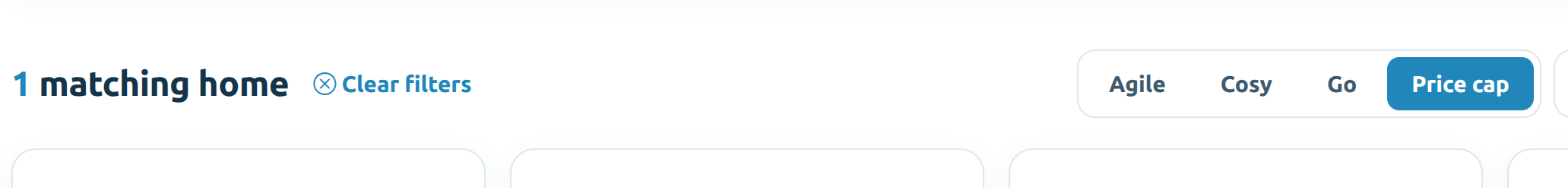

Under the “What do heat pumps cost to run in different homes?” heading, there is an option to compare the UK price cap with Agile, Go and Cosy:
I think it would be better to use the price cap as the default here, then highlight the savings in the following time-of-use tariffs section.
Thanks @Jonathan good idea re region, will think about that!

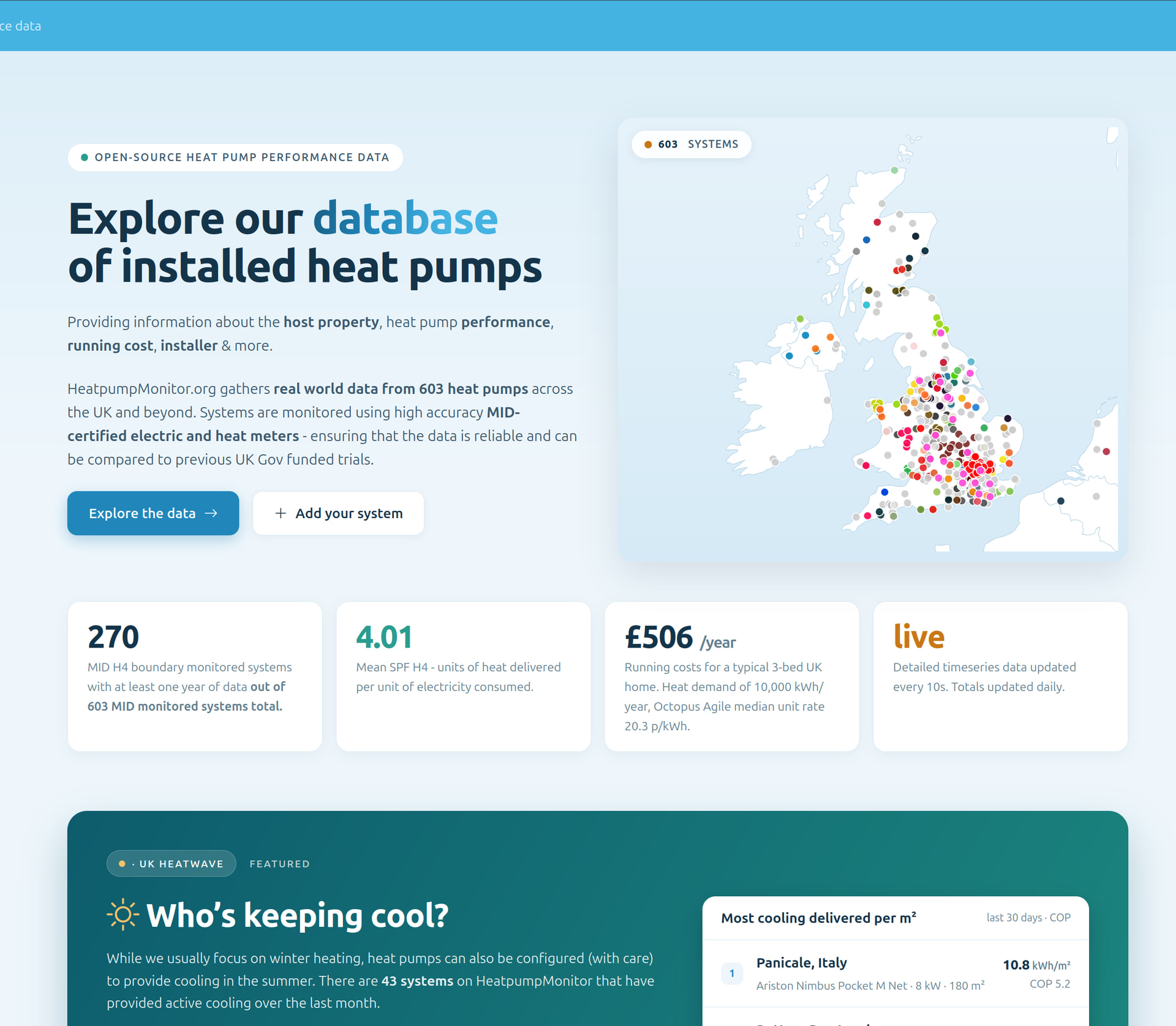

How about kWh/m2 cooling over the last month?
That may be better, but will always be a bit of a compromise
Il probably switch out the featuring of cooling sometime in the next few weeks anyway as the heat wave passes, so it’s more a section to highlight something different and interesting from time to time! Suggestions for what should be featured next welcome!

The ‘running cost’ tool is nice. A couple of suggestions … a. could the window that displays the result be scrollable? Because it’s not currently, it means going to the full list of heat pumps then having to locate the one of interest. A bit cumbersome. and b. the result window shows floor area but not property type, insulation or age ie. if the “any” option is used for property type, insulation, age this info isn’t identified in the result - info that would help folk id. properties similar to theirs.
Nice! thanks for that clear suggestion @SteveW !

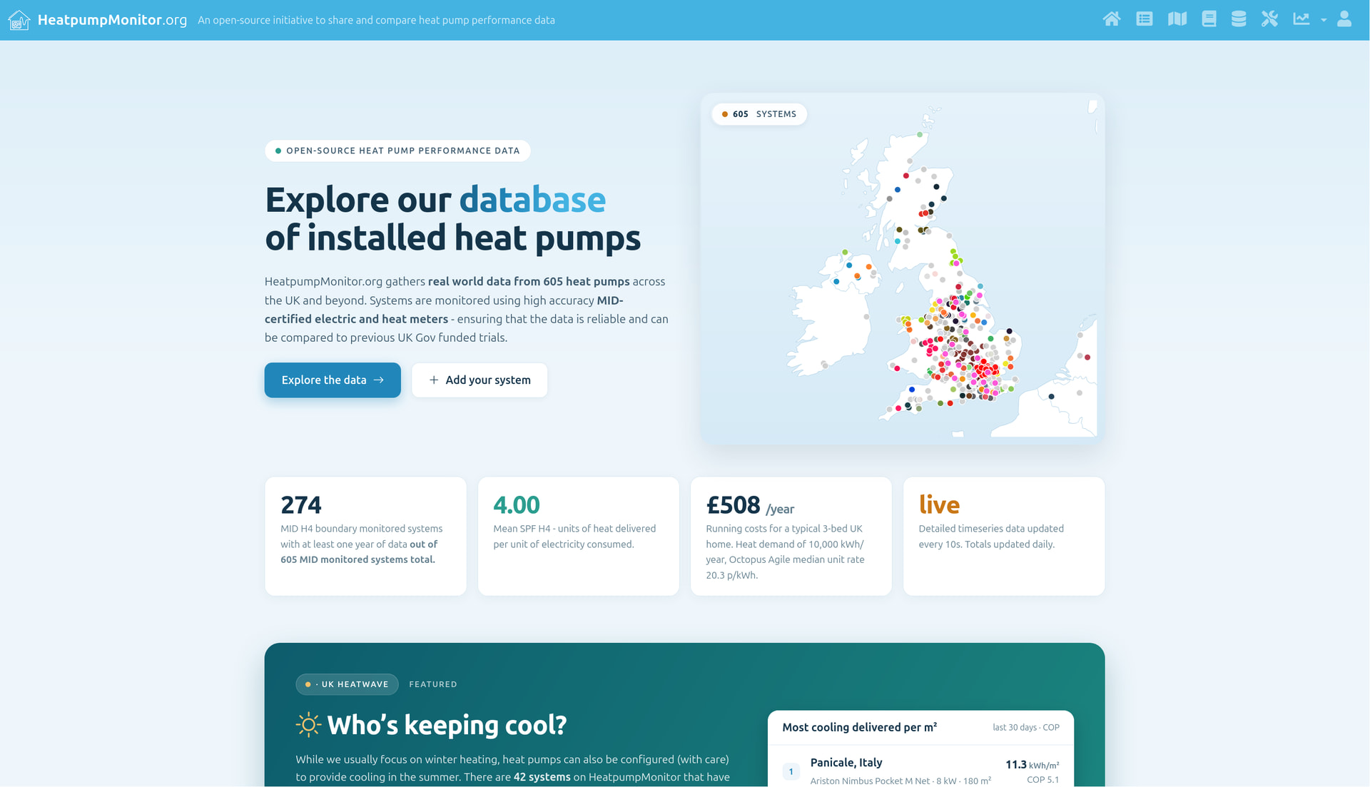

What do you think of the following @SteveW ? The map in that position is nice!

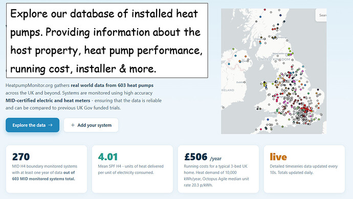

https://dev.heatpumpmonitor.org/

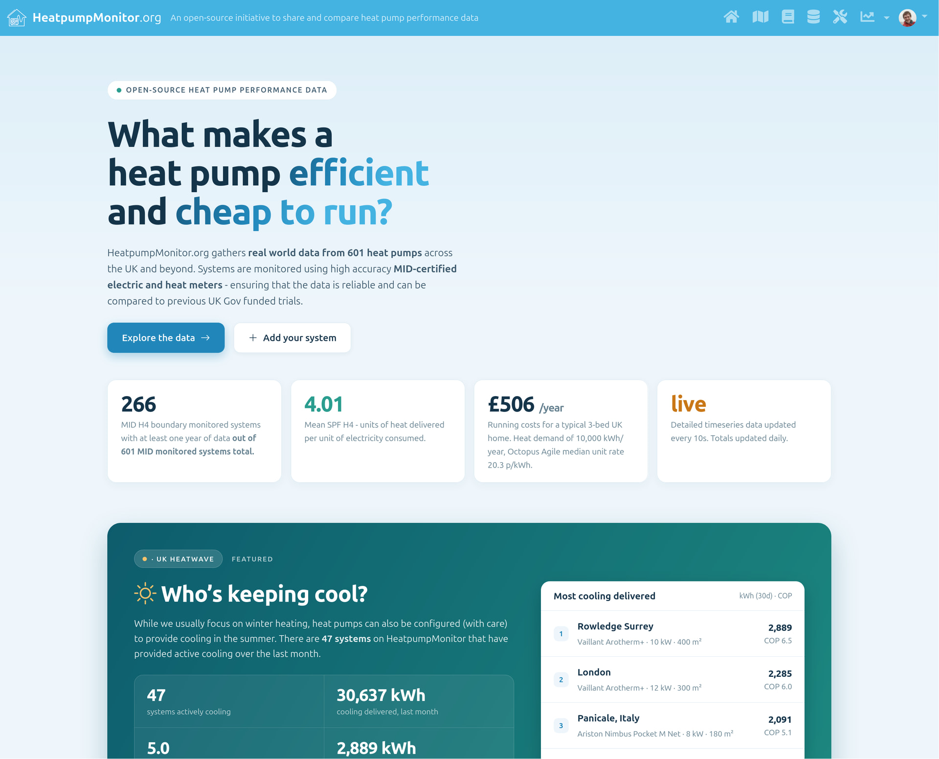

Is " Explore our database of installed heat pumps" the right title or should it be a sub heading to " What makes a heat pump efficient and cheap to run?".
Perhaps this should come first:
" HeatpumpMonitor.org gathers real world data from 603 heat pumps across the UK and beyond. Systems are monitored using high accuracy MID-certified electric and heat meters - ensuring that the data is reliable and can be compared to previous UK Gov funded trials."
followed by:
" Explore systems by host property, heat pump performance, running cost, installer & more."
Who are you aiming at, techie experts, Joe Public’s grandma or somewhere in between? Because it’s the answer to that which will determine how you pitch it.
“Explore our database of installed heat pumps” is fine if you know what a database is, have data for your own heat pump which you want to compare, or some idea of how to interpret data about heat pumps, while “What makes a heat pump efficient and cheap to run?” seems to suggest what they will read is like a Which? Best Buy report. If only.
My feeling is both are at opposite ends and too extreme to have a wide appeal.
The top screen-full of this page is what sells the HeatPumpMonitor.org website. That it has the data is important, that it’s a database is irrelevant here. That it is accurate and credible is important, MID-certified meters is irrelevant here. These are details that belong further down the page.
I’m trying to see @SteveW and @TrystanLea’s suggestions from the point of view of (maybe) the press or social media picking this up and the page being visited by people with a whole range of knowledge and expertise. What I think many prospective heat pump buyers and quite a few heat pump users will want to know first is, will my heat pump cost me more or less to run compared with what I have, and will it be “better” (defined how?), and can I make it better/cheaper and how? And if they have looked or start to look at the forum, the inevitable question will be, how can I be sure my designer/installer has or will get it right so that it will work at its best?
A minor technical point: is the headline value of 603 heat pumps a dynamic figure? If it is, why not say so somewhere?

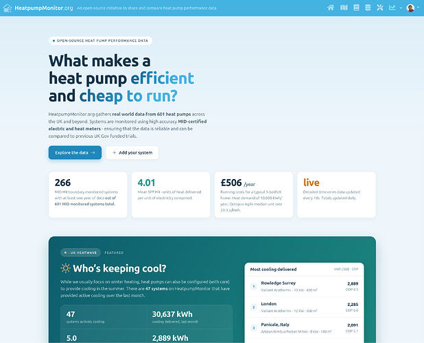

I’'ve changed the title for now to your suggestion @SteveW, certainly up for considering other suggestions, @glyn.hudson is of the strong view that it’s a better title and I think matches feedback we’ve had from a few installers too.
