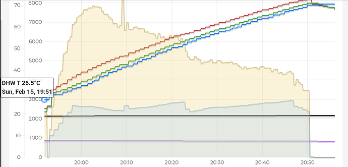

Could you help me understand the graph a bit better - I’ve been suggested a 110L FAT MiniStore by HG and am trying to work out if we can make it work for our family of 2 adults and 2 almost teenage boys
Is the blue line DHW T the temp of the heat inside the mini store, or the temp of the water coming out of it?
And do you have any concerns about how quickly it reheats - I’m specced a 7KW arotherm so imagine reheats would be a bit faster than what you’ve seen?

The blue line is the store temperature – on my version of the store it’s measured half way up the tank; on new builds I believe it will be nearer the bottom. Either way, the temperature of the water emerging is the same or hotter.
If people limit their time in the shower to something sensible, certainly less than 10 minutes, and if you can wait ten minutes between showers (depending on exactly how hot you shower – as I showed above you could probably shower for 20 minutes or more at 38°C), you’ll be fine. Teenage boys are notorious for spending very long periods of time in hot showers, but if you get a mini store, perhaps they’ll avoid that habit .
The spec tables suggest I could get ~16 mins @ 8l/min if I keep the store at 65 in the winter, which feels like plenty with a 10 min recharge each shower (while the faffing in the bathroom happens )

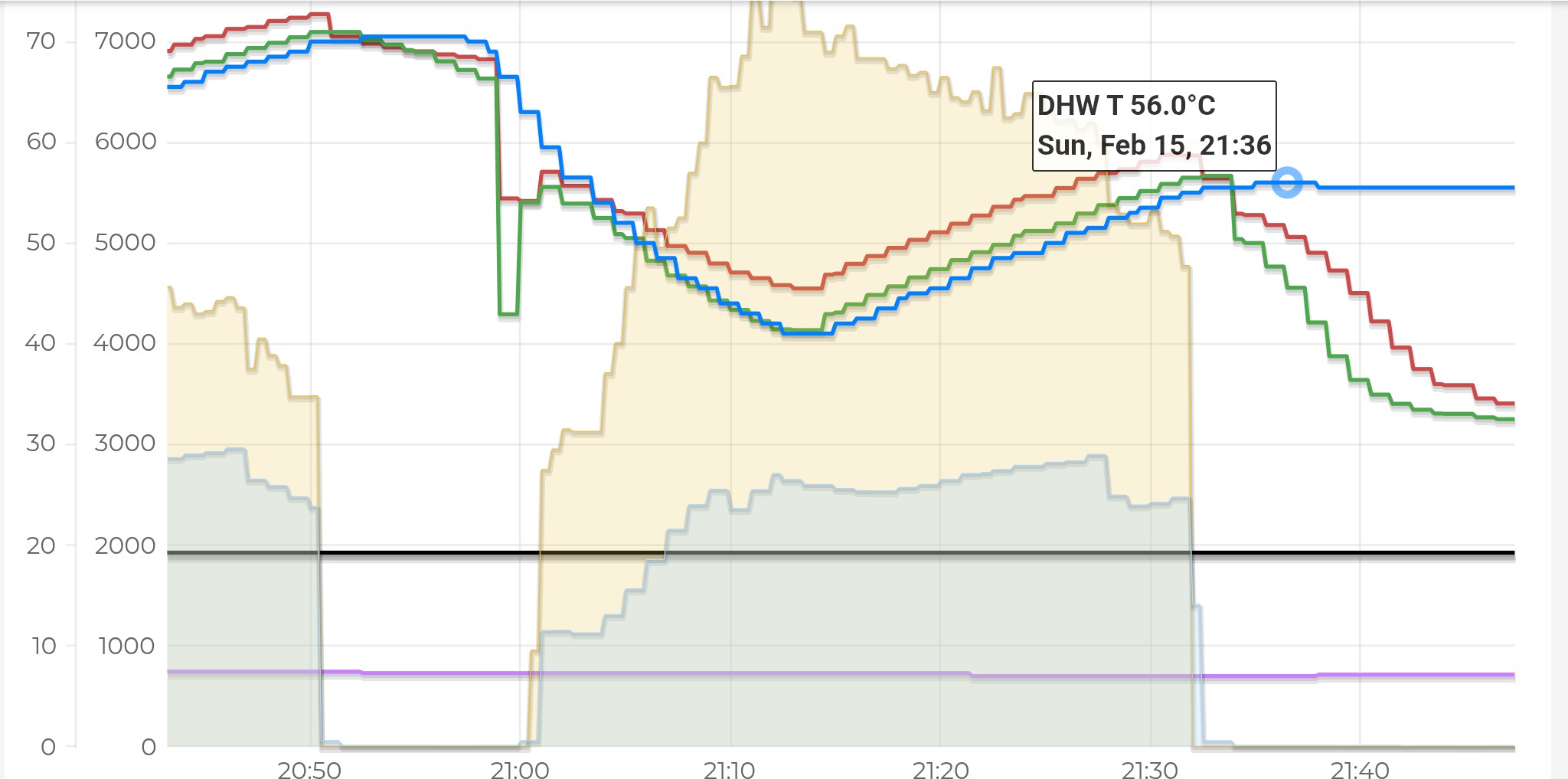

A couple of graphs of heating a Mini Store Fat 110 L with a 5 kW Arotherm Plus: first is heating from low 20s store temperature to 70°C, second is reheating while/after pouring a bath (stopping at 55°C). Outside temperature 7°C, mains inlet 9°C.
Pretty impressed the thing can recharge from completely cold in an hour. And from the looks of it you’ve got a bath out of a starting point of 70 degrees in the store, and recharged ready for another shower in less than 20 minutes
