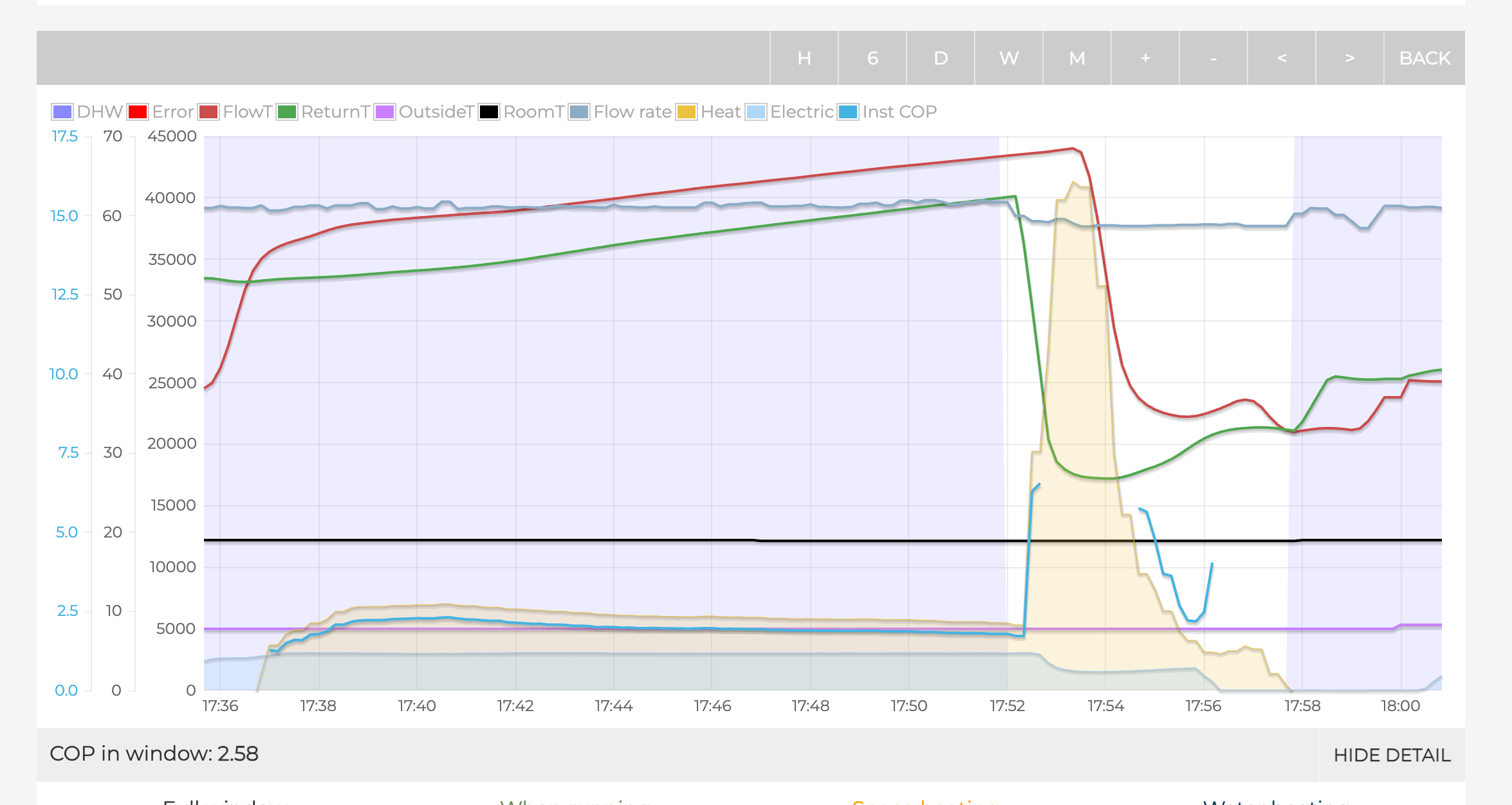

Overall I’ve found the DHW to be ok during winter, if you push it high temp to 65 you can have a nice hot shower. However, if set point is any lower for example 55 the shower will run lukewarm after 7-10 minutes when it’s cold weather. In mild weather like now, I essentially have a combi with unlimited hot water which is nice. In terms of COP I’ve been talking to heatgeek as you can see on my monitor it’s not very good for DHW.
Sadly if my winter performance cannot be improved (cop and DHW production)I’d prefer to have a traditional cylinder. Also losing most of your control of when your DHW runs happen is not ideal, as it essentially decides itself when to run.
Feel free to check my monitor.
I might regret getting involved here, but here goes. :laughing:
I’m wondering about your flow rate.
12.6 l/min (756 l/h) is more what you’d see on a 5kW, not a 7kW
Look at this Libtek 7kW
You can see they get close to 20 l/m in heating and they’ve cranked the DHW flow rate closer to 21 lm to ensure they keep close to DT5.
How’s your flow rate configured? Auto on both heating and DHW? Or have they been fixed at a percentage?

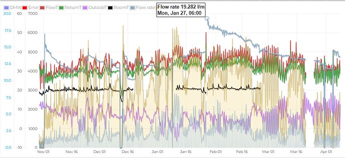

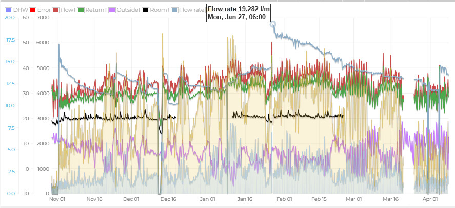

I’m wondering if you’ve got some sort of blockage build up?
If I look at this zoomed out view of your system I can see 18.8 (1,128 l/h) back in January, which is closer to like a free flowing 7kW should be doing. (20 l/m, 1200 l/h)
Have anyone tied two mini stores, with one heated to say 40c as a preheater before a 2nd heated to 60c?
You are quite right, the strainer needs cleaning out I think. 27th of Jan was the last time I cleaned it.

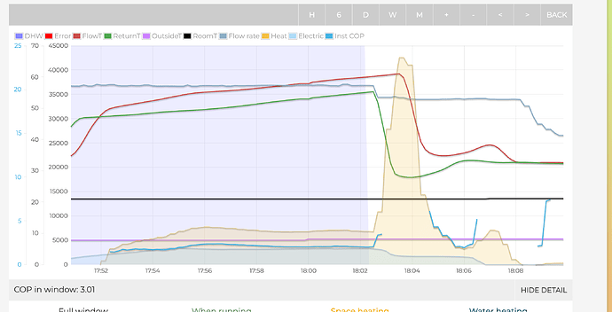

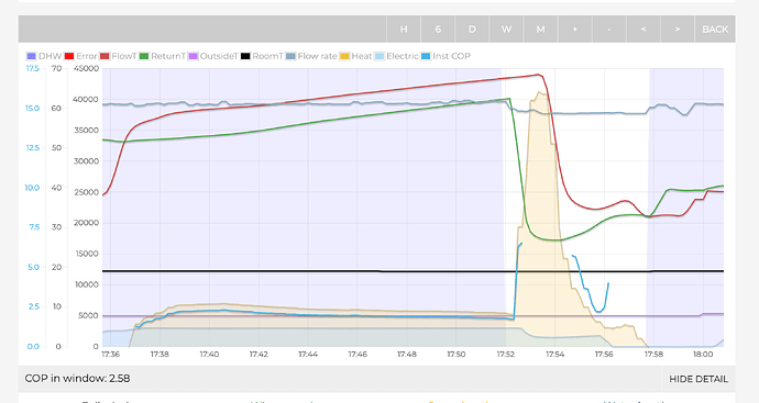

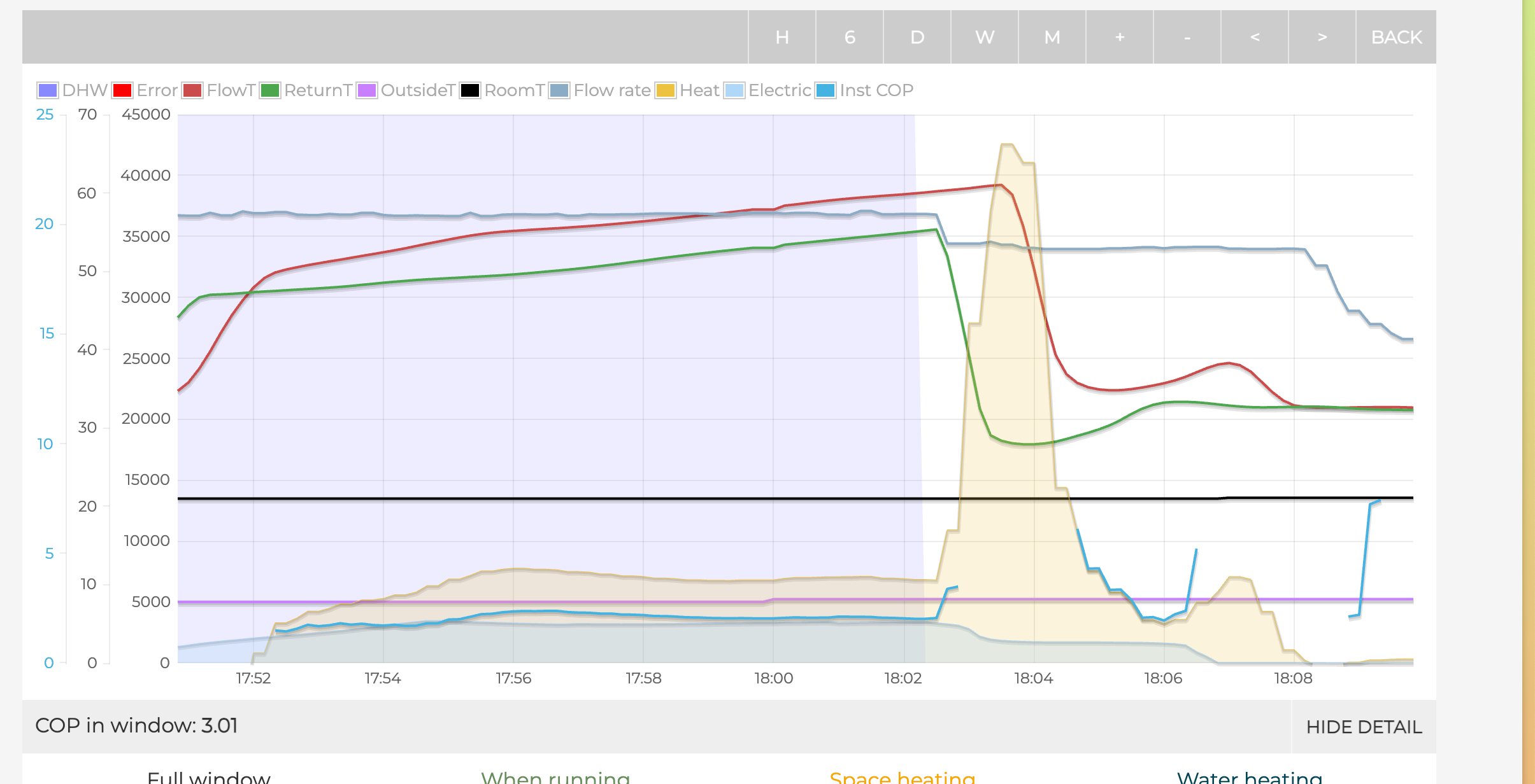

Before strainer clean:
after
after:
They look very similar. So not convinced it is having a big effect of performance.
I wonder what your thoughts are @Ivailo_Stefanov comment from another thread discussing my systems performance.
“These so called hick ups are due to wrong setting of EEV after compressor modulation drop. I made a query in other thread to @Andre_K I think to monitor and log the EEV position at these points but didn`t recieve any feedback
When you look at the graph for a DHW cycle, could the huge sudden release of heat be the EEV valve opening fully?
No, that appears to be the end of the DHW cycle when the 3-way-valve switches to space heating again. The inrush of cold water from the heating circuit coupled with the hot water still in the pipes from the DHW cycle leads to this high power output. It’s not like the heatpump compressor actually releases that much energy in this short time, it’s previously created heat that is stored in water that now appears as this power spike because cold water is rushing in and you have an accordingly huge dT.
Ultimately, 10 minute hot water runs at 50C to 60C flow temps will always have terrible performance.
The Czech tables says a COP of 2 at 60C flow at highest compressor (Normal mode)
So you’re about on spec!
Links to Czech tables can be found here

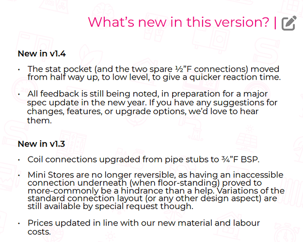

It looks like the Mini Store has had some tweeks to the design after feedback from installers/users.
With the stat pocket now lower down the cylinder, the heat pump will be triggered to start sooner after water consumption starts, and will keep the heat pump running for longer in order to get the measured temp back up to the target setpoint.
