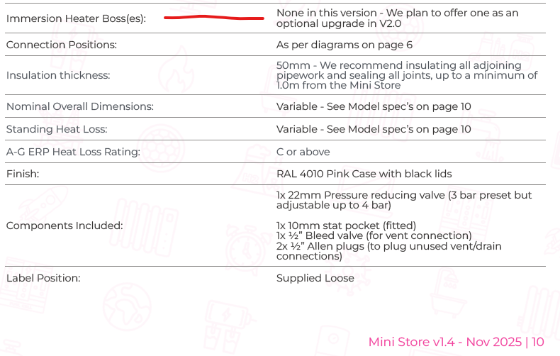

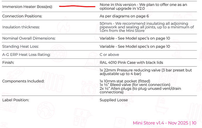

I’m sure there’s some maths that might prove this wrong, but it seems like a simple option would be to have a 3kw immersion in the Mini Store too that would provide a bit of a boost when the temp starts to drop. A bit like your 10kw heater idea above but lower power and inside the heat store. In fact the immersion could kick in as soon as demand starts, before the heat pump has ā€˜spun up’ that might prevent short cycling in the summer if the water only needs a small boost, and give a bit more headroom in the winter.
The future v2 of the MiniStore is planned to have the immersion boss as an option.
I just wish it would be available sooner rather than later this year.
Oh that’s cool, do you mind me asking where you got the info from that it’s being released later ā€˜26? I’m wondering if I wait for V2 and hope my boiler holds out long enough.

I contacted Newark Cylinders about an immersion in the Mini Store and they said that while it is being planned for v2, they can build them with an immersion connection now on request. That might be quite interesting as an option - potentially switching on the immersion to boost the store when running a bath or if it’s a particularly cold day and defrosts might be a problem.
So did I, and found they add 100 mm to the height of the cylinder, inserted just below the coil. This adds 11 litres of volume to the 375 mm diameter cylinders. The tapping point for the thermostat pocket ends up just above the immersion element though, so will likely switch off the heat pump before the cylinder is fully charged with heated water when the immersion is active. Prototypes of the v2 are being made for testing, and have a larger surface area of coil. I just hope they release v2 sooner rather than later for a Summer project this year.

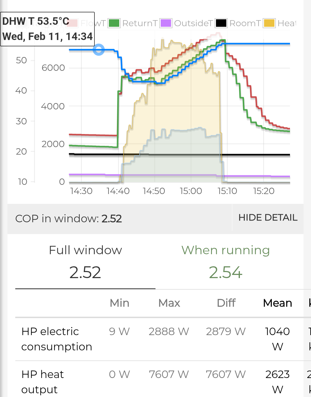

Fwiw, I’ve noticed that the 5 kW Arotherm – which produces more like 7 kW at full bore – can keep maintain a store temperature enough for my 38° showers, at 8 L/min flow, more or less indefinitely. Different story for my partner’s ~44° showers (the blending valve is set to max, 48°, but it’s only 44° when the water reaches the shower head). But neither of us are types who just stand in the shower contemplating life, the universe etc.
Here’s an example of my 5 kW Arotherm Plus supplying near continuous 38°C water at 8 L/min (I was washing the dogs). Mains cold water is 9°C.
You must have supplementry elec? heating to maintain a continuous flow of 8.0LPM at 38C, requires, 8*60*(38-9)/860, 16.19kW
You can see from the graph that the store temperature is declining slightly. The store is supplying 16 kW total, 7 kW from the heat pump and 9 kW from the heat energy already in it. It won’t supply 38°C forever but it will for a long time.
