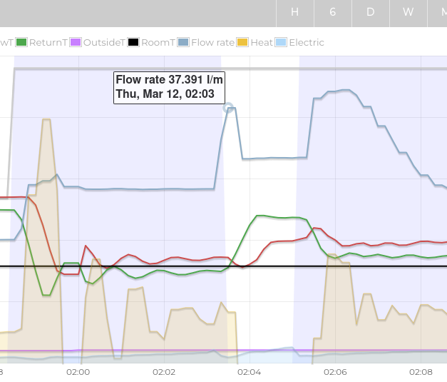

Oh that’s good news then, but strange @Dave_Storey that these settings don’t work for you, and they definitely don’t after your ASHP firmware update?
Unsure there, I’m assuming they are a blunt instrument but I may be wrong :slight_smile:
Are you definitely referring to defrosts? I’m surprised you got any last night! I didn’t but may be it’s milder here. Well, I did get one I suppose which is when the DHW was charging which does go high very briefly, see screenshot below:
