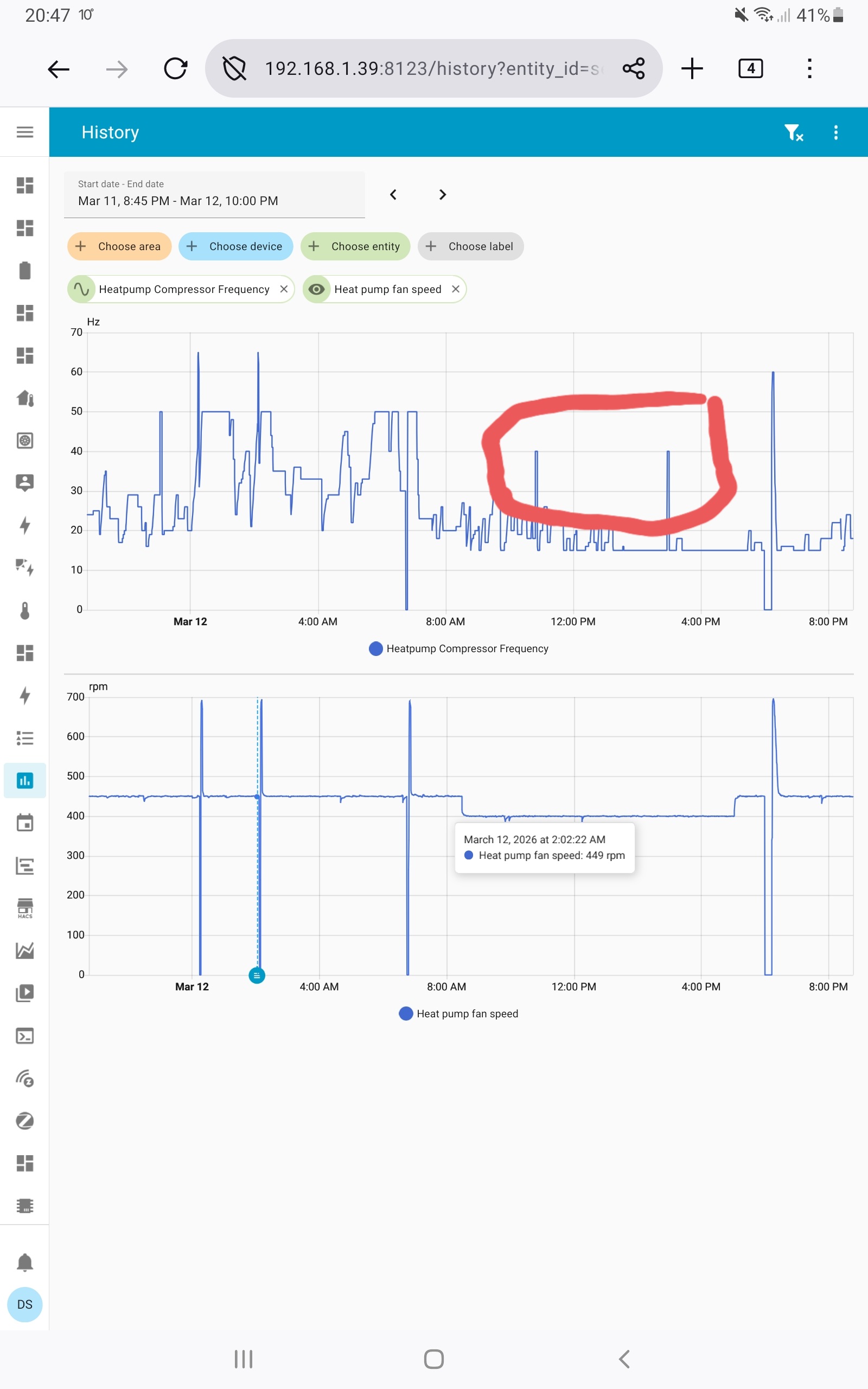

here is the home assistant graphs from mine. i had it in quiet mode 2 until tonight .. you see that the fan stayed at the desired q2 setting, 400 rpm, even during oil recovery (highlighted). the only high levels (700 it seems) were when it was starting up from off. maybe setting hfan2 will stop that too. i can run quiet2, which is fan 400,compressor 40hz or less, down to about 4 or 5c outside. Quiet1 works down to around zero. below that, quiet off (but now looks like hfan0,1 can even tame it down there?).
by the way, the first two spikes (in fan) were defrosts, the others two are restart after dhw, and compressor off.

Ah, fwiw, oil recovery is still running the fan at 700 rpm, regardless of the hfan 2 setting of 620, so I guess back to quiet mode for me!
I have a terrible memory so perhaps I am wrong but I don’t recall oil recovery ran the fan at high speeds, odd. Perhaps I’ve just forgotten as oil recovery only runs I think if the compressor has stayed below a certain level (40hz?) for a while and I guess that’s not been the case in winter.
oil recovery is compressor to 60hz if if has not been there in last 4 hours (was 3, with older firmware). in quiet modes is 40 or 50hz instead. I think fan speed does the same thing .. certainly limited to 400 or 450 rpm in the quiet modes, but i believe used to be max (ie 500 or 650, depending on temp?) when not quiet. Maybe 700 now? Will have to see, but as you say if i am not in quiet mode, ambient is zero or less, and compressor unlikely to stay under 60hz for 3 or 4 hours.

Still playing around, but like you Dave I noticed the fan did spin up to 700rpm after oil recovery in normal mode regardless of hfan02 setting.
