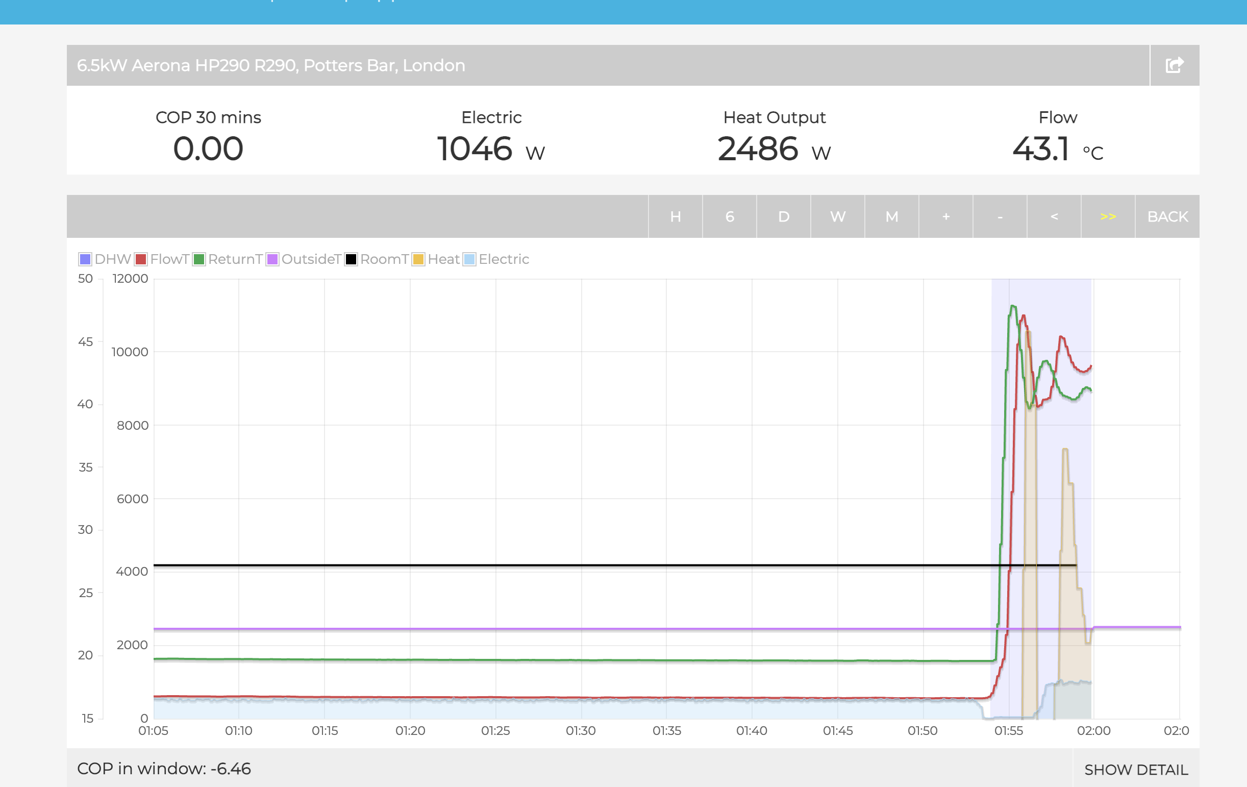

Managed to enable cooling in econet, but couldn’t get “Auto detect cooling” on MyHeatpump app (emoncms.org) to persist.
I extracted the (read/write) apikey from local emonhub config, went to https://emoncms.org/app/view?name=MyHeatpump&apikey=xxxxx, clicked the spanner, and enabled “Auto detect cooling”. Clicked on ‘Launch app’ and it shows the cooling periods, but if I refresh the page, use the readkey (as on the hub QR code), or go via heatpumpmonitor HeatpumpMonitor.org , it doesn’t show the cooling period.
Not the worst thing, but it means my local hub is showing SCOP 4.09, but HPM SCOP has now dropped to 3.99.
You need to rebuild the data by clicking on “Reload Daily Data” then Launch App on the MyHeatPump config after enabling cooling. Is your system shared on HeatPumpMonitor? If so, can you share a link? I’ll take a look
Yup - https://emoncms.org/app/view?name=MyHeatpump&readkey=3bef8848b5d49193c2f87a87d95e4629 and https://heatpumpmonitor.org/dashboard?id=876
Reload daily data gives me a popup “Failed to clear daily data”

It looks like cooling is showing correctly on HPM: https://heatpumpmonitor.org/dashboard?id=876
I noticed the monitor started showing properly last week, thanks! @glyn.hudson

It looks fine on https://emoncms.org/app/view?name=MyHeatpump&readkey=3bef8848b5d49193c2f87a87d95e4629 which is the one I look at.
But not via https://heatpumpmonitor.org/dashboard?id=876
SCOP seems to be treating the cooling SEER as a positive, although the window COP still goes negative
