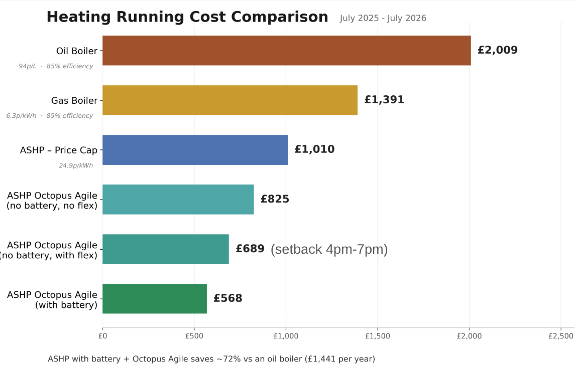

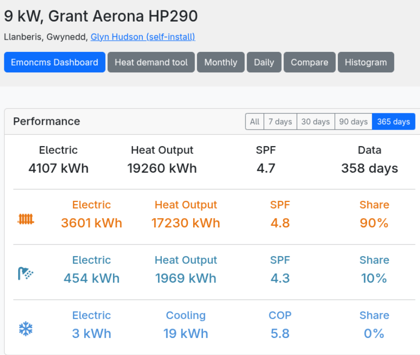

It’s now been over a year since I installed a Grant Aerona HP290 heat pump in my house to replace an Oil combi boiler, I’ve recently published a video update about the performance so far:
TLDR: it’s working well, house is warm and costs much less than oil :smiley:
System on HPM: https://heatpumpmonitor.org/system/view?id=748
