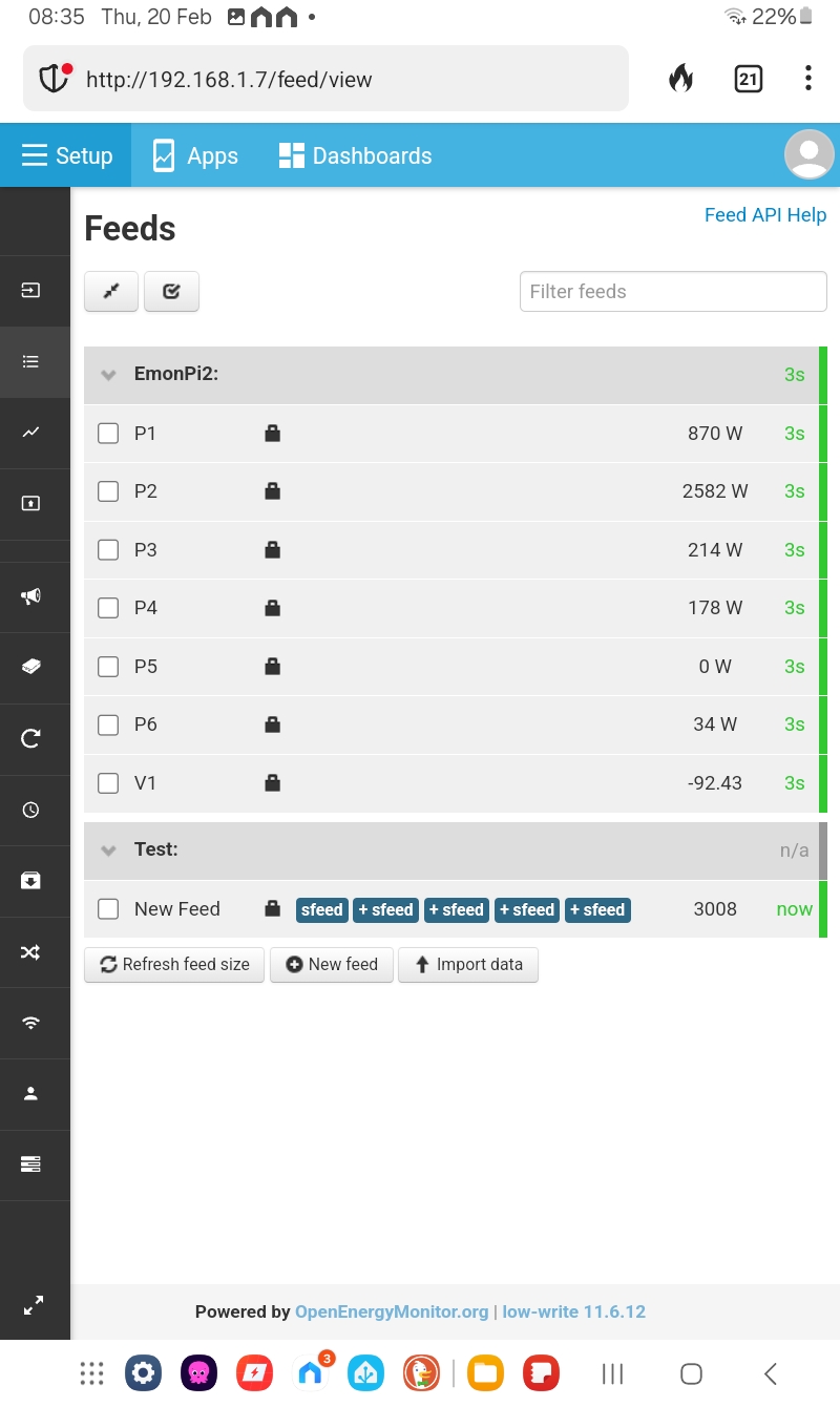

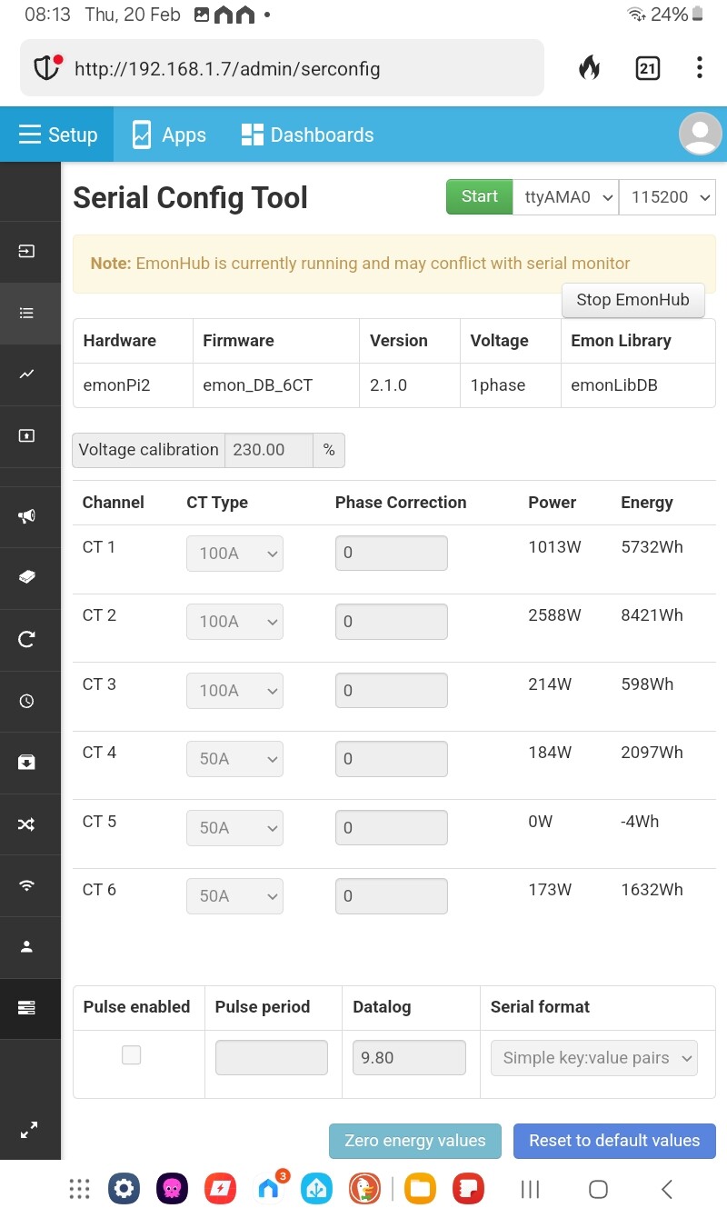

When looking af the screen, it shows ct1 value much lower than ct2. We have checked and rechecked that the ct clips are all in the right place etc.
Software and firmware updated 19th feb 2025. Version showing ā€˜low write 11.6.12’

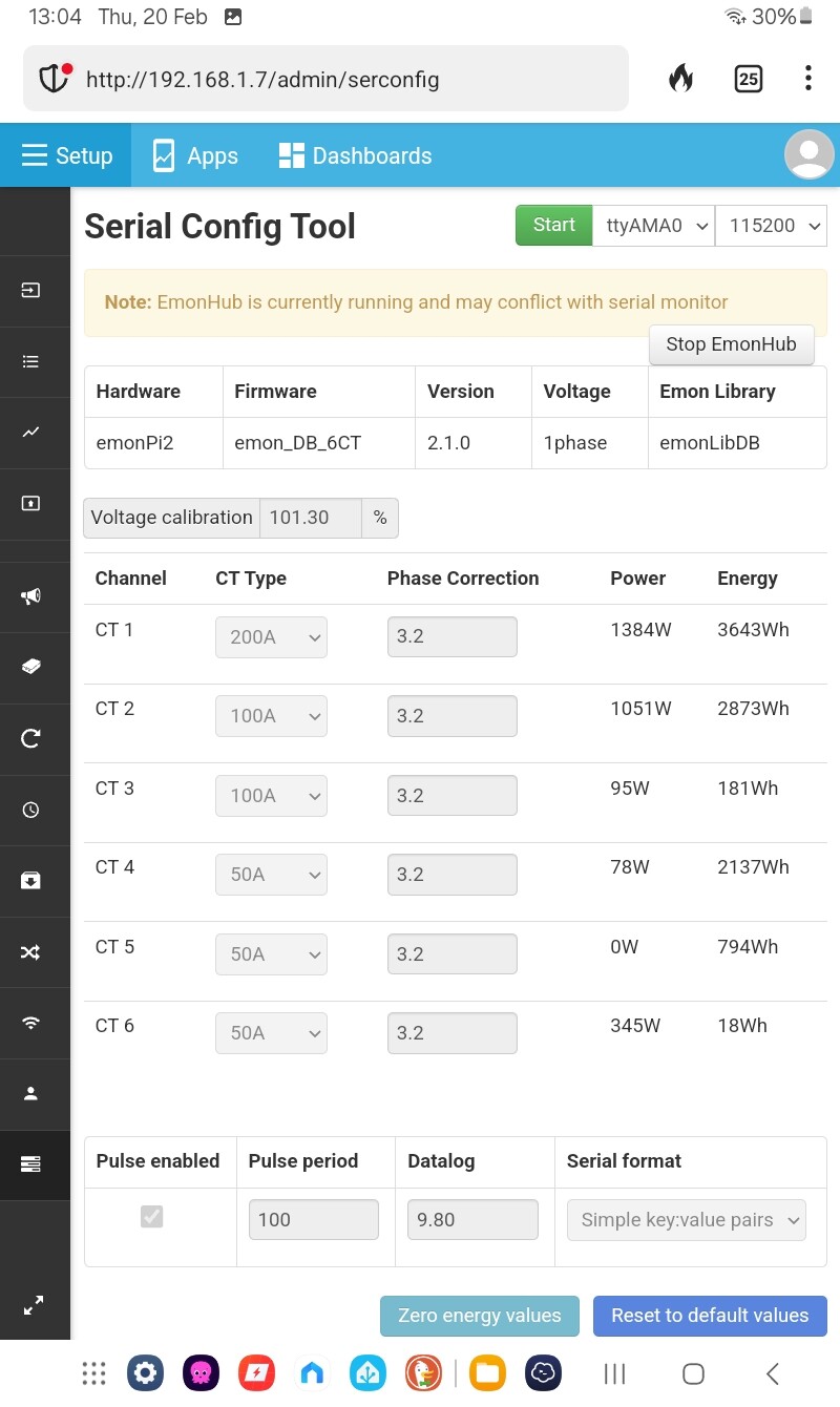

Your calibration settings in emonCMS Serial Config Tool are wrong.
You need the numbers in the ā€œCT Typeā€ column to match the rating of the c.t., not the actual current.
[Explanation: The output of the c.t. is 0.333 V at the rated current. The number you set in ā€˜CT Type’ then scales this to amps, so that it reads correctly. I’m assuming you bought your c.t’s from our Shop.]

Comparing your picture of the Serial Config Tool with the one in the Docs
https://docs.openenergymonitor.org/emonpi2/install.html#ct-calibration-selection
You have the voltage calibration (near the top of the picture) set at 230.00 %. This is a % setting, not a voltage. The Docs page has it set at 101.30 %, which I think is the correct default value in the firmware.
The value of 230.00% may also explain why the your feed picture shows a value of -92.43 volts for V1. This should be equal to your mains voltage, i.e around 240V. I’m not sure where the minus sign has come from, unless it 's an artifact of the calculations with the 230.00% calibration. If the voltage calibration is incorrect, the power and energy values measured will be wrong too, as power is an average of the instantaneous (volts x amps).
Also the Docs page shows the phase correction values for all types of ct as 3.2 rather than the zero that you have. I don’t think this will make much difference to the measured results.
Some of the above might help …
There should never be a need to change this, provided the power supply & voltage reference source for your emonPi2 is an emonVS.

Did you change that? Why? Let’s see what numbers you get when you correct this. The numbers on the Feeds page are meaningless until we know what input processing you have, but I suspect the -92 V is overflow in the maths (when writing the library, it never occurred to me that anyone would change the voltage calibration by more than a few percent, because it should never need changing - not even for use with 120 V mains supplies). The Inputs page is far more useful when looking for problems with inputs - it’s the second stage in the process where the input numbers are available for checking, the first being the emonHub log.

Okay. Starting with the first problem i went back into the serial config screen and notice things missing. So stopped hub, started serial and noticed there was a factory reset. Pressed it and yep that worked
Even put in the phase corrections.
All these displays and the inputs, including v1, are showing the right(ish) figures and are acceptable.

You need to set those up on the Inputs page. Are you familiar with this or do you need some help? What do you want to record, so that you can display the values later?

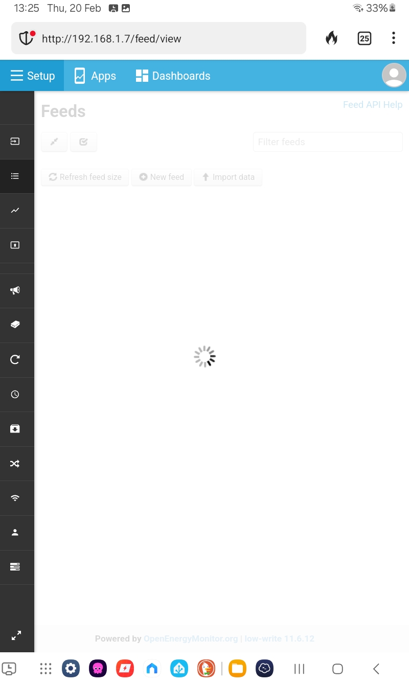

The feeds where set up, before and look like they where working, just wrong figures. So i re-read the guide and noticed a tip about input settings. So i deleted the bits i had set up and then clicked the cog, and chose emonpi2. Unticked the e entries as i only have ct clips.
Came out and tried to look at feeds and got the following
So went back to inputs, pressed cog, went to emonpi2 and noticed a delete, so did that. Back to feeds same problem
Looked the problem up and it indicates a factory reset, by issue command. So looked up how to get in. Went to box and enabled ssh. Then came the problem of userid/password.

I can set up under input screen, but it states i already have a feed created, so i can only add to the listing, nor can i display the feeds screen
Edit - and i can not get rid of the feeds that where set up by the tip.
A search said to reset emonpi2 back to factor settkngs to resolve problem. After that ll need to reimage it
Do you mean it says no feeds are set up, or is it like your screenshot above?
Screen shot above
That needs to be sorted out first. I’d suggest a controlled power-down - or a reboot of the Pi from the Admin page, and see if it clears before going for a full reset.
Did a shutdown from screen, went out and when i came back in to turned the plug off/on to power it back up. Still same results.
