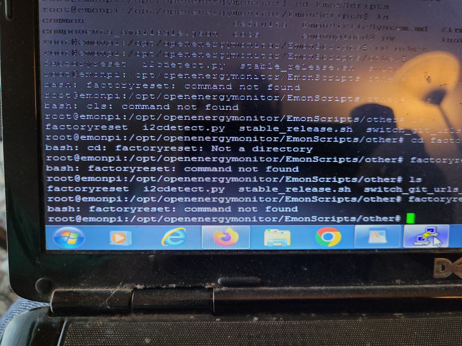

https://docs.openenergymonitor.org/emoncms/troubleshooting.html#factory-reset

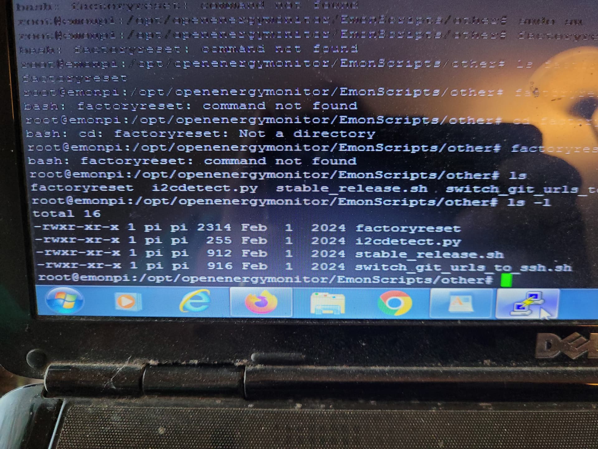

Yep found that. In the directory, unable to execute command
Have you got root privileges (sudo su)? What’s in that directory?
Yes have root as per screen shot

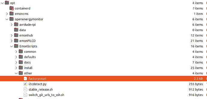

Not much help, they must have moved it. But it’s there in my Feb 24 download image when I mount it.
I get the same listing,
So not sure why.

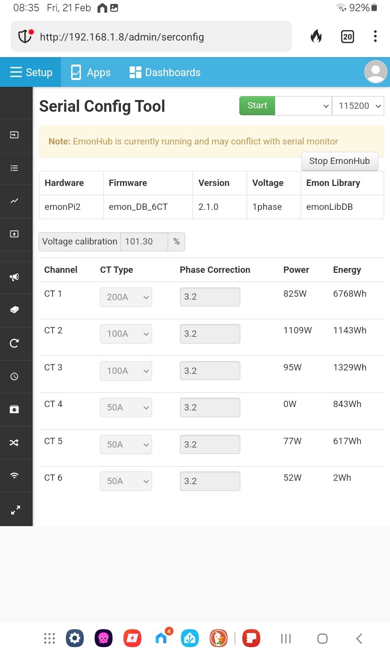

Ps going back to display of inputs on emonpi2. Its again showing p2 greater than p1, yet p1 matches the figure i expected.

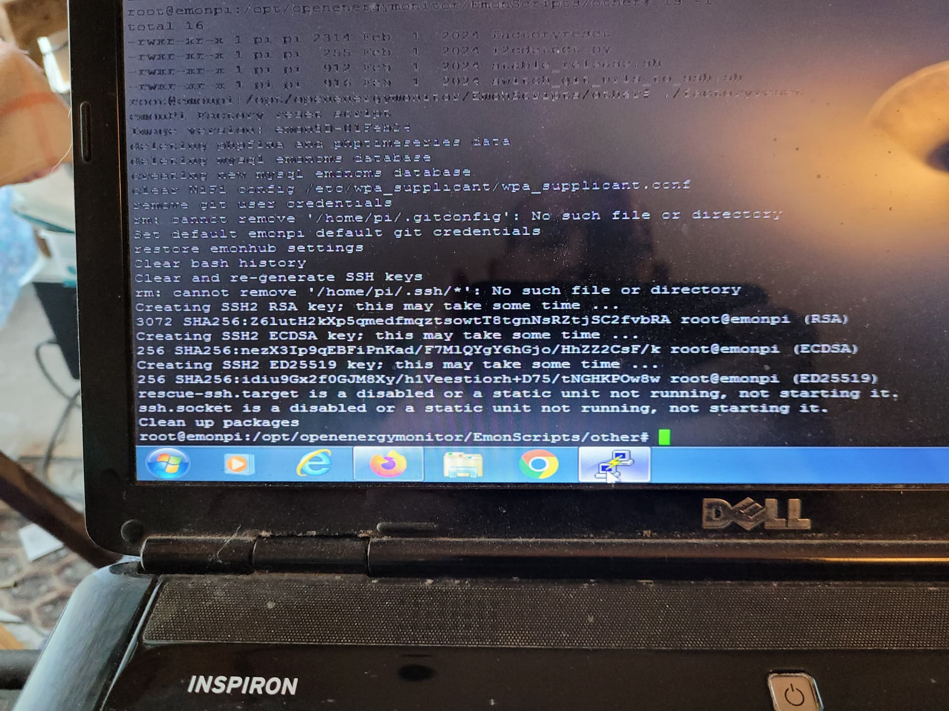

Try running ./factoryreset
I haven’t got anything spare I can try it on at the moment.
Yet that was it. Resetting now and finished
Will shut down and reboot then check what i have.
It needed to know “this directory”. It was looking in the path.

So now i am back on and have updated the software to 11.6.12 i am still seeing p2 usage higher than p1 usage
And yes we have checked the ct clips. They are on the right wires and pointing in the right direction.
Ct1/p1 is clipped on the main leads into the cu, and does show the correct results.
Ct2/p2 is clipped on a feed to another cu and should be less than p1
Ct3,4,5,6 are all feeds to various circuits, so the totals of ct2-6 should addup to ct1
Sorry, found it. We ran some load test to see which changed. Found p2 and p6 had been labelled up wrong way round.
Therefore p6 has a 100amp ct clip, but listed as 50 and p2 had a 50amp clip labelled as 100amp.
Will monitor but it looks okay now.

I knew the rating of CT2 couldn’t be what you thought it was, but you couldn’t do anything about it until all the other problems were solved.
Thank you @Robert.Wall for your help and understanding. Things are working fine
