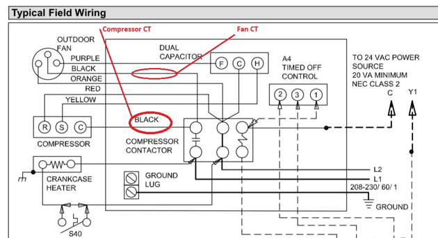

If the fan stops working the high pressure switch (labeled S4 in your diagram)
should kill the power to the contactor coil, which will kill the power to the compressor.
Clogged condenser coils will do the same thing, i.e. cause a high pressure switch trip.

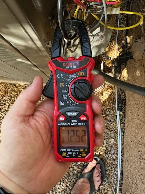

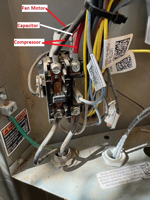

First I placed the Compressor CT around the Red and Yellow wires, and the Fan CT around the Purple and Orange wires. The results were both read around 1 amp when running - strange as I was expecting the compressor to read higher.

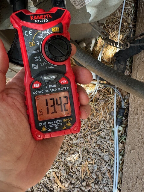

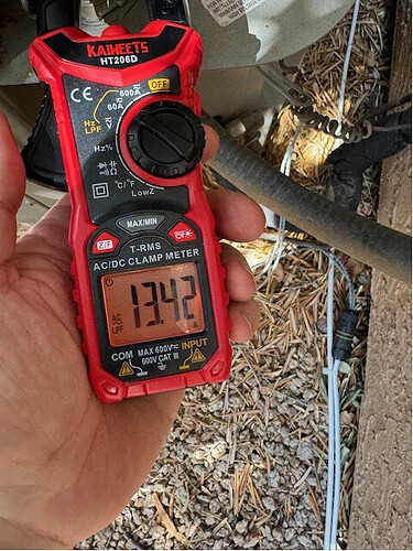

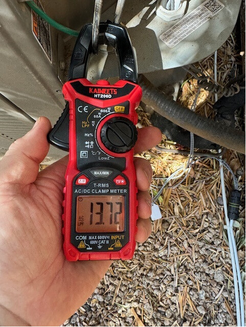

Next, I traced both line inputs from the Contactor and took readings on both inputs to the Contactor.
The readings on the Lines in fluctuated between 13.42 and 13.72 amps.

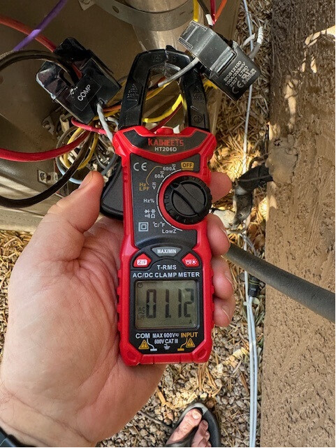

Next I placed the CTs over their respective black wires per the wiring diagram
and then took readings with my ammeter.
Compressor lead read 12.52
Fan lead read 1.12 for a total of 13.64 - pretty close to the value of the input lines.

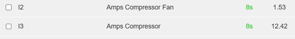

Under load, the emonPi2 read 12.42 for the compressor and 1.53 for the Fan. The fan consistently comes in higher than my ammeter readings.
However, under no load, emonPi2 still sees approx 1 amp on each of the compressor and fan CTs.
So, my original issue of not showing zero amps (or 0.5 as it shows on the unused CTs) still remains.

Bill, good point and this would negate the need for a 2nd CT.

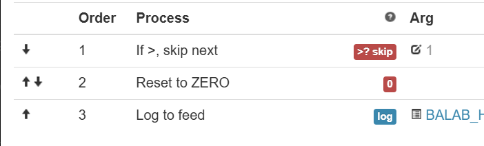

However, I still have the issue of not reading zero when the compressor isn’t running. When I measure with my ammeter, it shows zero current, when the compressor stops, yet emonPi2 still shows approx. 1 amp.
I was contemplating subtracting 1 from the current reading before it goes into the feed, but then this understates the current draw when the compressor is running. I need an if statement but not sure if I can do this in emoncms. (something like, "if current is <2, then subtract 1, if not, leave as is).

Right. Just wanted to point out that you were “reinventing the wheel” so to speak WRT
the function of your 2nd CT and the HP switch.

Not flawed at all :joy:
If >, skip next   value: whatever
+                 value: -1

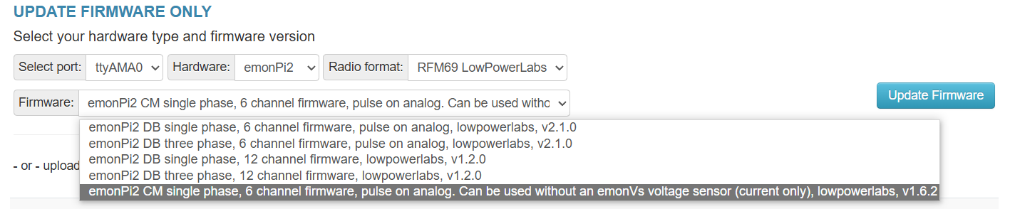

It’s counting 80 Hz cycles from somewhere - presumably ripple in the 5 V from my laptop via the USB lead.
With the emonVs providing power and a voltage reference, the ~ 63 mA from the 100 A c.t. falls to ~ 53 mA.

Trystan has since made this a standard firmware version.
I’m believe it is using emonLibCM. I’m trying to check but Serial Config is not responding.
With the same long lead, I see about 4.4 A on the 100 A c.t. with the emonVs providing a mains earth in addition to the laptop earth, and about 1.65 A with the emonVs unplugged.

I can’t recollect this being published anywhere. It seems I’m suffering a crystal ball failure.
Published here back in May :slight_smile: emonTx4, emonPi2, emonTx5 14th May 2024 firmware release
