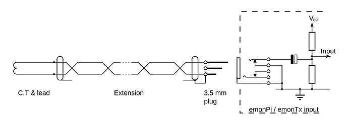

Knowing now that you have an emonPi2, and before you spend more money, I’d suggest connecting the cable screen only to the emonPi2 earth. Connect this to the plug sleeve, if that’s practical. The schematics don’t show a connection between GND and the case, so alternatively, in the absence of a 3-pole green plug (pulse/analogue input), the next best place to connect the cable screen is the GND connection in the emonVs - again assuming you have one. I don’t have an emonPi2, so I can’t check this. I do have an emonTx4 (which is essentially the same input circuit), and some long microphone cables, so tomorrow (if I have time) I’ll try a c.t. on the end of 30 m or so of cable and see what I get.
This is how you should connect the cable to an emonTx4/emonPi2:

I saw that image and the notes - but it mentions nothing about the lay-up of the cable. Is the whole lot twisted or not? I’ve mentioned “twisted” several times - believe it or not, this is important.

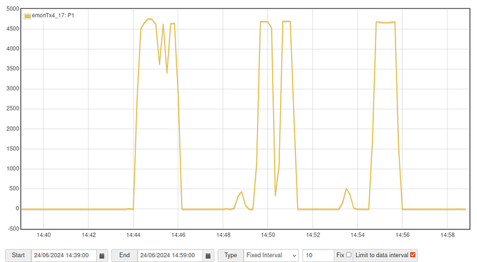

I have connected a voltage-output c.t. from The Shop to an emonTx4, using an emonVs as its power supply. The c.t. is on my c.t. test rig, set to give about 4.6 kW indicated with 1 A indicated (10 At in the c.t.).
First test: Connected via a “short” (3 m) microphone cable and a 3.5mm to ¼" adapter cable. Result: Zero power for zero current, 4.6 kW at 1 A.
Second test: add a 24 m microphone extension lead: Result: Zero power for zero current, 4.6 kW at 1 A.
Third test: add a 18 m microphone extension lead: Result: Zero power for zero current, 4.6 kW at 1 A.
Fourth test: add a 16 m microphone extension lead (total: 61 m): Result: -1, 0 or +1 W recorded for zero current, 4.6 kW at 1 A.
And the “zero” power with 61 m of cable:
So I don’t seem to be able to replicate your problem with what I have at my disposal.

@Robert.Wall, am I reading this diagram correctly?
When the 3,5mm plug is inserted into the emon unit, the red and green lines I drew are the points of contact - correct?
What I circled in yellow suggests that the shielding connects to the green line, which ultimately goes to the ground. I am not using an emon-VS, so I was thinking of connecting the shield to the emonPi2 case, but the case does not appear to be connected to any ground circuitry. Can I use the GND pin circled in the picture below?
Lastly, below are the connectors that I am using at both ends of the LAN cable to connect the 3.5mm plug and CT (basically I cut the existing CT cable and reconnected them to both ends of the LAN cable). I connected the shielding to the 3rd position (shown with the line).
I plan to connect the shield at the emonPi2 end to the GND pin shown above, once I hear back from you.
Thanks,
Gordon
Yes, correct. This is how jack plugs & sockets are drawn.
Yes - that is what I had in mind.
Conventionally, pin 3 of your 270° 5-pin DIN connector is ground, so that’s correct.
Go ahead and connect to the GND pin on the green socket.
