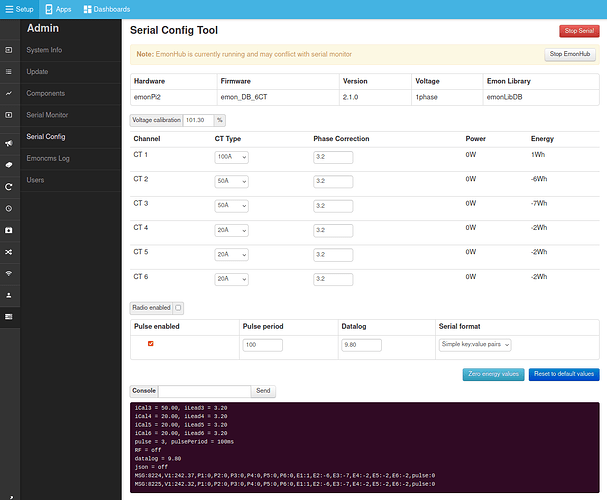

Emoncms Serial Config tool
As part of this firmware update, there is also an update to the Emoncms Serial Config tool used to set CT sensor calibration values among other settings. If you need to use this tool please update Emoncms to the latest version (currently 11.5.4).
This is what the new version of this tool looks like:
When used with the latest firmware loaded to the device, it now shows the hardware variant, base firmware, firmware version, 1phase/3phase, emon library etc. This information is all printed clearly by the new firmware so that it can be picked up by the serial config tool.
It is also possible now to change the pulse period, datalog period and serial data format from the user interface. Radio settings can also be changed on the emonTx4 and emonTx5 but are hidden when an emonPi2 is connected as the Pi handles these separately via emonHub.
I’ve also updated the serial configuration calibration format for emonLibCM based firmwares to use the same approach as emonLibDB. E.g to calibrate CT1 to be a 20A CT sensor with phase correction of 3.2 degrees, the underlying serial command for both emonLibCM and emonLibDB based firmwares now looks like this:
k1 20.0 3.2
If you are used to entering these manually this is just something to watch out for. The serial config tool handles this for you otherwise.
The serial configuration tool has also been updated at Serial Monitor.

Is the serial config tool backward compatible? Can you fully define ‘latest’ - release date/version? Does this just add UI functionality that was previously available via the CLI?
Ah, that isn’t good IMHO.
The alternative is a whole load of messy code unfortunately. My rationale here was that folk who have already setup their systems on a particular firmware won’t need to use this tool. The times this tool is used is during significant reconfiguration and these points are a good time to update firmware.
The tool still allows fallback to written command configuration, which is also documented.
The command format is mostly the same, there are just a few small differences in what is printed, il post and example shortly
I think this should be very clearly stated at the top of the page, that the UI tool only works with Firmware and Hardware X otherwise the CLI interface must be used.
Ah :slight_smile: I did think about this, the tool detects older firmware and gives a clear warning message and instructions to start the command line process if required:

There is now a bit more consistency in the format of the printed settings, including printed firmware and hardware details. Settings or configuration to be picked up by the tool needs to follow the format:
key = value
This is to distinguish from data that is passed through, which follows either:
key: value,
or json:
{"key":value}
The actual serial commands are all the same, the change is only in the way the configuration are printed back from the device.
