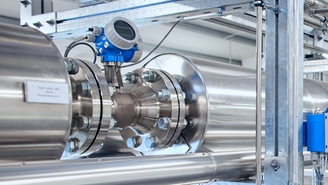

It depends. For instance here is an Endress+Hauser vortex meter video that works in the way as I expected. The bluff body is fixed and a sensor further downstream detects the vortices.
