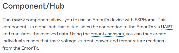

Here’s the doc for the already implemented features.

A quick comment on this :slight_smile: .
Where you have “'Create individual sensors” this should perhaps be “create sensors for HomeAssistant that track…” - as these definitions only really work with HA.
Could you please add “This component can also be used to send data to an emoncms (link) system via HTTP” [and MQTT eventually]. Working directly with emoncms seamlessly is a key benefit!
[edit]
A link to the http component page would probably be useful too :slight_smile:
I’d be inclined to turn your http/emoncms note into a section as an example configuration for emoncms so it the appears in the left menu? This may break their doc structure so nothing more than a suggestion.

what about the latest version ?
Hope, I’ve implemented all your recommandations properly :smiley:
