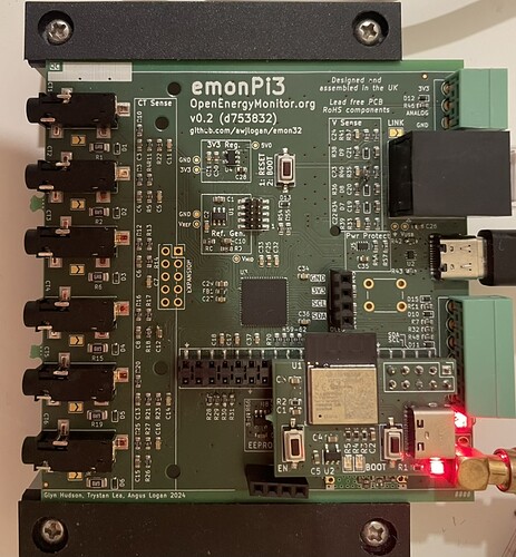

Hi @FredM67 - yes, I think it would be useful. I’ve got a design made up with an ESP32-C3 that just fits on to the normal Raspberry Pi header with power and UART. I haven’t had time to put much effort into the ESPHome setup for it, so it’s rather languished (and honestly I don’t really enjoy working with frameworks!).
There are two options for the Tx5 and the incoming Tx6 - key:value data, or JSON. I was hoping to use ESPHome to digest the JSON output, seemed most straightforward. Configuration of the Tx is all through the UART.
In terms of documentation, probably the best thing to look at is the source code. For the Tx4/5, it’s here for 6 CT inputs. Line 28 describes the formats. Configuration options are here.
For the upcoming Tx6/Pi3, the output will be the same and you can see the configuration options on line 936 here.
Let me know if you would like one of the ESP32 boards and if you have any other queries/suggestions :slight_smile:

Hi Fred - here’s an image of the adaptor board connected to one of the emonPi3 prototypes.
I don’t know enough about the HA integration side to comment too much on the data that’s available and how it’s parsed. For example, the emonPi3 will always output all the voltage and CT channels, even if they are inactive, as 0 is still a valid value. If the HA integration can filter out values that are known to be unused, that would be best - is that the first option you presented?
