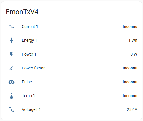

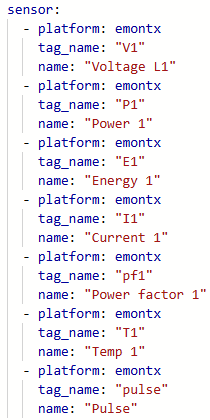

Here’s the very simple yaml file I use (boilerplate stuff not shown):
And here what I get:
“Inconnu” means “unknown”. These are sensors my old emontx4 does not deliver.
I’ve defined default parameters for each sensor depending on the prefix/pattern. This can be overwritten by the user.
If someone wants to play with this component, here’s what needs to be defined in the yaml:

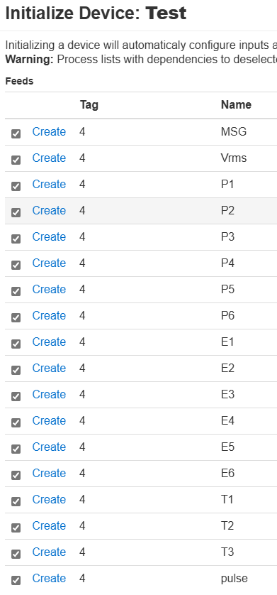

Btw, I’ve found that the pre-def device for EmonTx4 is wrong on Emoncms.
I don’t know how it looks like on a single phase firmware, but at least for 3 phases, it’s Vx and not Vrms. (already mentioned the discrepancy in the source code).
