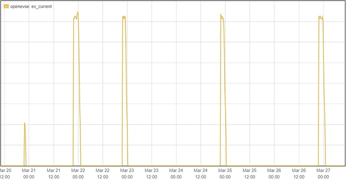

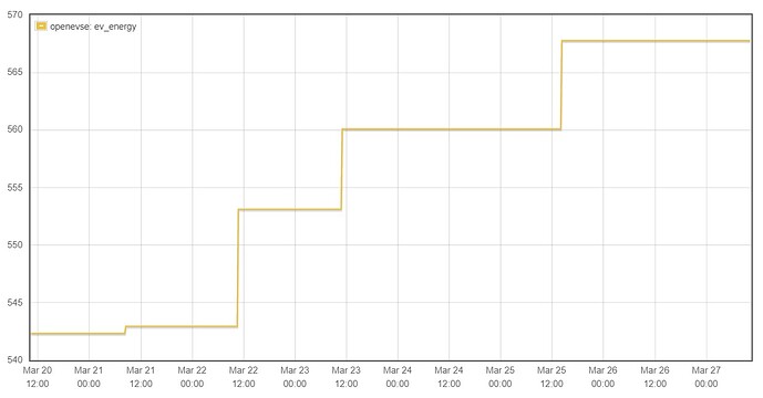

I seem to have found an issue, after charging the next day when I remove the charge cable the system use to report how much charge was put into the car. This is now not happening. However if I power-cycle the EVSE it then reports the charge. Any clues? As you can see although there was a charge on the 27th the total charge did not increase
John

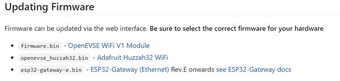

went back to the V3.2.2 WiFi firmware and the daily charge is reporting OK again when the charge cable is removed . One question I have which is the correct version of the firmware for the current WiFi board I have OpenEVSE WiFi Gateway V3.x EP32­wifi V3.x as the one I used was the firmware.bin shown below as it looks like there is a new WiFi board on the shop site for V4

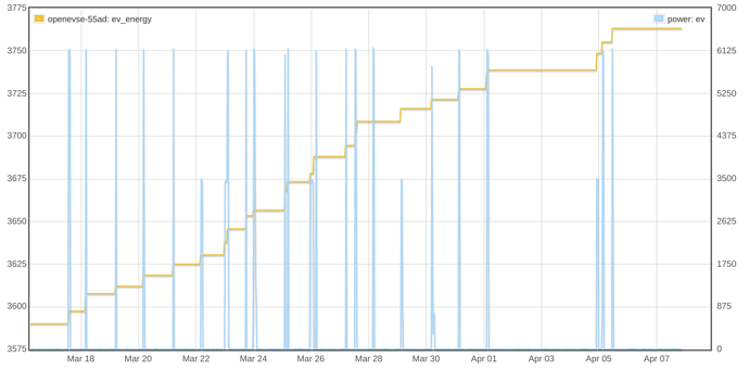

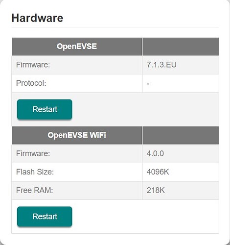

Mmm interesting, I’ve been running V4.0.0 for a number of months now and I’m unable to replicate this issue. The Energy is reporting correctly, I can’t see any charging sessions that have been missed. What controller FW are you running?

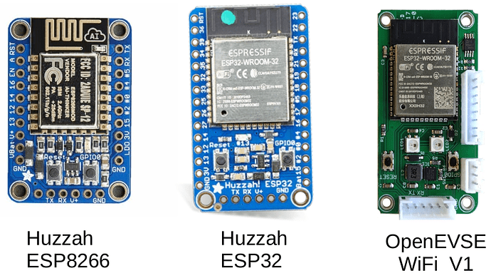

If you will almost certainly have a Huzzah32 WiFi module, but the only way to be certain is to take a look at the hardware inside your unit
The Huzzah 32 can run V4.0.0 but make sure you select the compiled version for the huzzah.
I’ve added a note to the docs on how to identify WiFi module hardware and which FW versions each WiFi module will support: GitHub - OpenEVSE/openevse_esp32_firmware: OpenEVSE V4 WiFi gateway using ESP32
