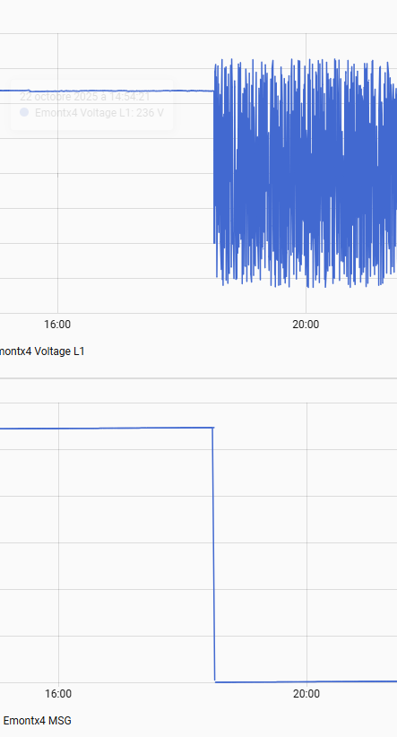

A couple of minutes ago, I started to see errors and strange things in Home Assistant and on emoncms.org.

Monitoring the serial with VSCode, I see now that instead of getting an output every 9.80 seconds, I get on full line every 0.5 seconds !!
See a piece of output with timestamp:

The output itself does not seem to be corrupt, so the corruption is due to the esp32 probably because too much data is being sent.
This “timing bug” just happened without any reboot, no power loss, see historical data for MSG in the picture.
At the time I write this thread, my EmonTx4 runs fluently again since the 24th of July 21:17.

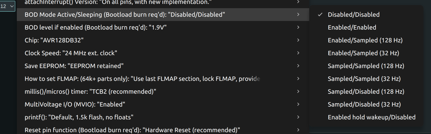

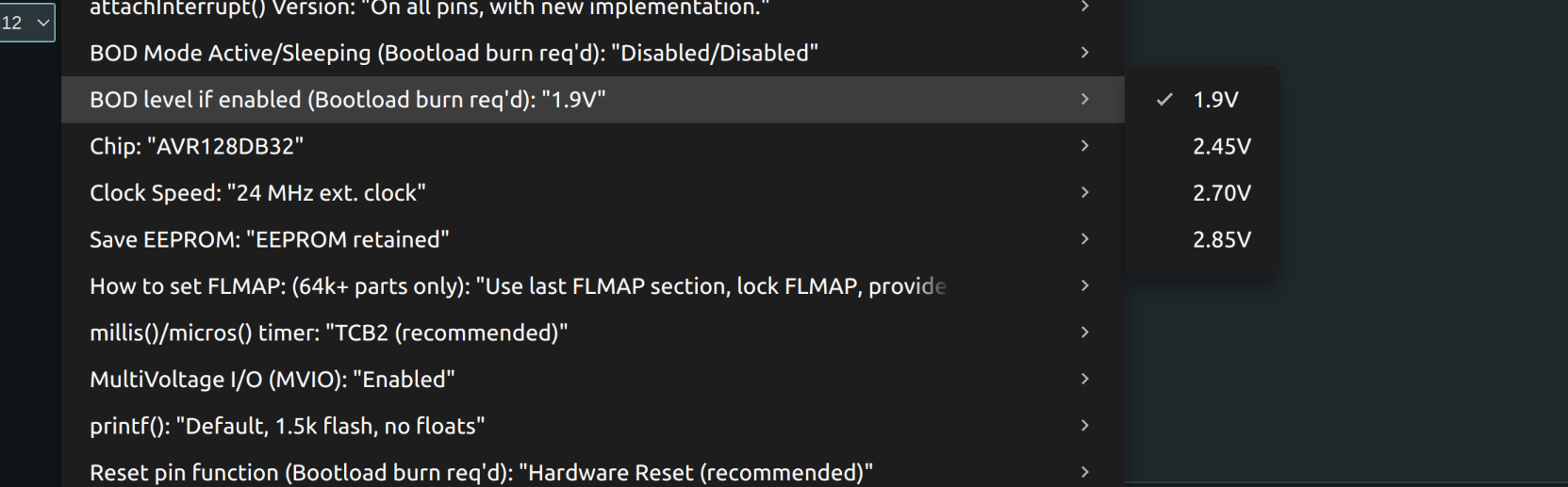

There are a couple of BOD related options when compiling AVR-DB firmware e.g:
and:
but could the issue you are experiencing be a fault with your emonVs perhaps rather than the BOD?

A software mitigation might be to check the last reset source and if it was done by the BOD (RSTFR.BORF == 1) then delay for a short time (say 100 ms) before doing anything. This would allow the power supply to settle before proceeding or, if it’s falling, to power off without doing any accesses.
For the Tx6/Pi3, the SAMD’s BOD is more sophisticated. At startup, the BOD level is set high but does not assert reset - once the supply rises above the BOD level, the reset is made active and execution continues. This is needed to prevent corruption of the flash, particularly when using the fast clock. See the source for more context.
Well, I can try to enable the BOD and set the level to 2.85V…. as long as I find out how to do that without “breaking” my tx4, lol.
Will I need to remove the emonWifi module for these experimentations ?
Fred
I would check what the existing setting is first - I’m not too familiar with Arduino, but you might be able to do something like:
Serial.print(F("BODCFG = 0x"));
Serial.println(FUSE.BODCFG, HEX);
Note, that fuse bits are inverted (i.e. 1 → not set) - best to feed it into one of the fuse decoders if you’re unsure. The value for the BOD config is described in section 8.8.2.2 of the AVR128DB’s datasheet.

Well, that suggests the BOD is indeed disabled. I would definitely recommend enabling it as we discussed above. A bit of a pain you can’t enable it through firmware.
To change the fuses, you’ll need to upload the Arduino bootloader again through the UDPI header.
