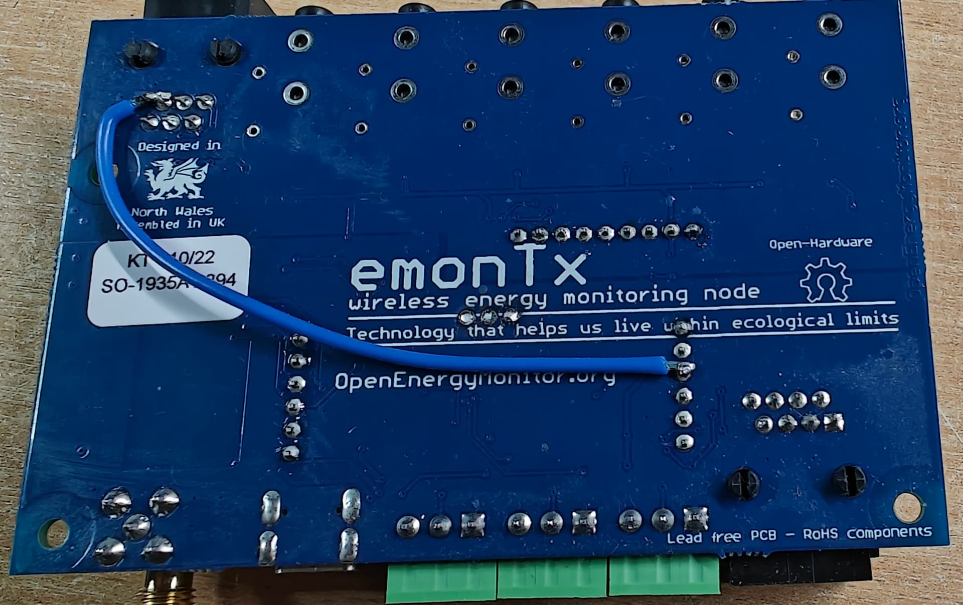

Well, so I’ll have to disassemble it… and probably solder a couple of pin headers, right?
Surgery done… what next ?

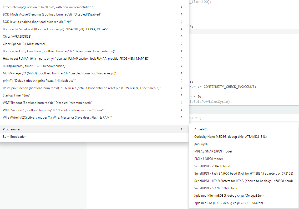

Oh man, there’re so many options ! I fear to break my emontx !

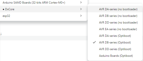

Is that right, or should I select “no bootloarder” ?
There’re tons of settings in each sub-menu, and also what Programmer should I select?
Fred
@Robert.Wall is the person for this…
Oh, sorry @FredM67 , I’d completely forgotten about this - away on holiday! You need to select the SerialUPDI programmer here.
- BOD mode active
- BOD level 3 (2.85 V)
- Bootloader serial I think should be PB0 and PB1
- printf needs float support
Otherwise I think the defaults are fine ![]()

Well, it looks like it’s worse than I imagined.
It seems, the UPDI pin does not connect to the corresponding pin on the AVR.
I’ve checked all 3 pins (3.3V, UPDI, GND), both power pins are ok, but not the UPDI.
It should be - I can see it on the board render. It can be hard to check the connection to the microcontroller package, so it seems unlikely but that the programmer doesn’t find it suggests there is a problem. It’s directly connected, there’s no extra resistor.
