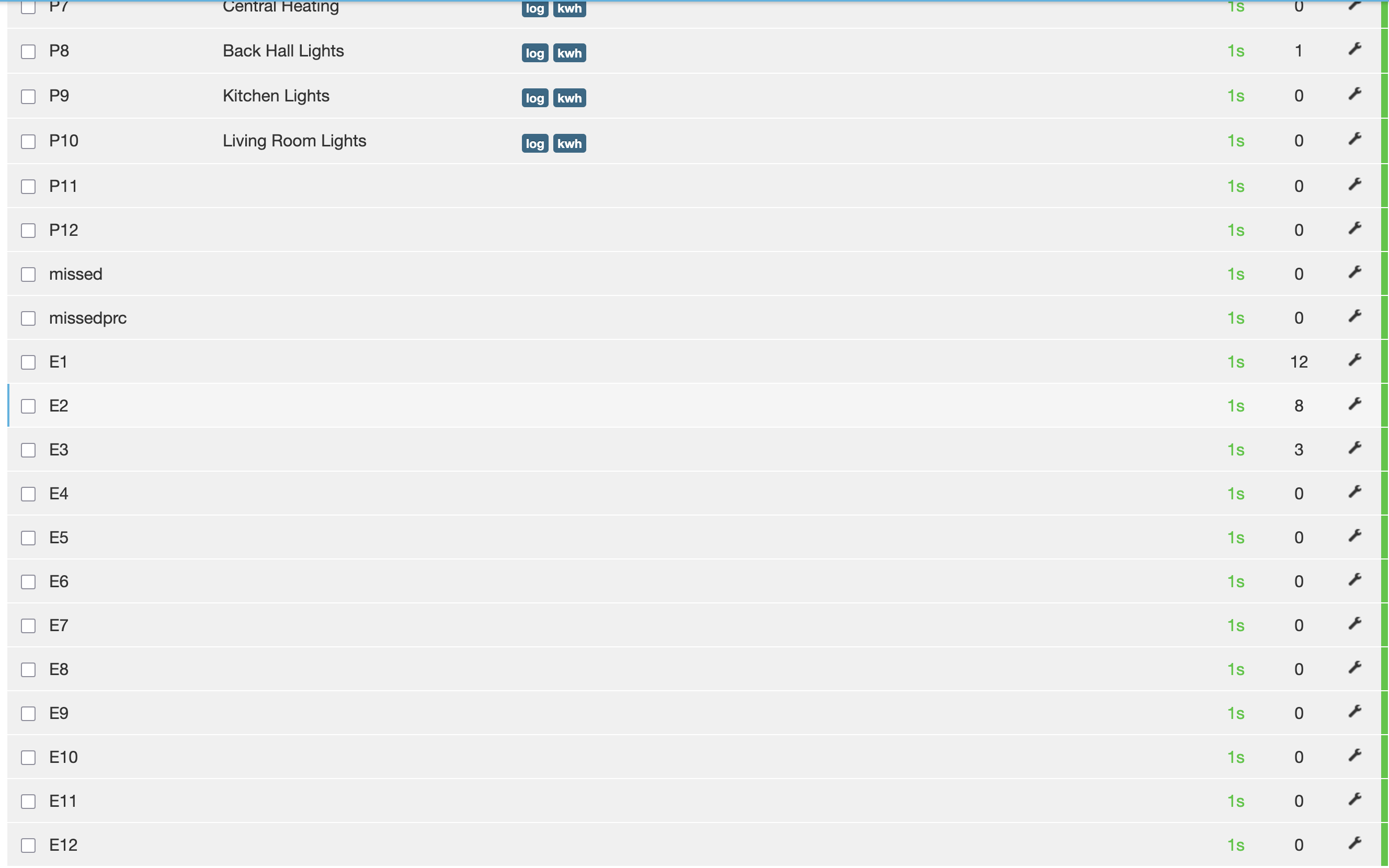

Hi all,
I have an EmonPi2 along with 4x EmonTx. The EmonPi is the 12CT variant, however I’ve noticed when initialising the device with the 12CT firmware, the E1-6 and E7-12 are not populating values from the firmware.
When I flash it with the 6CT firmware the E1-6 populate and calculate the kWh as expected, I found another topic - but specific to the EmonTx with the same issue - however, the advice was to move the EmonTx from USB to RF input to the EmonPi, obviously I don’t have that option for the built-in expansion board.
How might I make the EmonPi populate all E1-6 and E7-12 energy attributes from the 12CT firmware?

Looking at the source code for the sketch, it should be, if it’s been compiled with ENABLE_ENERGY defined. I don’t know (and I’ve never found where it’s documented) what the options chosen for the pre-compiled versions are.
This is one for @TrystanLea to answer.
If you want to recompile and upload it, the line to change is 35 - just uncomment it.

I think the key difference here is RF is on in your example, and off in mine due to it being embedded in the EmonPi. As per this answer: Tx4 CT6 not sending Energy data - #7 by TrystanLea
Have you actually read the source code? Please explain to me how having R.F. on or off affects adding the energy output to the JSON string.
Did you recompile and upload your new version of the front-end sketch, or just reload the pre-compiled version that does not have ENABLE_ENERGY defined?
The pre-compiled firmware matches the source code, it is commented out and so the energy values are not printed. For the emonTx4 with an ESP8266 WiFi module the length of the line made a difference for reliability. It’s probably fine to un-comment and print these on the emonPi2.

I found a fix for PlatformIO - it needed a build flag added in the platformio.ini config - amended to be:
build_flags = -DTWI_USING_WIRE1 -DUSING_OPTIBOOT  ; Upload via uart
With that -DTWI_USING_WIRE1 and running pio run it builds as expected, grabbed the firmware.hex from the build folder, uploaded through the Web UI and seeing all 12 Energy parameters!
