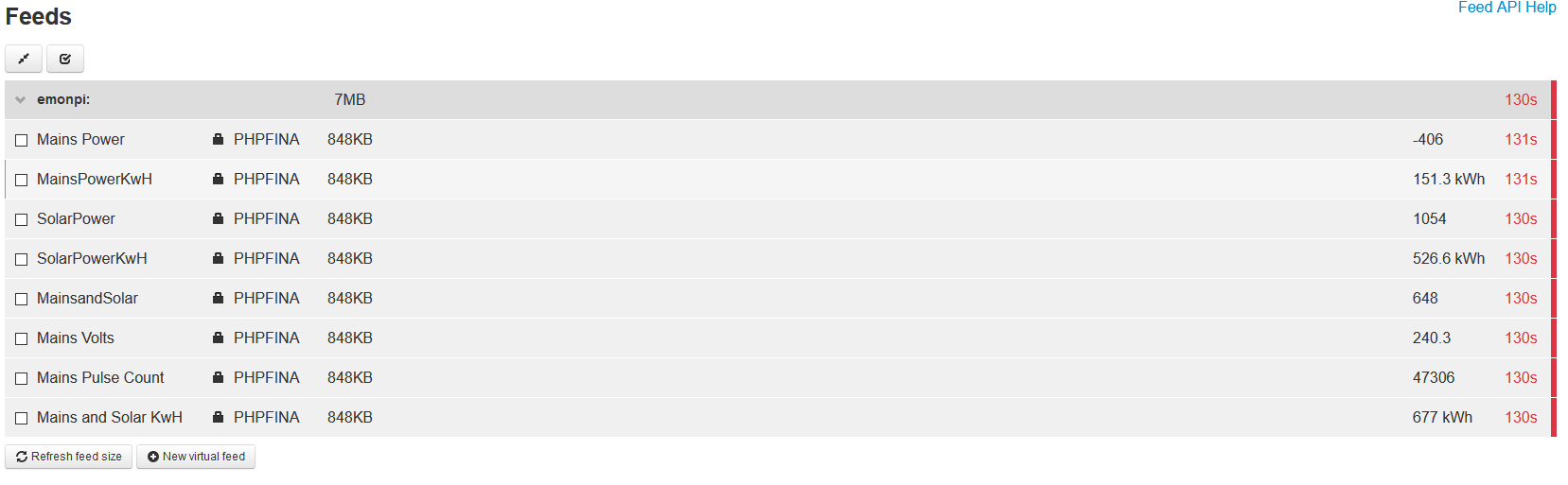

Wratty
(Justin)
36
pi@emonpi:~ $ nano /var/www/emoncms/settings.php
pi@emonpi:~ $ sudo systemctl restart emoncms_mqtt.service
pi@emonpi:~ $ sudo reboot
emonhub.txt (31.7 KB)
That looks to update regularly - alas still the same in the inputs and feeds

Can you post the emoncms log from the admin page please.
Wratty
(Justin)
38
emoncms.txt (303.1 KB)
Thanks for all your help fella - sorry for being such a pain
borpin
(Brian Orpin)
39
The log shows the data is received and that the feeds are being updated.
Can you open the emoncms page in a private window please and check input and feeds again please.
Do your services status look like this?

Wratty
(Justin)
40
Private window = same
