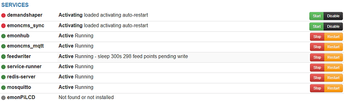

Hi,
Somehow, I don’t get emoncms_sync to run.
Clicking on “Start” does not do anything !
System is up-to-date.

Well, after going deeper, here’s what I see:
Jun 26 12:01:13 FreeboxVM systemd[1]: Started emoncms_sync service.
Jun 26 12:01:13 FreeboxVM emoncms_sync[3329]: PHP Warning:  include(Modules/sync/sync_model.php): failed to open stream: No such file or directory in /opt/emoncms/modules/sync/sync_upload.php on line 21
Jun 26 12:01:13 FreeboxVM emoncms_sync[3329]: Warning: include(Modules/sync/sync_model.php): failed to open stream: No such file or directory in /opt/emoncms/modules/sync/sync_upload.php on line 21
Jun 26 12:01:13 FreeboxVM emoncms_sync[3329]: PHP Warning:  include(): Failed opening 'Modules/sync/sync_model.php' for inclusion (include_path='.:/usr/share/php') in /opt/emoncms/modules/sync/sync_upload.php on line 21
Jun 26 12:01:13 FreeboxVM emoncms_sync[3329]: Warning: include(): Failed opening 'Modules/sync/sync_model.php' for inclusion (include_path='.:/usr/share/php') in /opt/emoncms/modules/sync/sync_upload.php on line 21
Jun 26 12:01:13 FreeboxVM emoncms_sync[3329]: PHP Fatal error:  Uncaught Error: Class 'Sync' not found in /opt/emoncms/modules/sync/sync_upload.php:22
Jun 26 12:01:13 FreeboxVM emoncms_sync[3329]: Stack trace:
Jun 26 12:01:13 FreeboxVM emoncms_sync[3329]: #0 {main}
Jun 26 12:01:13 FreeboxVM emoncms_sync[3329]:   thrown in /opt/emoncms/modules/sync/sync_upload.php on line 22
Jun 26 12:01:13 FreeboxVM emoncms_sync[3329]: Fatal error: Uncaught Error: Class 'Sync' not found in /opt/emoncms/modules/sync/sync_upload.php:22
Jun 26 12:01:13 FreeboxVM systemd[1]: emoncms_sync.service: Main process exited, code=exited, status=255/EXCEPTION
Jun 26 12:01:13 FreeboxVM systemd[1]: emoncms_sync.service: Failed with result 'exit-code'.

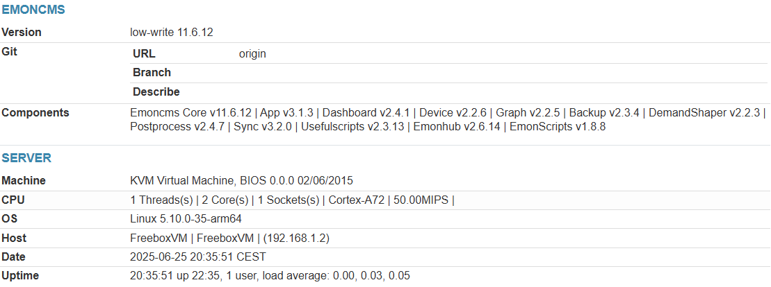

It’s installed on a virtual machine running on my internet provider box :smiley:
The OS is Debian 5.10.237-1.
