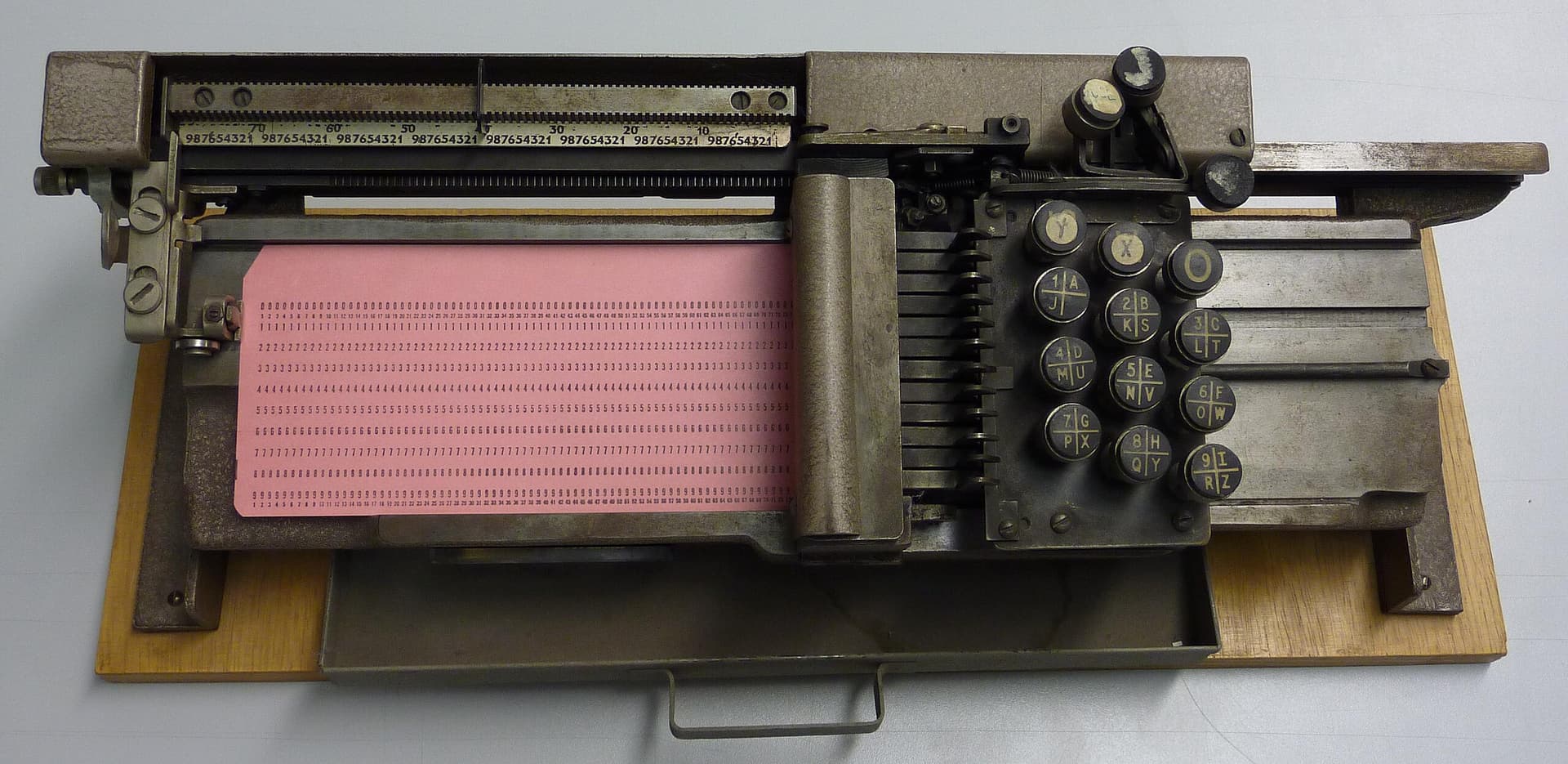

I can beat that - Fortran 4.
:anguished:
Oh happy days… :wink:
That’s good, you win.
@Robert.Wall oh no, wait
