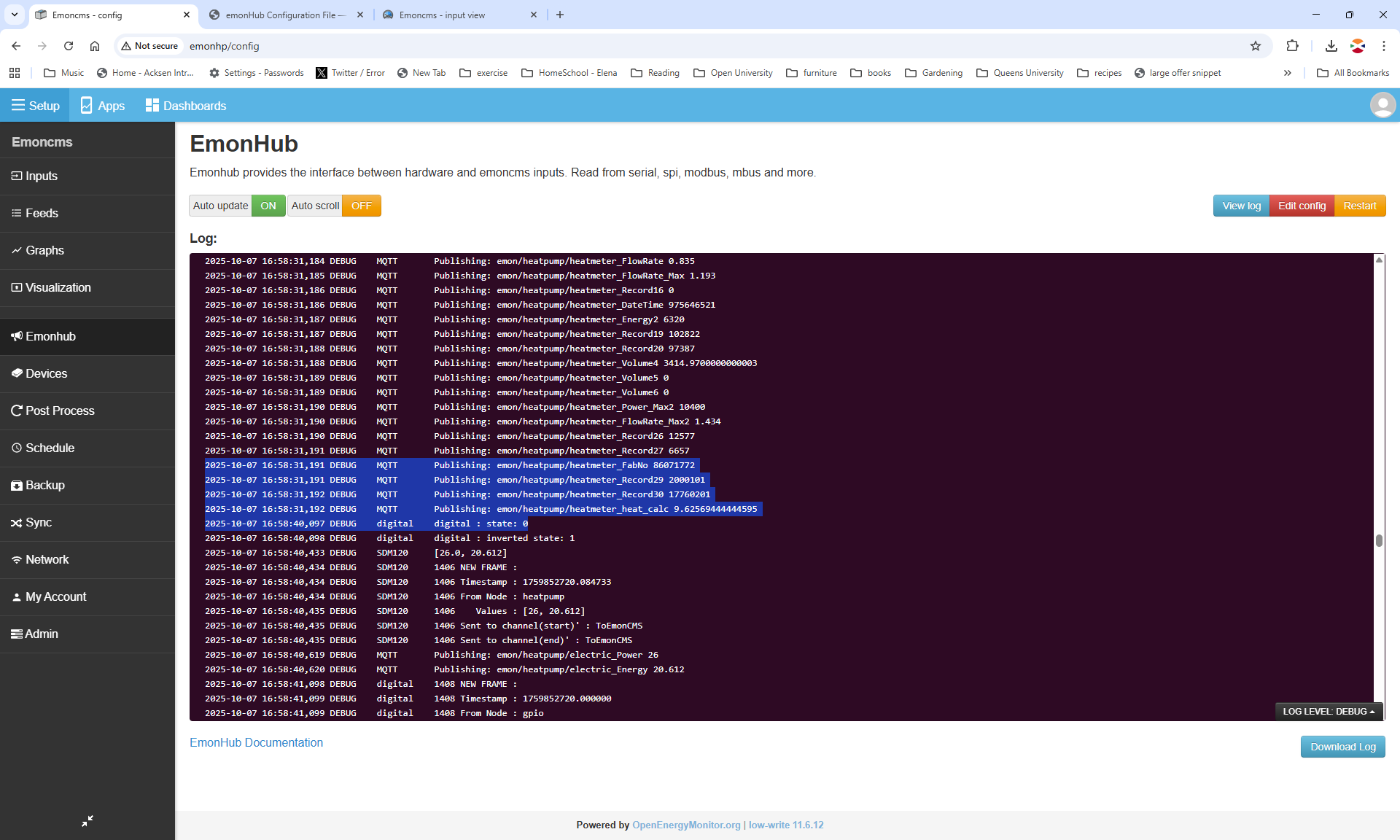

Thanks, it looks like because i did not order the DHW input sensor, then the heatpump_dhw input was not enabled on my device,…. so i need to create one, that is, create a new input heatpump_dhw,… and i have no idea how to do that. Furthermore, I have been trying to input/post and can’t get it to work, neither work?

Gwil, my sensor will simply give a binary/logic 1 (3v3) when the DHW motor is active, conversely it will give a logic 0 (0V) when inactive.
This will be fed into the DHW input on the top of the emonHP…
I have been able to log into my local emonhp by typing http://emonhp !

That is the same behaviour as the DHW status sensor we use - so you should be able to wire it into a pluggable terminal block and put it into the ‘DHW‘ input on top of the emonHP. The input should appear automatically.
OK Gwil,… I will try. BUT Glyn had said:-
No, since there wasn’t a DHW status sensor ordered as part of your bundle, the heatpump_dhw Feed won’t be present. But you can create your own if you want. You can see the list of Input and Feeds by logging into your https://emoncms.org account with username
Now I understand that he was referring to feeds,…. but i was asking about inputs,… Let’s see if it appears automatically if I toggle the DHW input.
Gwil,… OK if i toggle the DHW input 3v3 to 0V i see the “digital : state: 0” change to “digital : state: 1” on the EmonHub,…. but i do not see an associated input being created on my local device?
Am i correct that the digital input is used for DHW?
Could you take a screenshot of the inputs page? Also take a screenshot of where you are seeing this:
