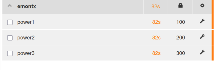

Hi, I’ve been trying to input/post to my emonHP,… I tried the format in the help
http://emonpi.local/input/post?node=mynode&fulljson={“power1”:100,“power2”:200,“power3”:300}
But apparently the help is wrong and it should have been https, which I tried, (which represents the limit of my expertise) but that didn’t work either. I welcome any help on this.
Ultimately i need to create an new input “heatpump_dhw” this did not come configured on my emonHP, as I had not ordered the DHW input device (as I want to make my own),…. In light of the hassle i’m starting to regret this.
If you’re not inside the RPi in the Heatpump monitor, you need your APIkey as well. Look lower down the Input API Help page, where it says “To post data from a remote device you will need to include in the request url your write apikey.”
And http works for me (Firefox browser)

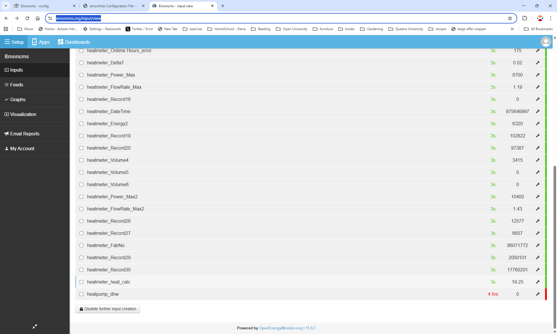

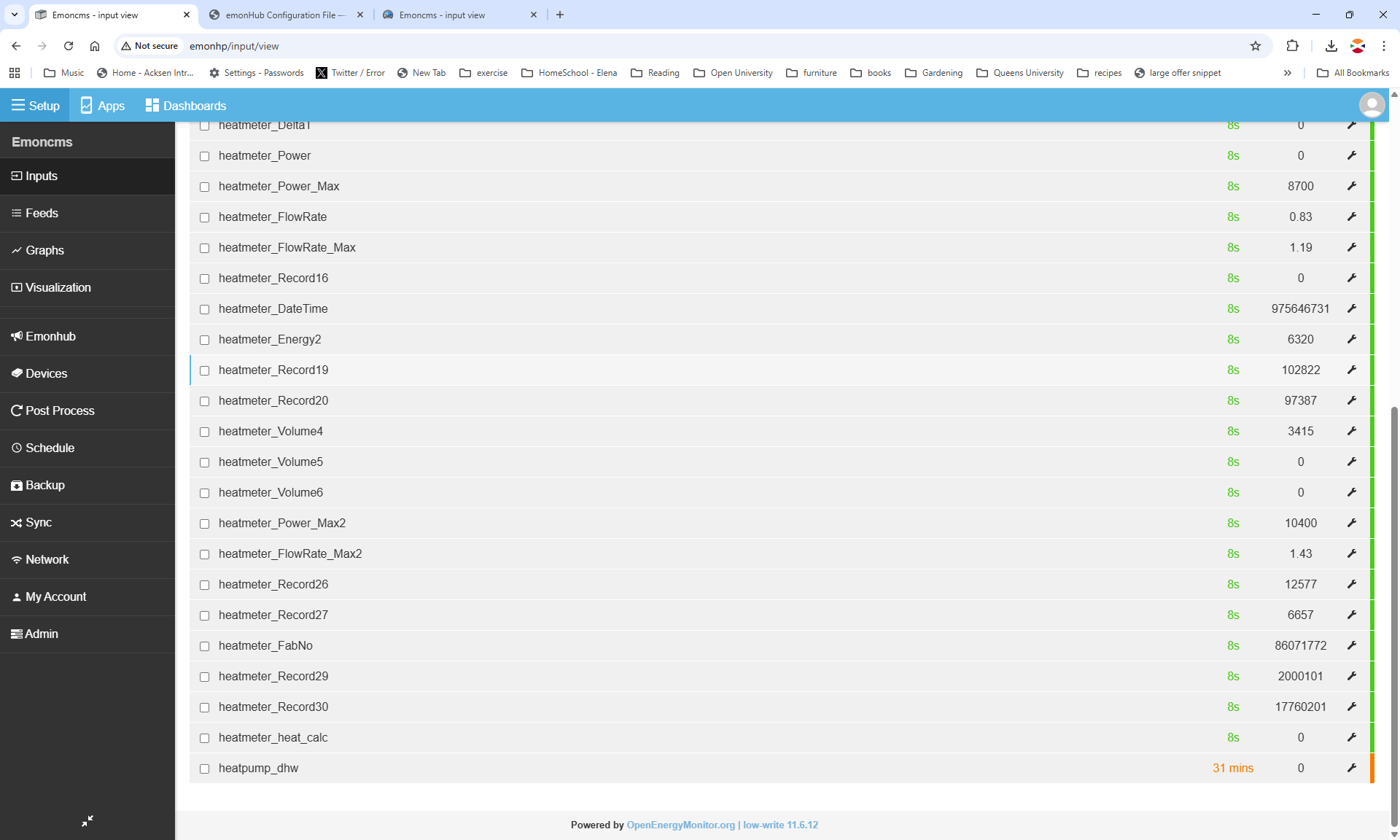

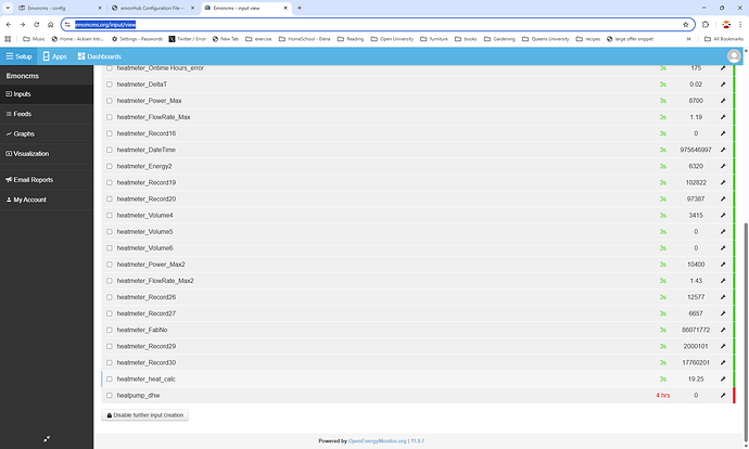

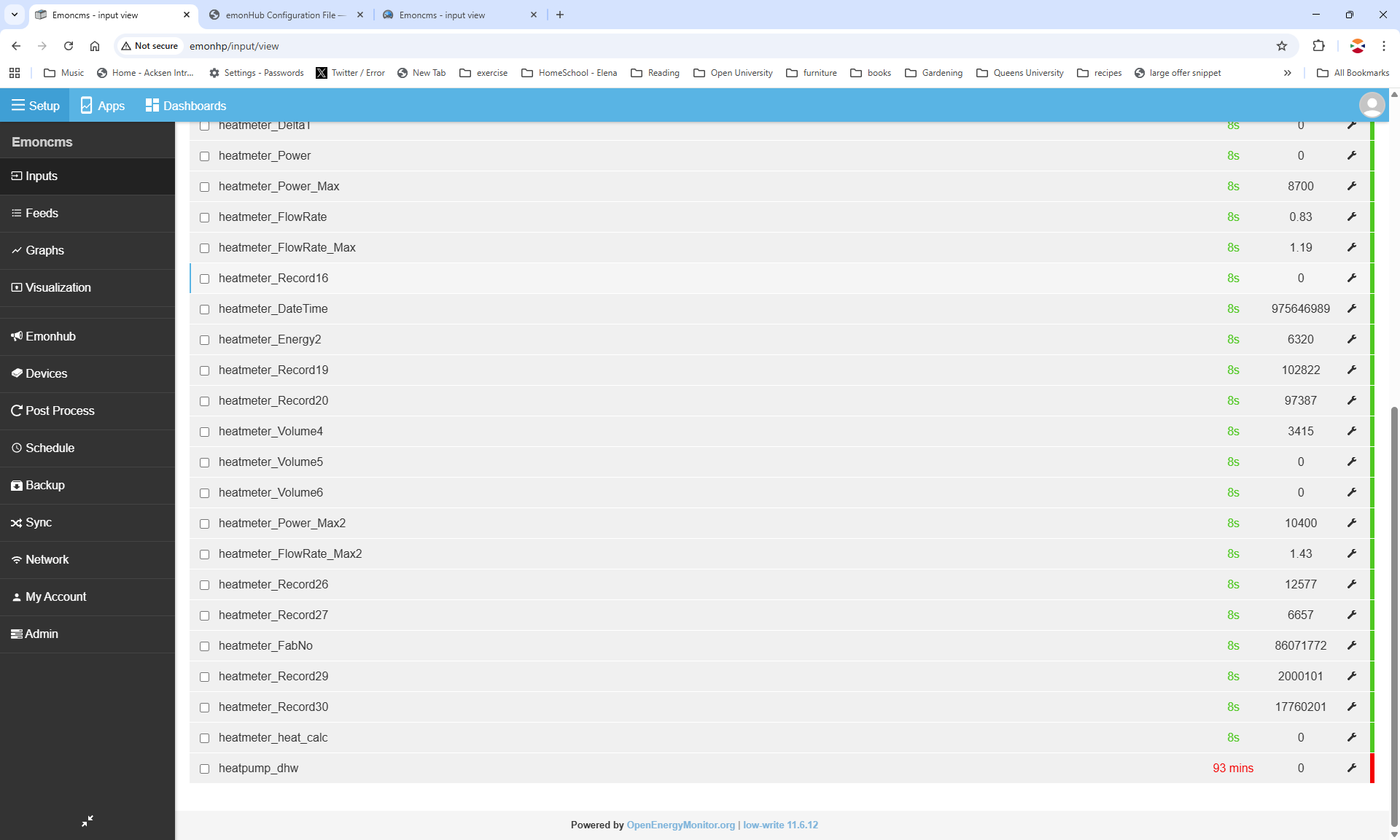

On emoncms I am able to create an input, heatpump_dhw,…. but it receives no data.
I can also log into my emonHP locally. I was able to create an input heatpump_dhw, see the screenshot, it receives no data.

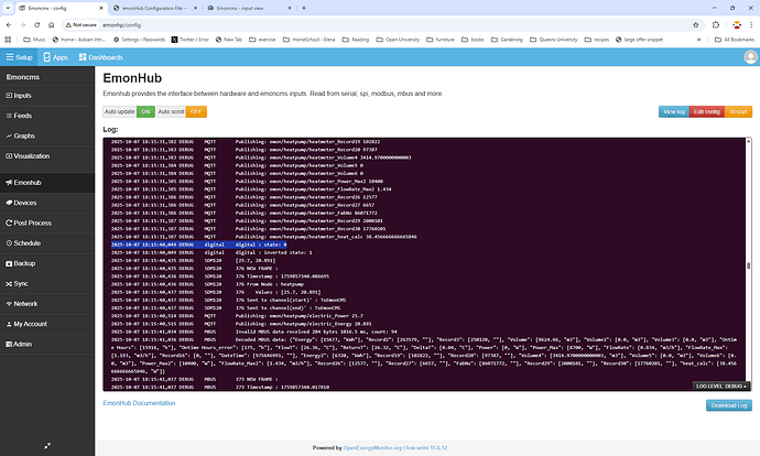

If in electrically (in hardware) toggle the DHW input (3v3 logic 1 to 0v logic 0) on the top of my emonHP unit, on emonHub I can see a digital change listed in the process. E.G.
2025-10-07 18:15:40,049 DEBUG digital digital : state: 0
2025-10-07 18:15:40,049 DEBUG digital digital : state: 1
I’m guessing this is the DHW input. If it is, how do i link that hardware input to the ‘input I created (heatpump_dhw) and get the emonhp or emonhub to publish that?

Look at the whole list of inputs. Is there one called ‘GPIO’ or ‘pin15’, or something like that?

That’s the emonHub log. It shows the data is getting as far as emonHub. What you need now is to go back to post no.9 and read again how the data travels through from the physical input to the Inputs page. What do you think might be missing? Answer: an Interfacer that interprets the stuff appearing in the emonHub log and converts it into “emonCMS-speak” which the Input page can interpret. If you’ve connected to a RPi pin, t may well be the Digital Input Interfacer (emonhub/src/interfacers/EmonHubDigitalInputInterfacer.py at master · openenergymonitor/emonhub · GitHub which is where you find the commands to put in your emonhub.conf file) but I don’t know the pin number you need to put in the config.
Is @Gwil suggesting it’s pin 15?
Yes I see it, ( emon/gpio/pin15 1 ) Are you stating that this is the hardware I/O linked to the DHW input on the top of the emonhp?
Yes, that is the DHW input.
