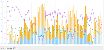

With this data we can actually see exactly what is going on. E.g system EOH0567 (Dashboard):
That’s a lot of short cycling and the flow temperature control is all over the place! :smile: There’s lots of examples like this and worse in the data, very high flow temps, poor modulation, oversizing etc. There’s probably a lot of potential for improvement with simple weather compensation curve adjustment.

EOH0470: The best performing 11kw Ecodan (picked as closest to mine) had a decent first winter (COP 3.7) yet the second winter was awful (2.8).
Note how much less heat is produced in that second winter, never reaching 90 kWh per day. Wonder if the occupants were cold.
