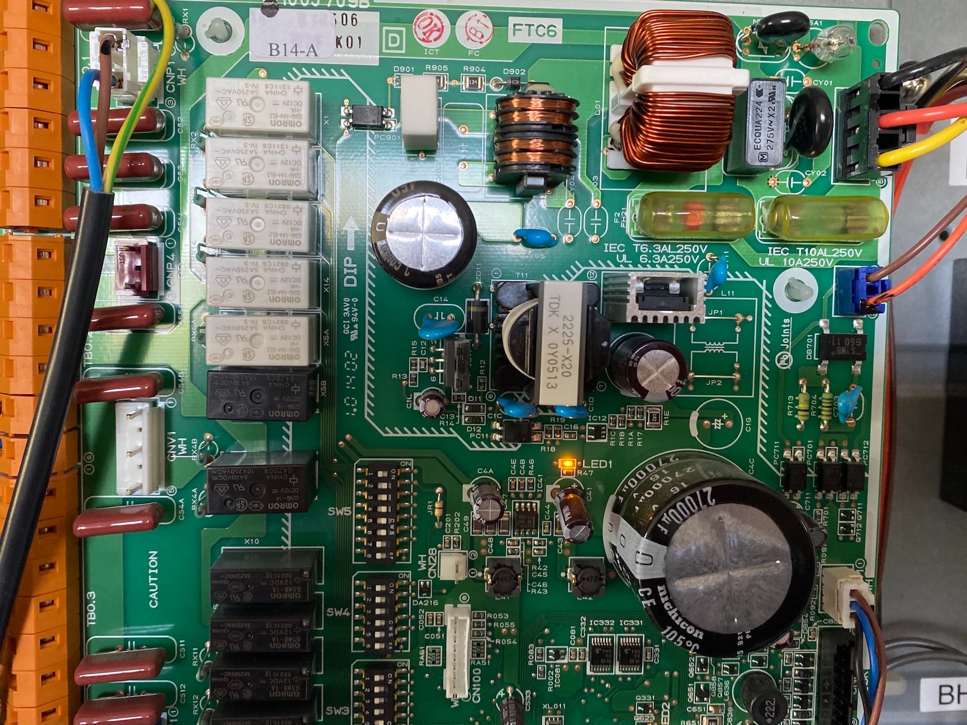

Forgive my ancient addled brain, but I am getting more and more confused as to what I can control.
Firstly a correction: my circuit board states FTC6 and not FTC 5

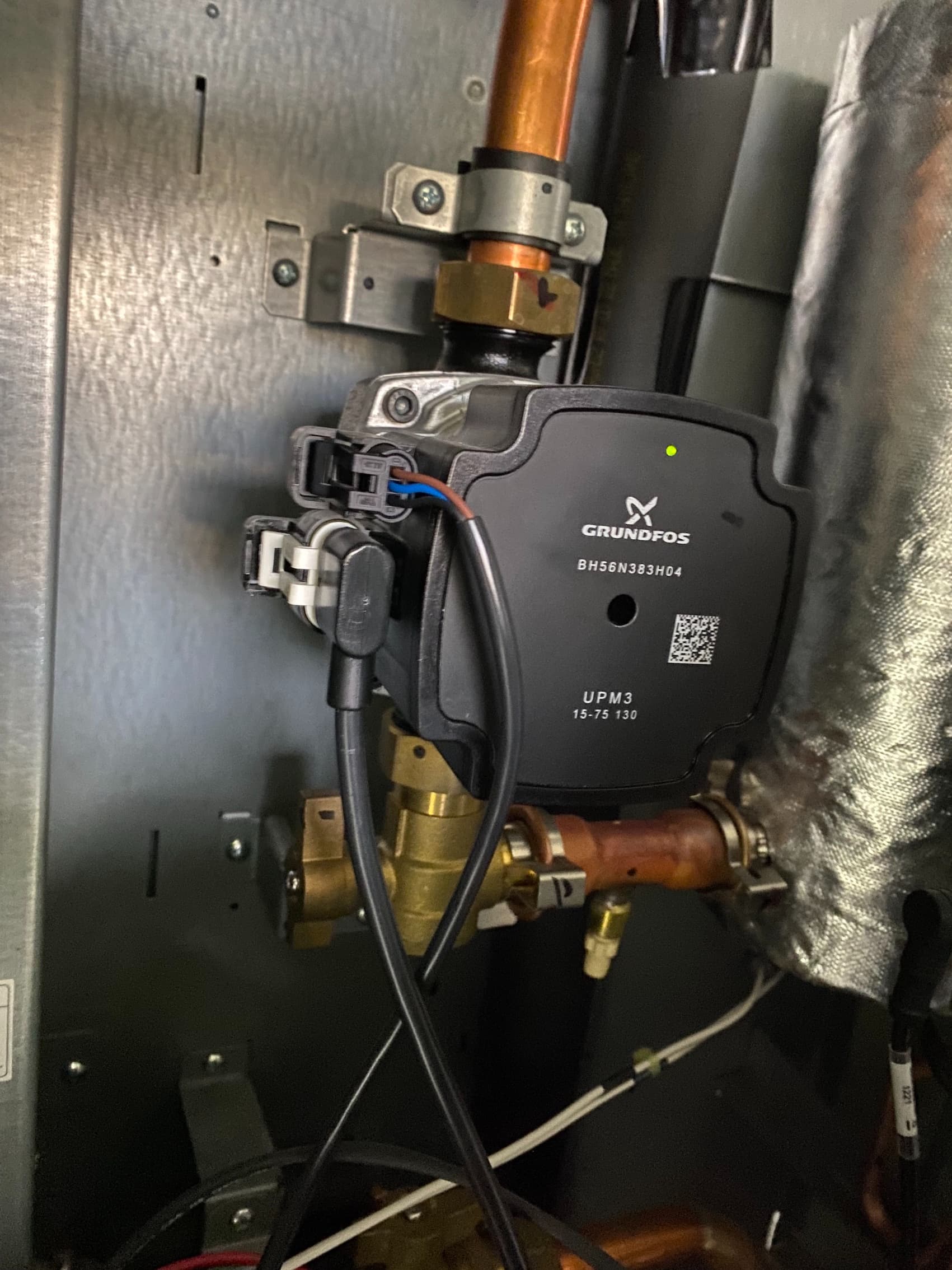

So I have Grundfoss UPM3 which appears to have its Mains and PWM cables connected to CNP1 & CNPWM respectively.
Are we saying that with this, as supplied setup, the 0 to 5 speed setting on the controller, for CH and DHW has no effect whatsoever? (I have to admit that I have not been able to detect a difference in speed by ear).
Some means of varying flow, i.e. speed control, is fundamental to my proposed change to a single pump system with no buffer tank
I believe that the FTC6 can control the primary pump speed via PWM so you should be able to set a different speed for heating and hot water. One way to check is to change the pump speed setting on the controller and then check the flow rate using code 540 in the running information screen.

Thanks Dan. Most helpful My results: Setting 3 = 14l/min. Setting 5 = 20l/min.

Interesting - the PWM output on my FTC6 controller does nothing at all!

With pump settings 1 to 5 I got flow figures of 8;11;14;17 &19 respectively. Contrary to what I previously said, I could hear the difference when changing from higher to lower, e.g. with 3 to 1 it almost sounds as though the pump has stopped.

My unit has the pump speed setting available and it does control the pump. When I’m on setting 5 it still doesn’t give me a lot of flow. My dT is around 10 around freezing temperatures, and I really want to lower that by increasing the flow rate.
The max flow is 27 liter per minute (according to the specs of the indoor unit), but I only get 21 liters per minute (probably piping, height resistance, etc).
The water pump is a Grundfos UMP3K 15-75-130. My outdoor unit supports a flow between 18 and 37 liters per minute, according to the specs.
I see that there are other indoor units that have the exact same water pump, but according to the specs of those units they have a max flow of 35 liters per minute. When I look up the specs of the water pump on the website of Grundfos, the max flow of my pump should be much higher than the 27 liters (or even the 35) per minute.
I think the pump speed is still restricted, even when it is on speed 5. Unplugging the CNPWM doesn’t set the water pump on max performance either.
Do you think there is a way I can increase the flow rate with a PWM?
