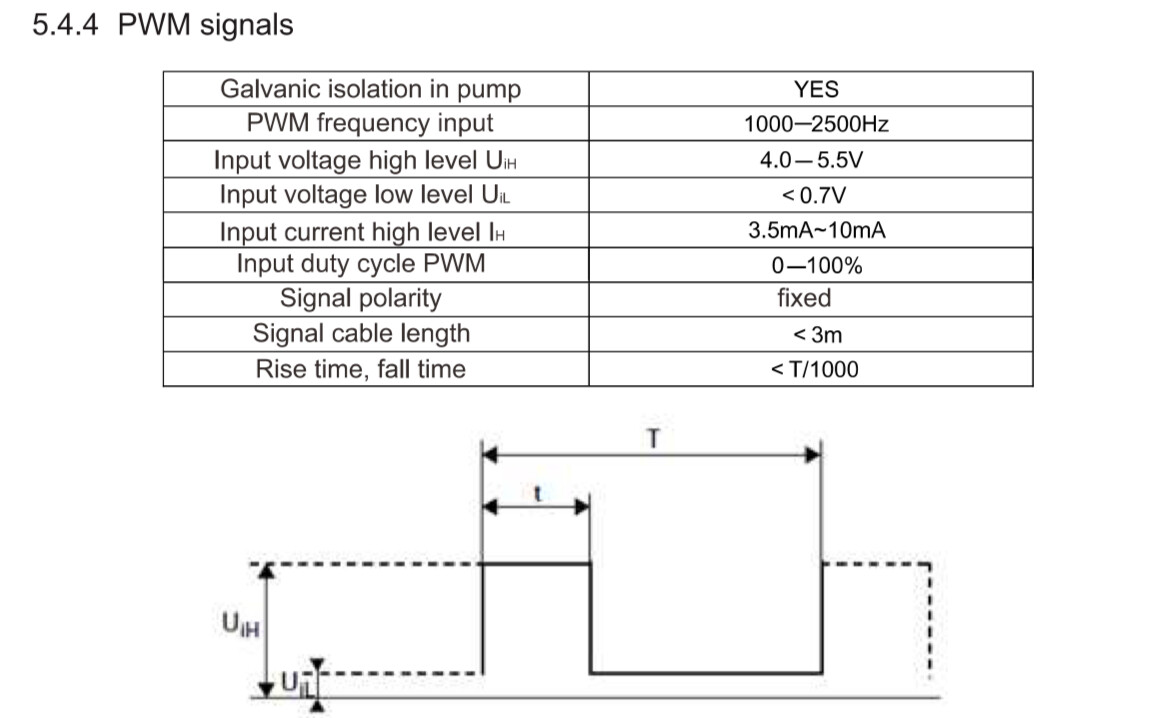

My pumps are driven via the FTC controller - I have a Low Loss Header (though don’t think I need it!), so there are two pumps. As installed, the pumps were not being speed controlled from the FTC. I have added an PWM control cable (there is terminal block in the FTC controller) and connected this to the primary pump. As John said there is no dynamic control of the pump, but I wanted to set a different speed for DHW and heating as I think the pump is running too fast when heating (becuase of the LLH) but if I set the speed down then it struggles with the DHW circuit (probably becuase I have an undersized coil). As others have observed there are settings to do this from the controller. However, I’m unconvinced it actually works as there’s no obervable change in flow rate with different settings in the controller. I’m planning to stick an oscilloscope on the output, but it’s one of those things I’ve not got round to yet!

How did you identify the plug to use for the terminal block or did you just solder straight to the pins or something else?
I guessed - it took 2 goes! :grinning:.
The ones I have aren’t quite right, but they do fit and make contact. I’m away at the moment but will try to dig out the type when I’m home. However, I’m unconvinced that the PWM output on the FPC controller actually does anything!
R

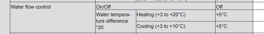

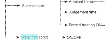

It is indeed a fixed speed, though the manual for FTC6 mentions something called “Water flow control” under Operational settings. I’m not brave enough to try it…

In what it looks like the future iteration of FTC(FTC7??) it appears that there’s even a setting for a range of temperature difference. So is this setting that everyone has it off by default, the setting that allows the system to manage the flow to achieve a certain dT? As of now everyone says that this doesn’t happen with Ecodan.
https://library.mitsubishielectric.co.uk/pdf/book/Ecodan_EHPT20X-MEHEW_Service_Manual_OCH814A#page-102-103

https://library.mitsubishielectric.co.uk/pdf/book/Ecodan_FTC7_PAC-IF08_1-3_B-E_Installation_Manual_DG79H200H01#page-34-35
@Rachel Did you concluded if the flowrate is fixed? I am interested to monitor the energy and if it’s not fixed I would like to do the same as you did and measure it. If it’s fixed, it probably not worth the risk
@pcman I’ve concluded that either the PWM output from the Ecodan isn’t compatible with Grundfos pumps or that it doesn’t work at all. I could probably have checked that with an oscilliscope, but in the end I also wanted to try flow matching the primary and secondary loops, so I built an Arduino controller which I’ve just fitted as per the other thread.

PWM works fine on my FTC5 with a UPM2 (25-50?). All pump outputs are just relay switched mains, there is a 3 pin connector on the right side of the PCB for PWM and pump feedback (CNPWM).
No advanced controls though, only 1-5 speed setting.
