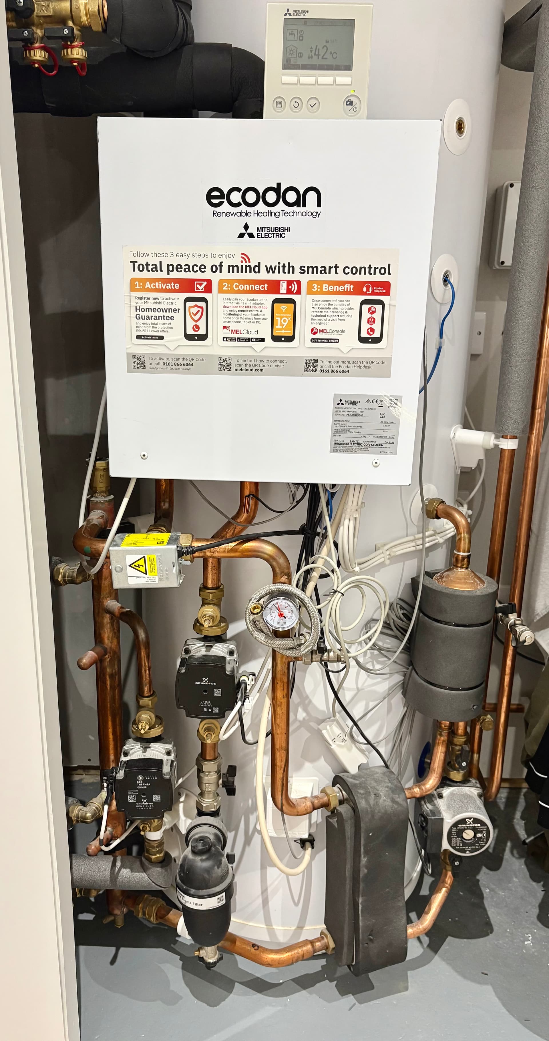

  • With multiple secondary circulation pumps you’d typically have a buffer tank or low-loss-header to provide ‘hydraulic separation’ between the circuits. If you don’t have a buffer, how are the pipes for the underfloor and radiator circuits connected to the flow and return from the heat pump? Are they just connected via tee fittings?
    I’ve attached a picture of my setup. Main pump in the middle, radiator circulation below it. Ufh pump is hidden behind the wall on the left. I assume that’s a low loss header at the bottom of the setup?
It looks like you have a “simple” 2 zone design, where you run a single flow temperature in both zones (You are set to fixed flow of 42C by the looks of your controller)
There is a sort of LLH, the circulation pumps for Zone 1 or Zone 2 will cut in & out as there is demand for the zone but i find it’s not perfect.
You set the flow temperature for Zone 1 (not sure if this is your UFH or Rads)
In a complex 2 zone, you have a mixing tank and mixing valve which would provide the two zones to operate at independent flow temperatures.
Yeah, that sounds right. I just set the only flow temp and it is the same for both zones. Zone one being radiators.
I had it on WC before but changed it to fixed flow for now so I can get heat to the radiators without it cutting off. 42 seems to be the lowest temp where the rads can dissipate the heat.
The tall fat vertical pipe on the far left is the LLH. The topmost and bottommost connections is the primary flow from and to the heat pump (except when heating hot water), and the two smaller connections at the top go to the two central heating circuits via the pump left of the primary pump, with a second pump behind the wall.
Gubbings to the right is for hot water.
Thanks for the photo Donald; that’s useful.
I agree with Tim that’s a Low-Loss Header on the left of the photo, connected as he explained. That will provide a degree of ‘hydraulic separation’ and let each of the circulation pumps do its own thing (which is good).
So presumably that’s a plate heat exchanger at the bottom, to the left of a fourth circulation pump on the DHW circuit (not related to your original question but I’m just curious).
Yup, that’s correct. This is standard arrangement of the pre-plumbed cylinder for Ecodan.

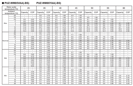

I was talking to the installers. They’re thinking of switching out the 11.2kw unit for an 8.5kw and keeping the two zones separate. One ufh and one rads. Does anyone know be minimum output of the 8.5 model? My only worry would be if there’s enough output for the coldest of days.

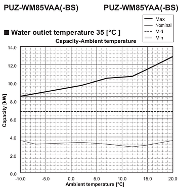

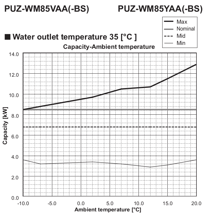

Here’s the output charts from the Ecodan ATW Databook for R32 models:
This shows the minimum to be around 3.5 kW, but it can reach or exceed 8.5 kW at all temperatures. For comparison, your current unit can do between 4 and 12 kW.
Here’s that same data in table form for a range of flow temperatures:
(Gray highlighted data means integrated data including defrost operation)
Thanks Tim. Looks like the minimum output would be low enough for my radiators to cope with then.
