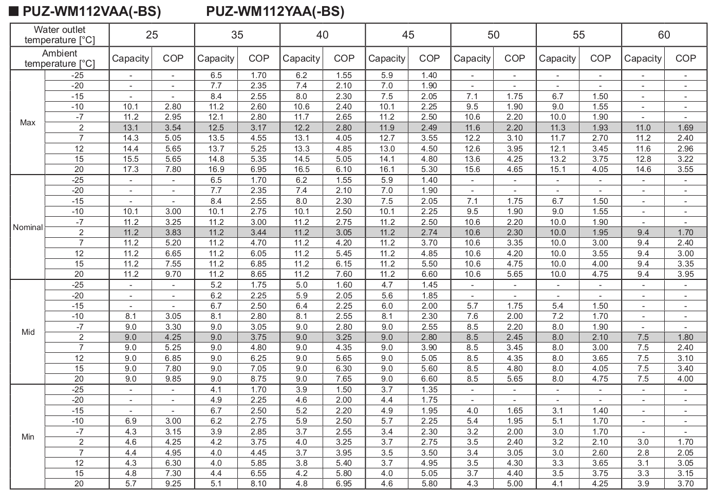

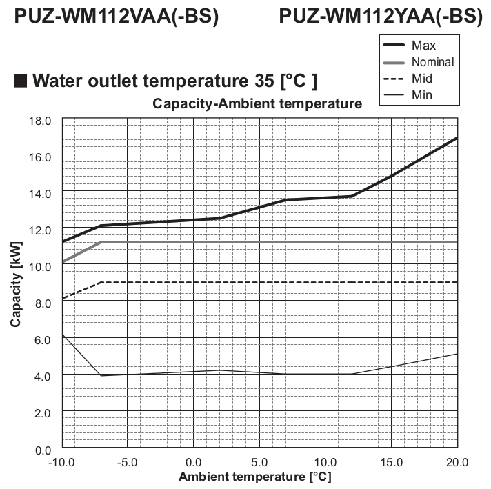

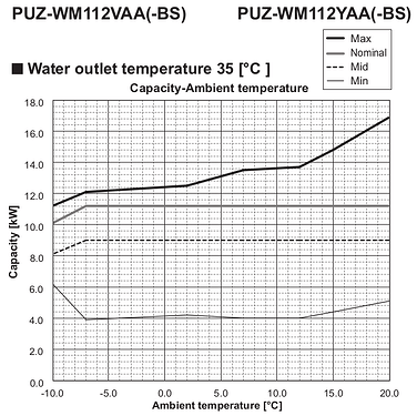

Here is the same chart and table for the 11.2 kW R32 model:
I have this model too, and it’s also oversized for my property, so I’m interested to see how a smaller unit works for you.

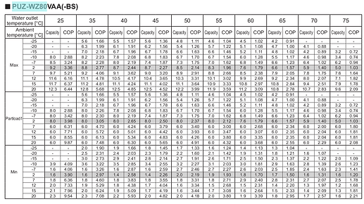

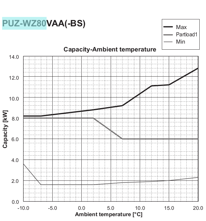

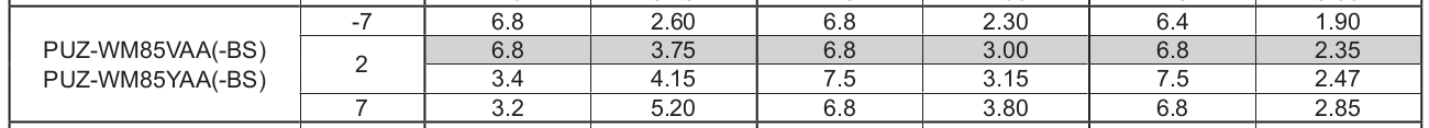

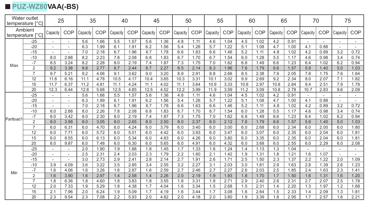

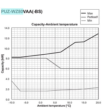

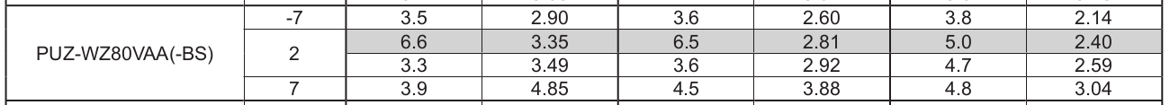

For completeness, Mitsubishi do have a newer 8kW model that has R290 refrigerant, which supersedes R32.
Here’s a comparison of “best COP” between the two units (R32 top, R290 bottom):
