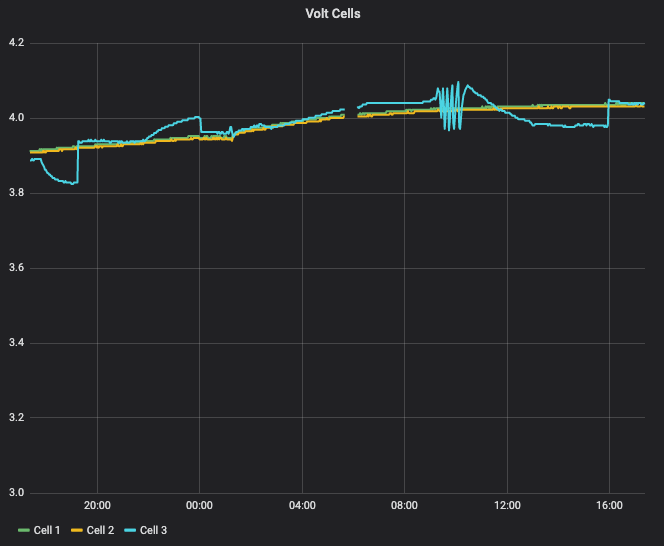

I have a funny guy here in my 3s80p battery. Module3 is playing funny jokes⌠

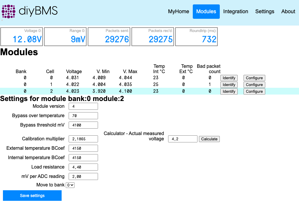

First I thought, my battery getting weak and the cells have problems to balance. But then I realized, that the actual voltage of all three packs are at the same level. Ok, so I typed the voltage into the field âActual measured voltageâ hit enter. The value at âCalibration multiplierâ changed and I hit âSaveâ. So far so good. All three modules shows the accurate volt values. But after about 5 hours module3 randomly changed its values. The Grafana chart shows that module1 and module2 are more or less stable and module3 plays some funny games. I measured pack3 and adjusted the value several times, but a few hours later module3 got out of control.

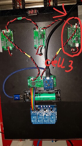

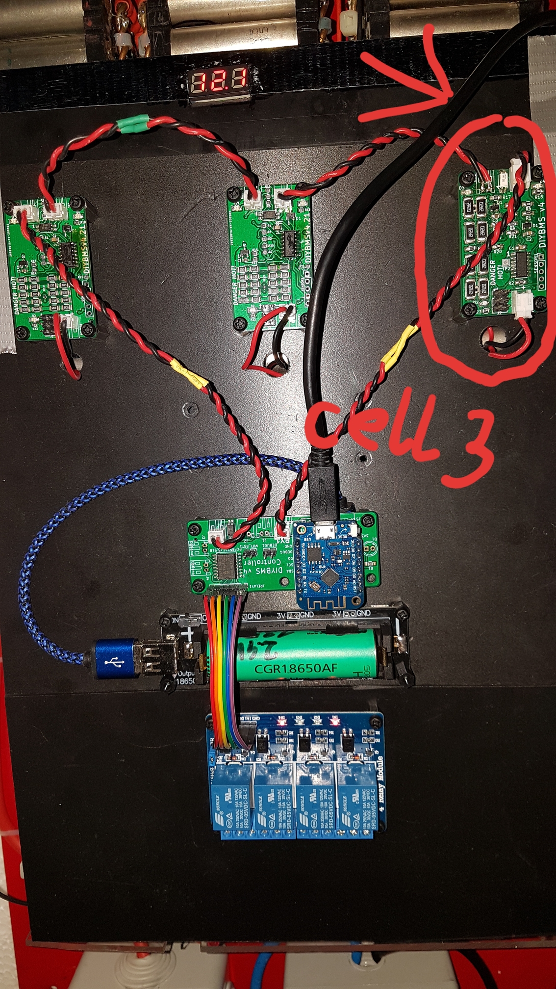

The photo shows, that module3 is the one, which I soldered by myself. Module1+2 are ready assembled. Maybe a loose connection, which causes the instable measurements? Or is this a known issue and there is a simple solution? Or am I doing something wrong?
