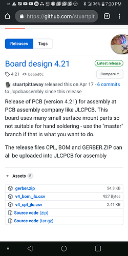

Hey guys I’m about to dive in to the diybms. I want to order about 40 or 50 boards from job PCB. If I use the included BOM how many boards will that make?
Hi Jon
the BOM thats included in stuarts Github is all the parts for 1 unit either BMS or Controler, depending on what you upload to JLCPCB.
so if you want say 50 BMS units then just upload the
Gerber
cpl
and bom files and make the quantity 50.
they will all be built from the same files.
Use the jlcpcb branch in GitHub and you can order exactly what you want almost fully assembled

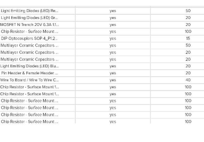

Hey guys thanks for the quick response. But there is no way that BOM I uploaded to LCSC was for one unit. The price came out to $40 and for all the items there is a large quantity… I used the file v4_bom_jlc.csv
Screenshot
Download the zip. Git clone won’t get you the right files. For your boards, one controller per however many circuits you want. I’ll be doing 5 controllers, 30 circuits. That’ll give me four 7s units with a couple spare controllers and circuits.
How exactly? I’m familiar with GitHub but for some reason I have a hard time navigating through and finding info on the diybms project…
Here’s a Screenshot where I downloaded the gerber and BOM. There is no download or clone…
