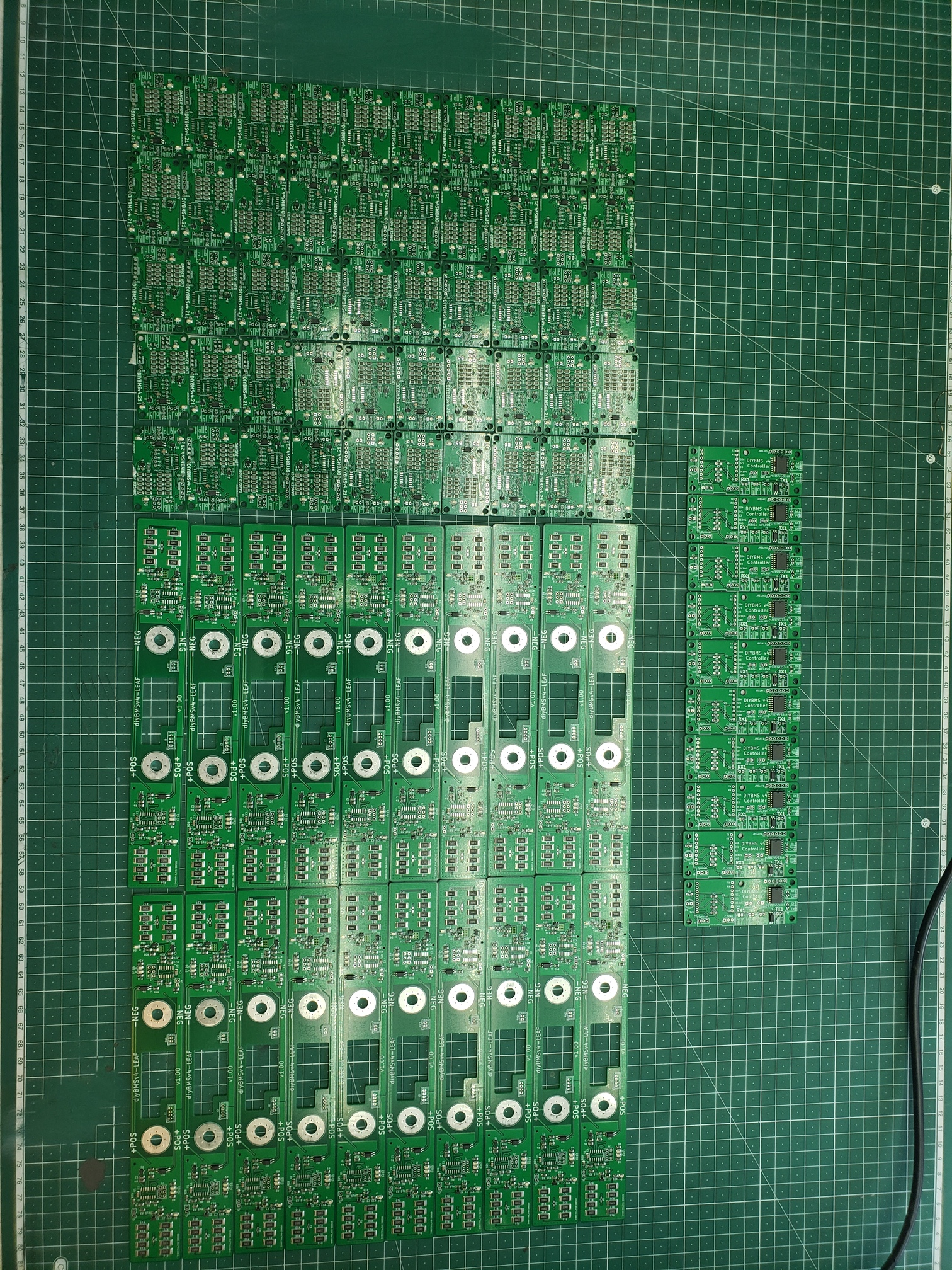

Arrive past week. Have a lot solder )

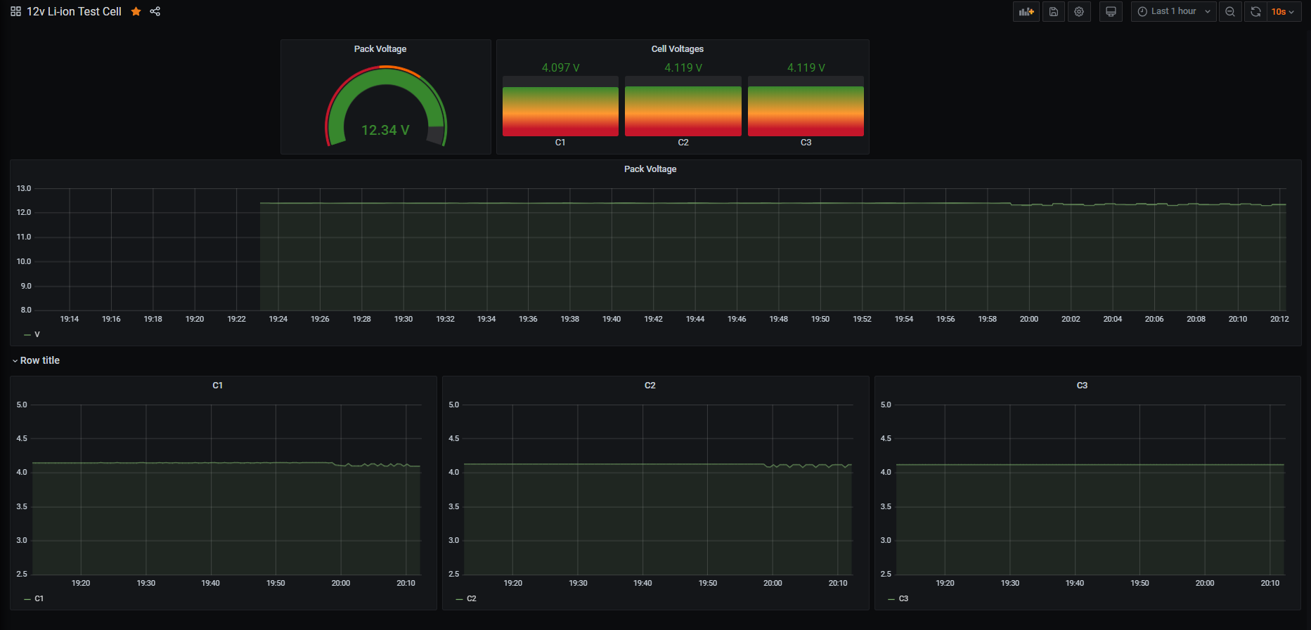

This is a screenshot of a 3S13P pack i put together today. I have the cell voltages set to 4.12. As you can see both cell 1 and 2 are burning off load to balance the pack.

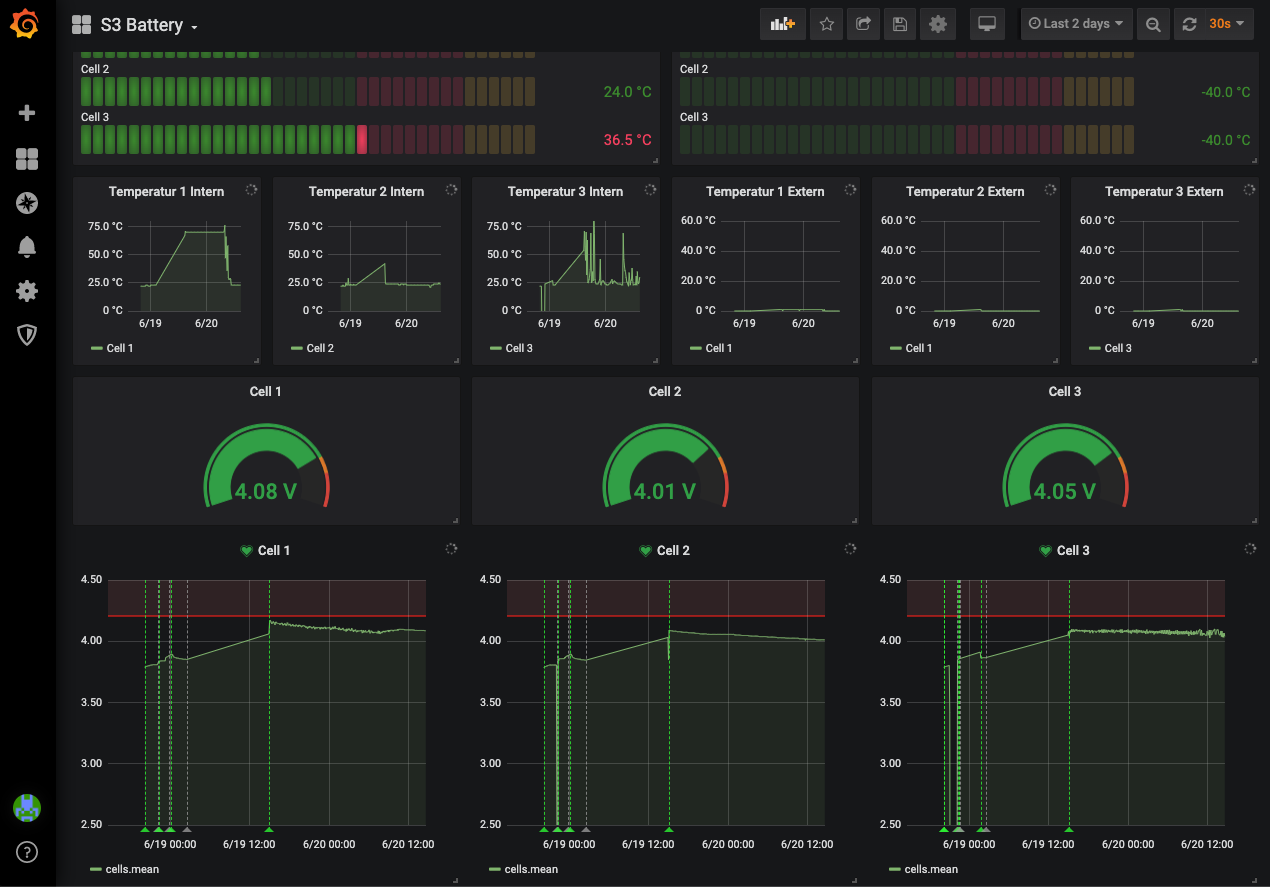

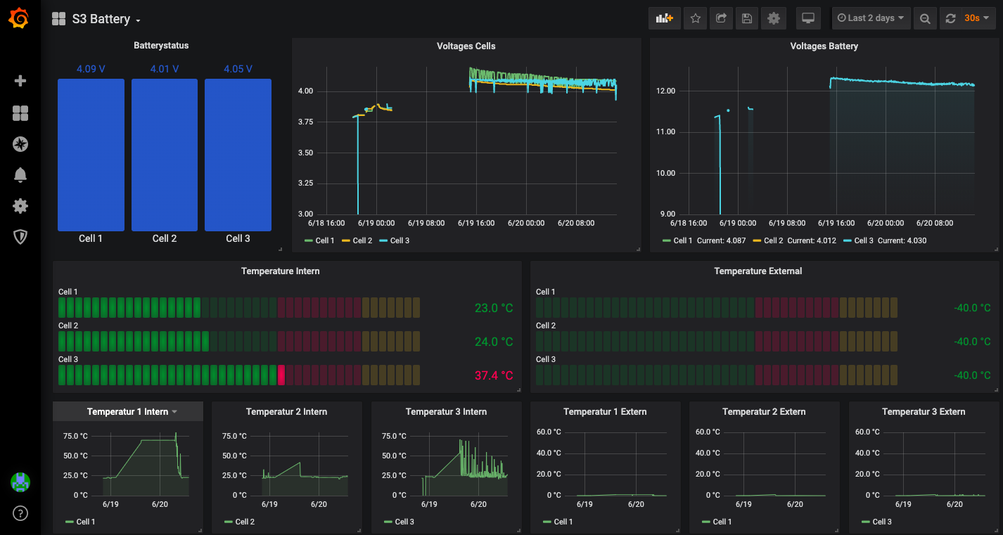

This is the first part of my 3s80p Battery, which was running the pump of a swimmingpool for the last year. Now I can see, that cell2 is degrading more than the other cells. Cell1 and cell3 are alternately try to ballance. Nice to see it working…
And I am still waiting for the external termperatur sensors from China.
Also I have set alerts to 4.1V for every cell. I get a message to my Telegram Messenger, everytime a cell is over 4.1V.
