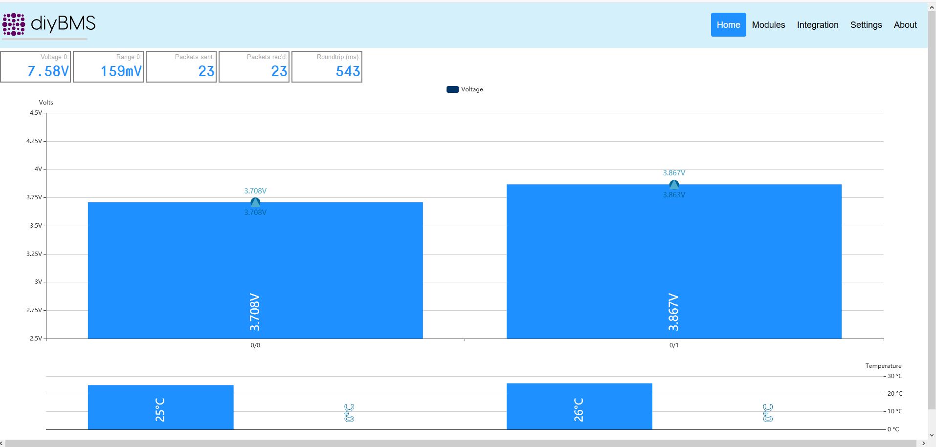

One question though, on all my modules; when I connect them for the first time (to single cells); the modules enter by pass mode for a complete cycle or two. The voltage is under 4.1v for each cell. Is this normal? After a cycle or two, the modules will exit by pass mode and function normally.

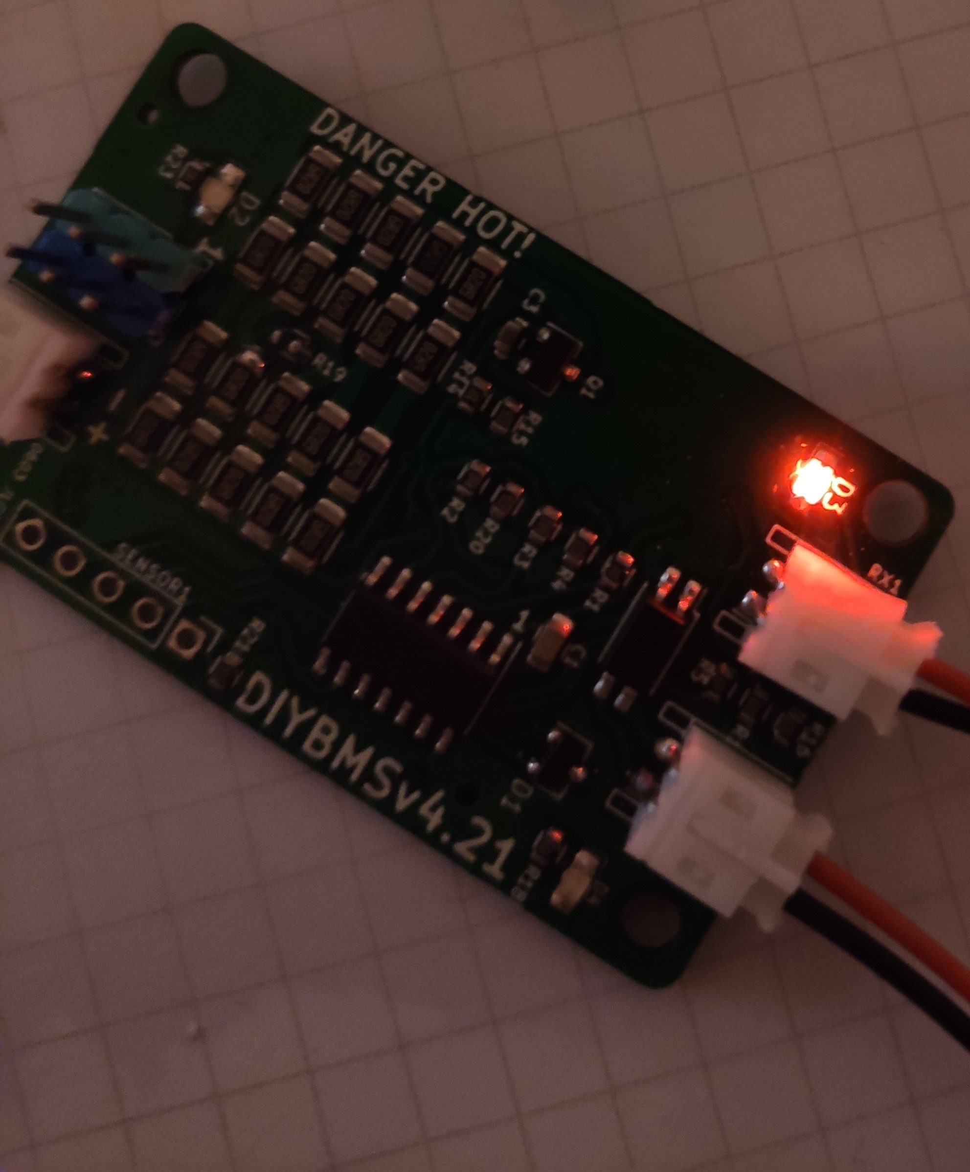

Hi,
I have a little problem with the boards.
When I connect the battery to the board, D2 and D4 light up briefly. After a few seconds, D3 starts to flicker red and discharges the battery and the resistors become hot.
D1 is an (AZ432ANTR-E1) and R19 is an (NCP18WB473J03RB SMD). I soldered the two myself, the rest is from JLC. Are these the wrong components?

What firmware were you using for this module, the “releases” version or directly from PlatformIO.
The board shouldn’t get this hot. Is this a V4.21 module ?

What voltage are the cells at?
I wouldn’t say that is normal, might be worth checking the bypass voltage is set as you expect. Click the “global settings” button in Modules to save a default.

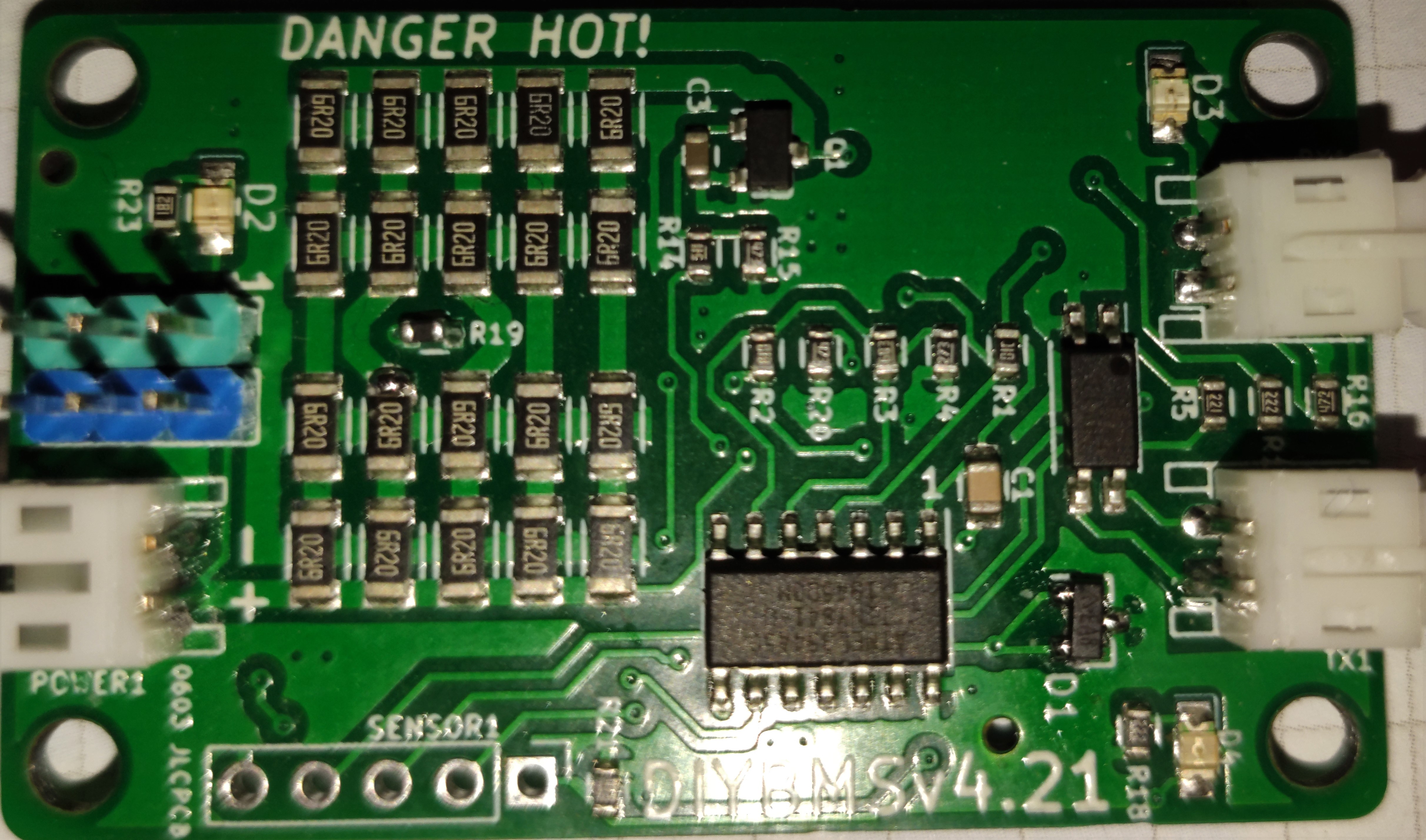

Well i now have all the components and successfully flashed a few modules and a controller for a test setup.
I have the V4.21 boards assembled by JLPCB (except the attiny) Is there a specific branch i should flash to the 4.21 board? I flashed the cell modules in the ‘General’ branch and everything works except the resistors get extremely hot.
The resistor will get hot 65 to 70 degrees.
Thanks Stuart. Do i just flash the cell module with the general branch? i noticed in the fix swapped R1920 branch there is an option to build using attiny841_V421

Yes it is v4.21. I did not measure the temperature but the plastic was probably PVC, which softening point is about 75C.
Yes use the master branch

the error was the too high voltage. It was at 4.15 volts. In addition, I had no connection from the controller to the boards. I reloaded the program on the controller and then it worked. Thanks for your great project!

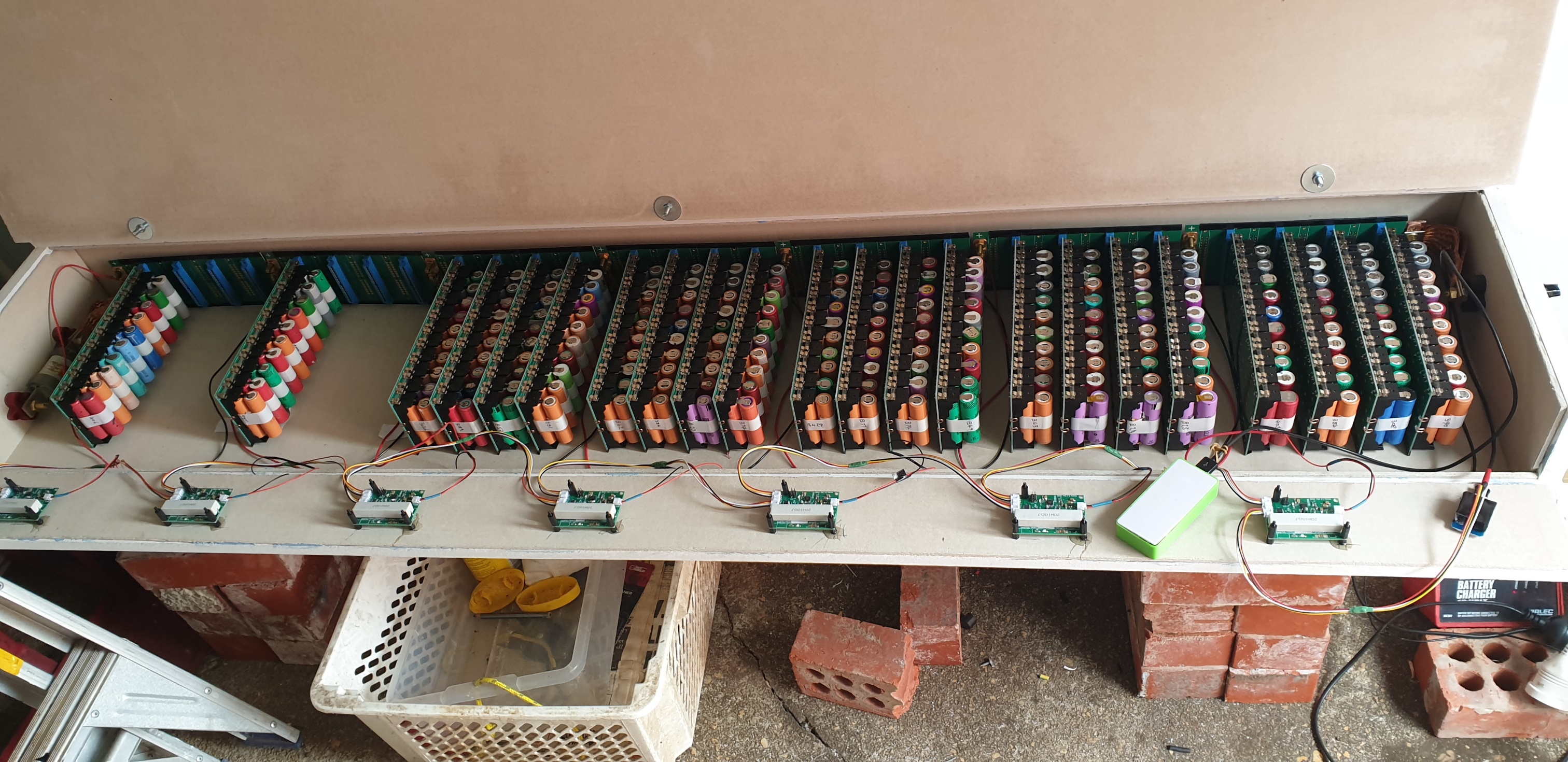

Nice , see you doubled up on the cells what sort of capacity/ runtime you getting and are you still using only 5 amp fuses?

I had JLPCB make the PCB’s and install surface mount components (except for the attiny) I then hand soldered the attiny in place thanks to the help of some very useful YouTube videos. I flashed both the cells and the controller without a hitch once again following some helpful YouTube tutorials.
I now have the BMS running on a 3S4P test pack and it is behaving exactly as expected. The BMS integrated with influxdb with ease and I am now producing some nice graphs to compliment the diyBMS web interface.
