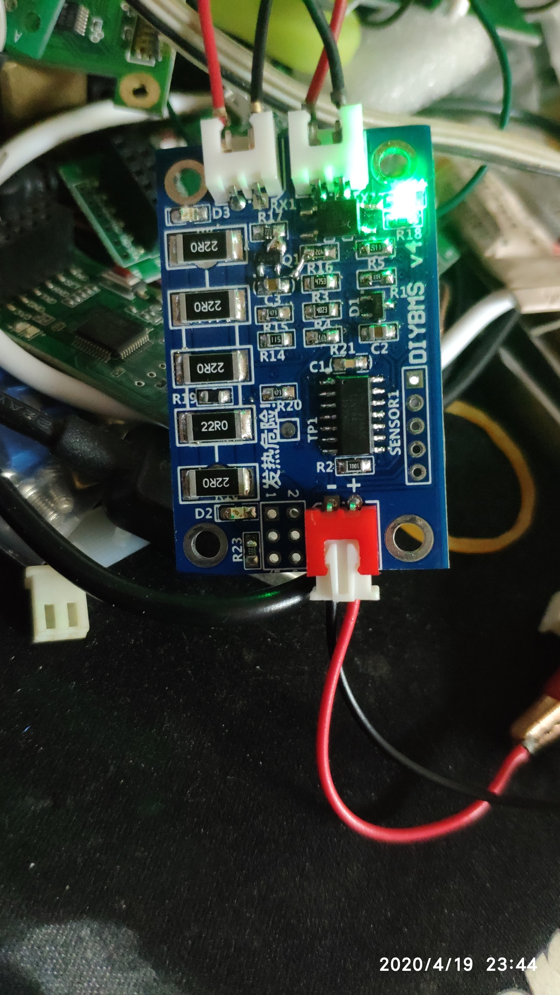

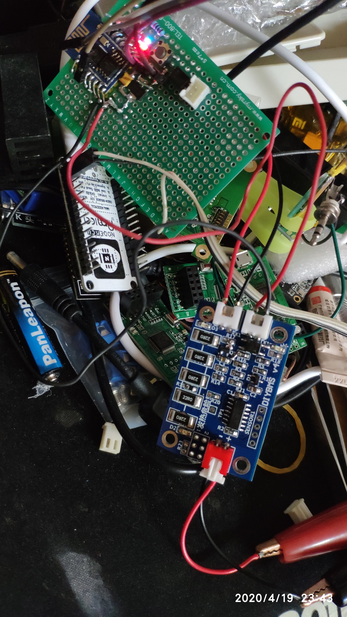

I modified the PCB structure to fit my parts!

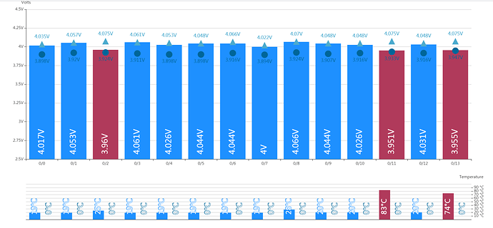

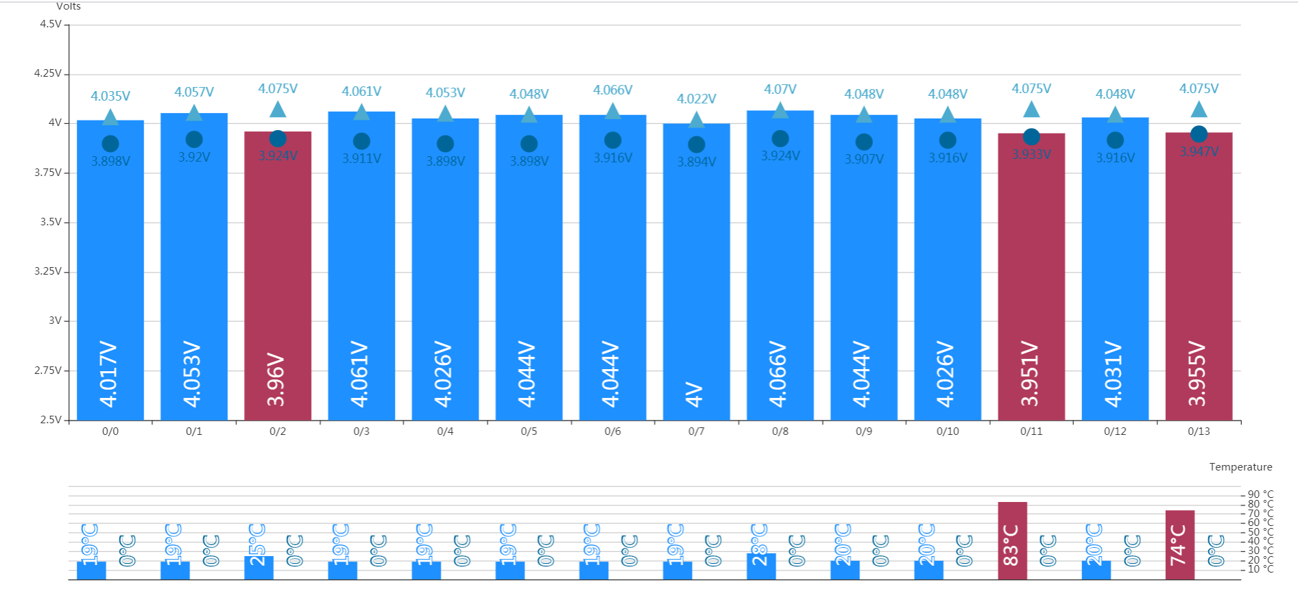

Running a balance at the moment and I’ve got the bypass temperature limit set to 45 (because mine has the resister/thermister backwards issue). So how come the temperature of the boards is reading 70 to 80 degrees? I’ve double checked the setting and it’s definitely set to 45.
Also: what is the difference between a solid red light and a rapidly flickering red light?
Glad you got it working - why did you swap to 5x 22 ohm resistors?
How will those handle the power and heat ?

There is 22R resistance in my parts library. I changed the resistance into parallel connection. The total resistance value has not changed. In 4R4.
The program has not been modified!
