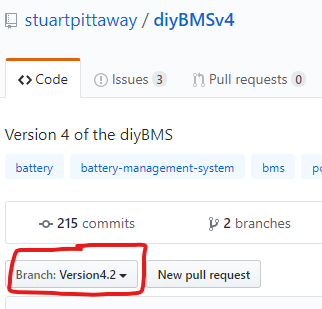

In GitHub, look at the branches v4.2

https://github.com/stuartpittaway/diyBMSv4/tree/Version4.2
I think what you are missing is that 4.2 is a branch of the repository. In GitHub look for this;

They are the same circuit. 4.21 is optimised for building at jlcpcb, it’s also cheaper.
4.21 works well files for this are here, note this design is NOT suitable for handsoldering:
[Release 4.21 Ā· stuartpittaway/diyBMSv4 Ā· GitHub]
[https://github.com/stuartpittaway/diyBMSv4/tree/jlcpcbassembly]
v4.0 is basically the same design, but is suitable for hand soldering.
[GitHub - stuartpittaway/diyBMSv4: Version 4 of the diyBMS]
Version 4.3 won’t make it out into the world as it currently stands (there are faults in the design) and its not fundamentally different from the above, it uses the same code.
