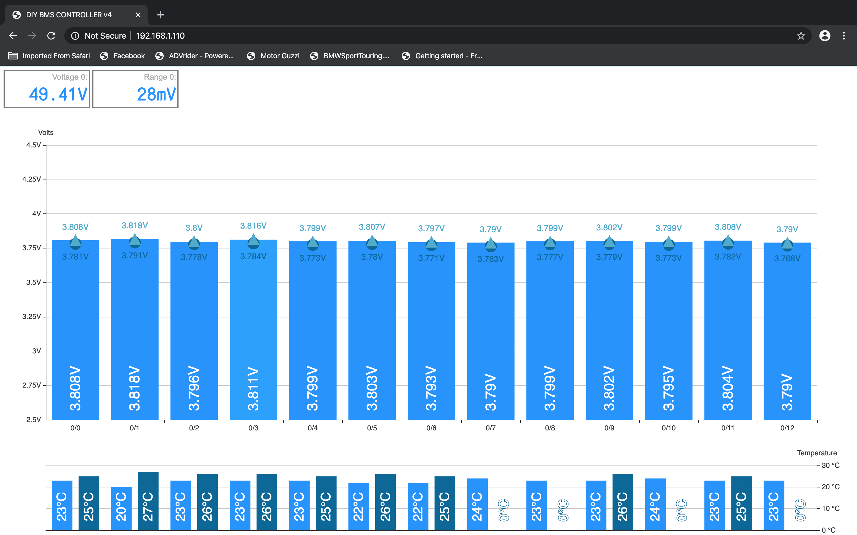

My scenario: charging at 40 amps on PV, and building external temp sensors (about 5" long). Looks like I can only put one every other cell before the comm error starts again. Could this be a timing issue when adding the external temp sensors?
If I just connect the external temp, seems to be okay, when I push into the battery pack (some pressure on thermistor), comm error.
Comm error again, removed external at pos #0, seems normal now. I have only 5 connected.
Disconnected all externals, waiting for comm error.
Well, looks like I have a comm error without the temp sensors.

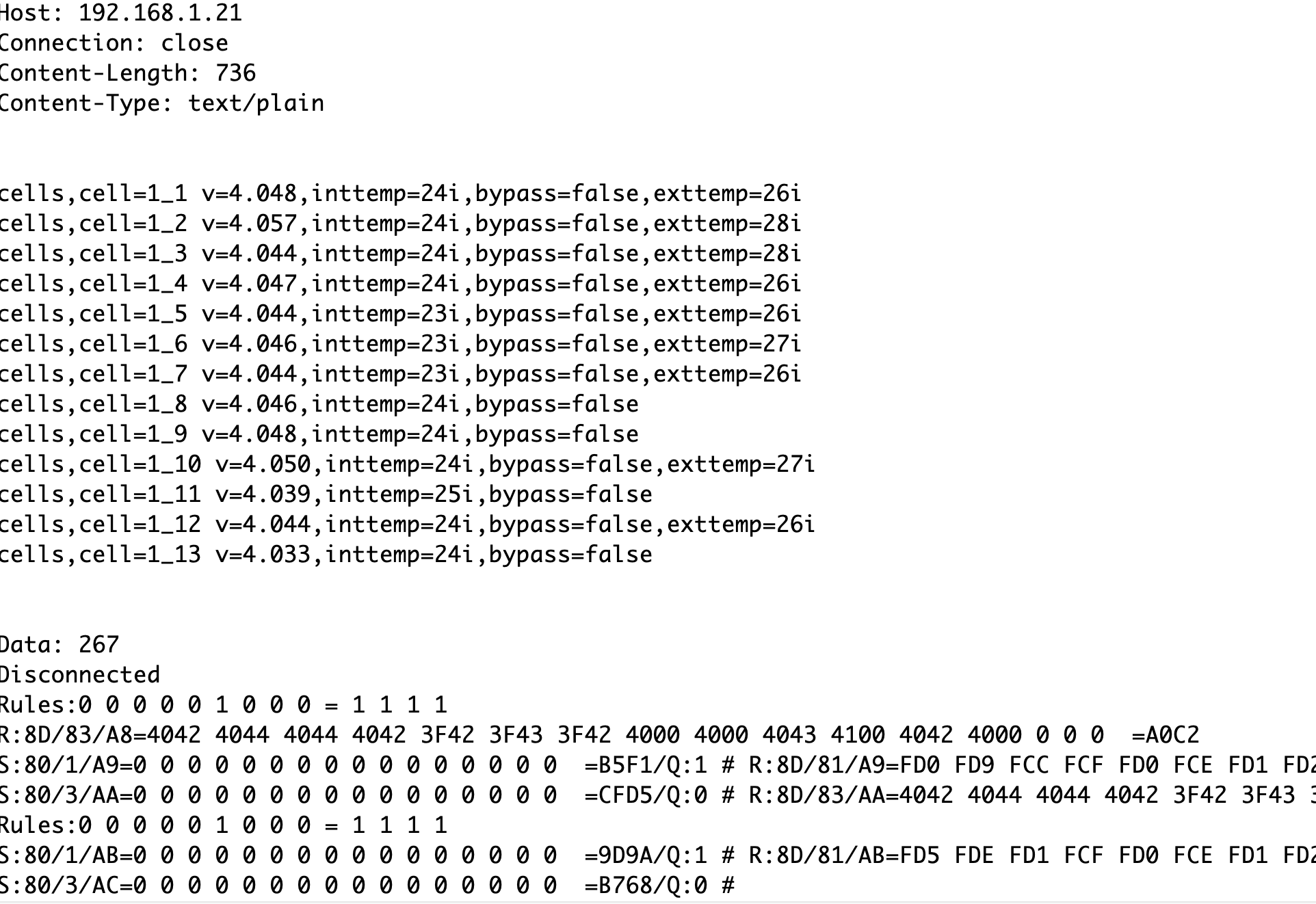

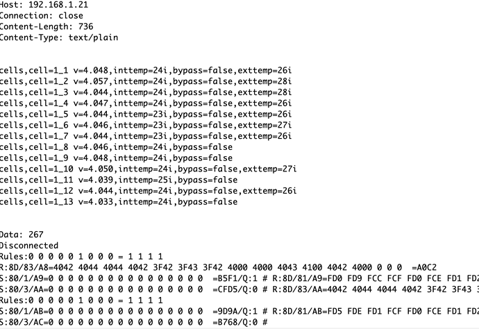

Sounds like this could be a coding issue to me. Do you have the ability to get the debug serial port logs?

UPDATE: All good, 9 external temps up immediately on connecting, now to build 5 more.

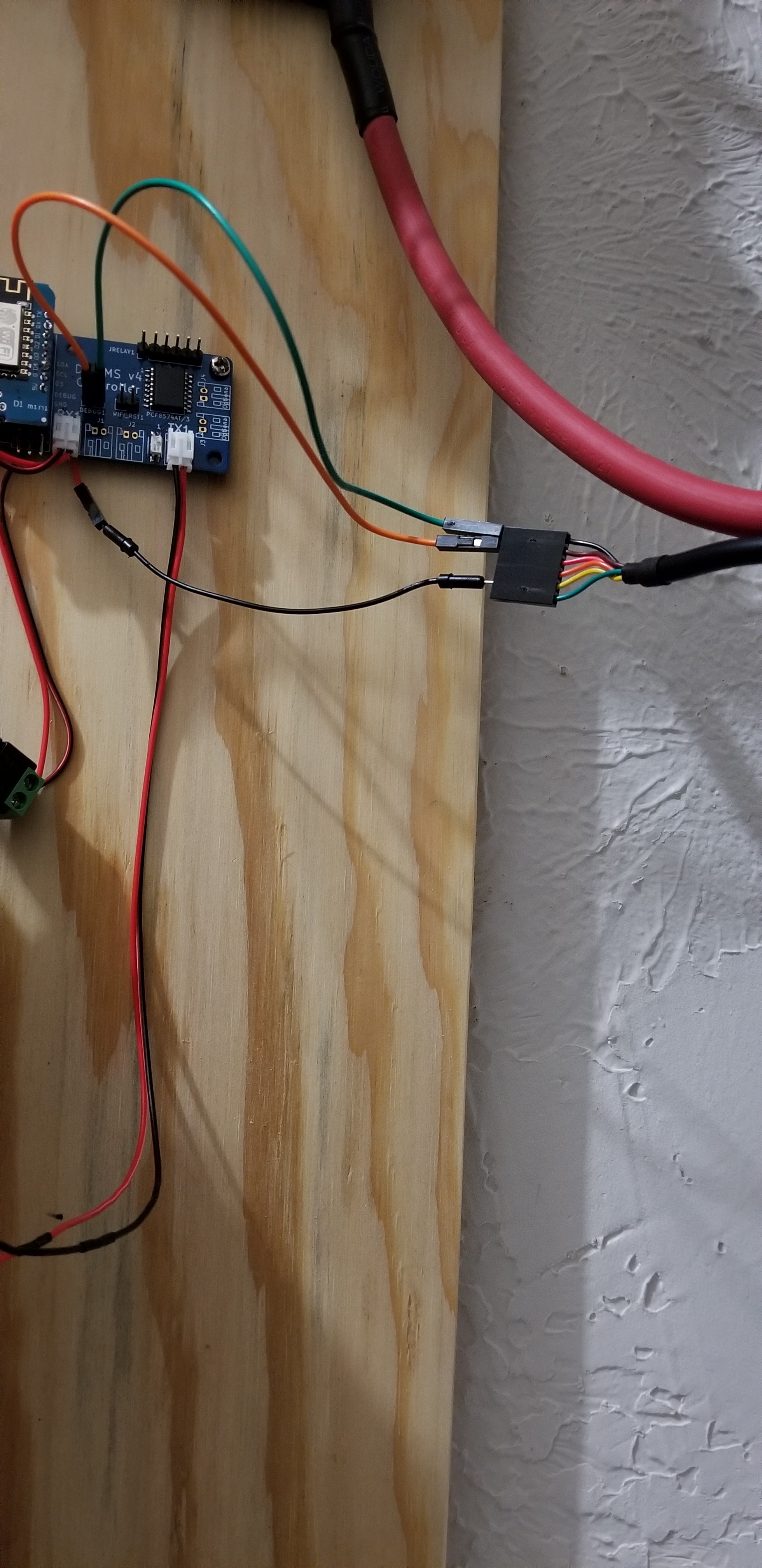

Hello @malabarmcgyver, I am using this for debugging:
I’m on a MacBook pro, I must connect USB port first then connect the wires at the Controller board. Green jumper is ground, Orange jumper is clear to send, Black is D4 on esp8266.

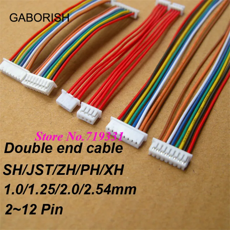

Is there a source for jumper wires that are good for these boards? I see a lot of red and black with only one side crimped. Any help is appreciated!
They are available online but often in lengths that are not ideal. The cables can be built without too much hassle using the crimp connectors though.
Or get the ones with wires connected, and a few mins with a soldering iron and heat shrink, and away you go.
There shouldn’t be any need for the clear to send cable - is this MacBook specific?
Normally connecting the 2 debug pins to ground and RX (receive) pin on the TTL breakout board should be enough.
Baudrate is 115200 baud (8N1)
I’ve used these, you will need to swap the pins on the cables, mine were cross over rather than straight through.
That is the pinout on the cable (cts) brown pin #2. Don’t think mac specific.
